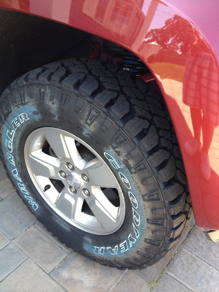

I think I'm going to just stick with the springs and shocks for the lift I think, and do you have any pictures of your lib straight on or straight from the back? Im not sure if I like the profile of the Dura's but there aren't that many pictures of them straight on while installed.

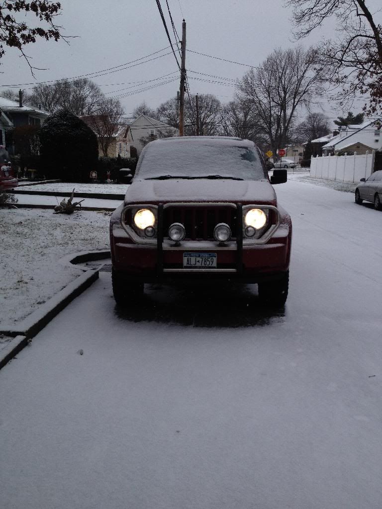

Something like this? Or would you like to see the tread design? I think I have a pic of the tread. I could always take more pics if you'd like.
Yea if you could post one of the tread design that would be awesome, I really appreciate the help :)
 Post subject: Re: Which tires & wheels to choose…(poll)
PostPosted: Wed Dec 18, 2013 10:39 am
As of right now, this is the best I have. I'll gladly snap a few pics later when I get back to the Jeep.
