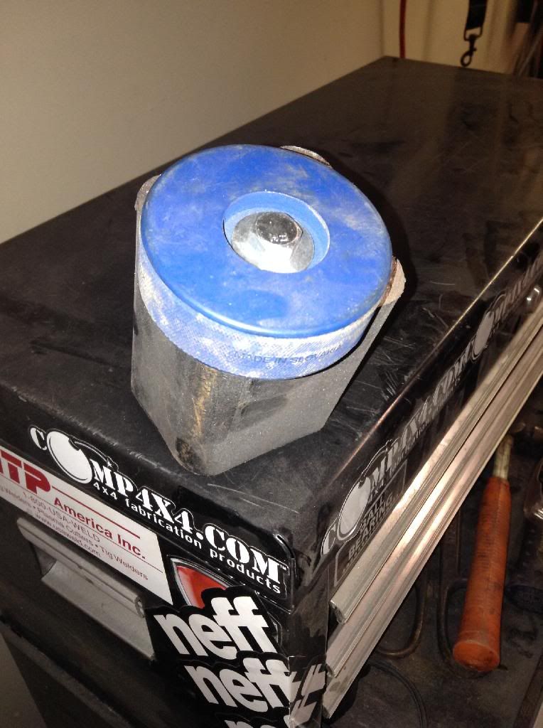

PostPosted: Tue Apr 01, 2014 12:58 am
Posts: 2172
Location: NEVADA
Here's a visual of what tjkj2002 is talking about. I think I used a 1.25" forstner bit. That solid plastic stuff he's talking about would be a cleaner install I wonder where you can get it.
