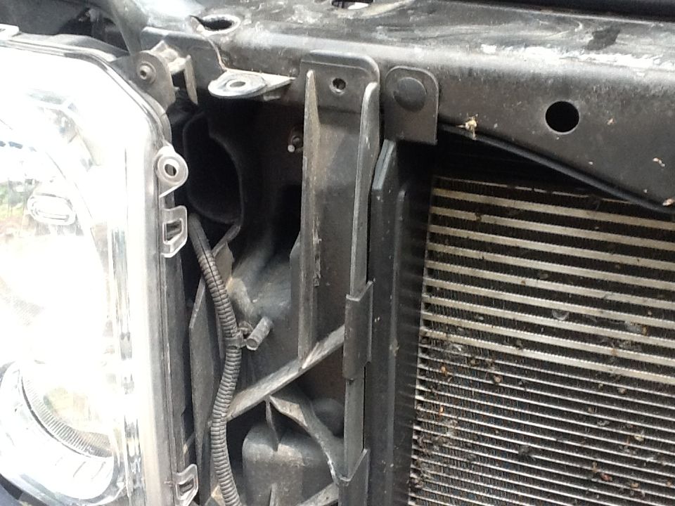

Troy, aren't the thicker horizontal sections on the top of the radiator the built in trans cooler? That's what I read somewhere on the forum, and why I thought the aux cooling fan would help keep the trans temp down as well as the engine temp.

I think that's the A/C condenser coil

Yeah, that makes sense. Oops!

The only trans cooler in a KK is a stand alone cooler that is the top few rows of the AC condenser.Any KJ with the 42RLE has a stand alone cooler in front of the AC condenser,KJ's with the 45RFE have a in-radiator trans cooler with a option of a added AUX cooler with HD cooling/tow package(in series with in-radiator cooler).
