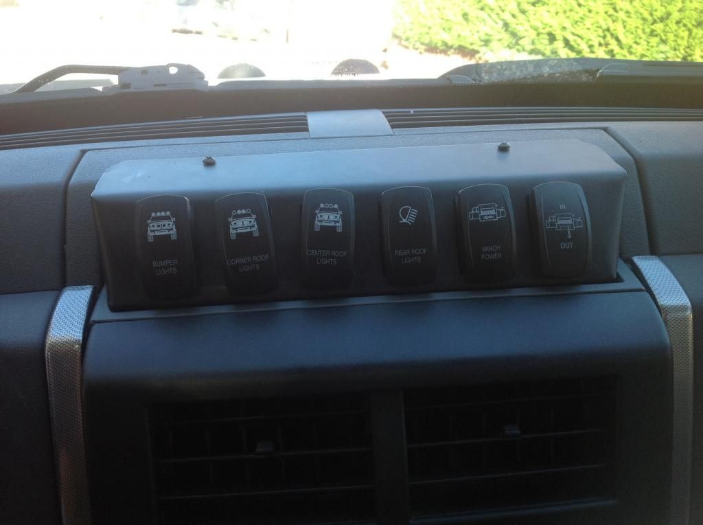

hey all i was wondering,
i know plenty of you have installed aftermarket switches for various things. what i was hoping you all could help me out on is wiring. are all your aftermarket things wired to the battery or fuze box or what? if they are to the battery, how do you keep things clean looking and from drawing to much power from the battery. i'm asking because im thinking about in stalling 3 to 5 switches for various things. thanks for the help.

Here is what I have:
The switches are crooked in that picture but I had AtTheHelm make me one that fit the switches much more snugly.
I ran all the cables myself and have integrated the dimmer switch as well so it also looks great at night. The power cables are run to the TIMP accessory relay so when I pull my keys out, the lights stay on for as long as the radio does (a few minutes) then turns off. It keeps me from accidentally running out the battery. I also wired up the Winch Power and Winch In/Out a few weeks ago, and I would be happy to answer any questions you may have.

Where did you get the switches from?
True Blue 2012 KK Sport: 245/70r16 Grabber AT2, 20% front tint, Vent visors, Air dam removed, ATH shackle tabs, ATH Roof rack, De-badged...
 Post subject: Re: rocker switches questions
PostPosted: Wed Aug 13, 2014 8:15 pm
Posts: 2172
Location: NEVADA
Those are from otrattw.com, they make custom etched Carling V rocker switches.
Thanks...also ATH didn't u make the switch housing?
PostPosted: Thu Aug 14, 2014 10:28 am
Posts: 2172
Location: NEVADA
Yeah I made a few of them. Those were all cut out by hand, and the holes had to be perfect or they sat crooked like above (replaced that one). Tried getting them cnc cut but gave up as my parts cutter doesn't really deal with thin gauge steel..

oh ok yea 2 bad someone cant make them out of plastic! Is a perfect spot for the switches
