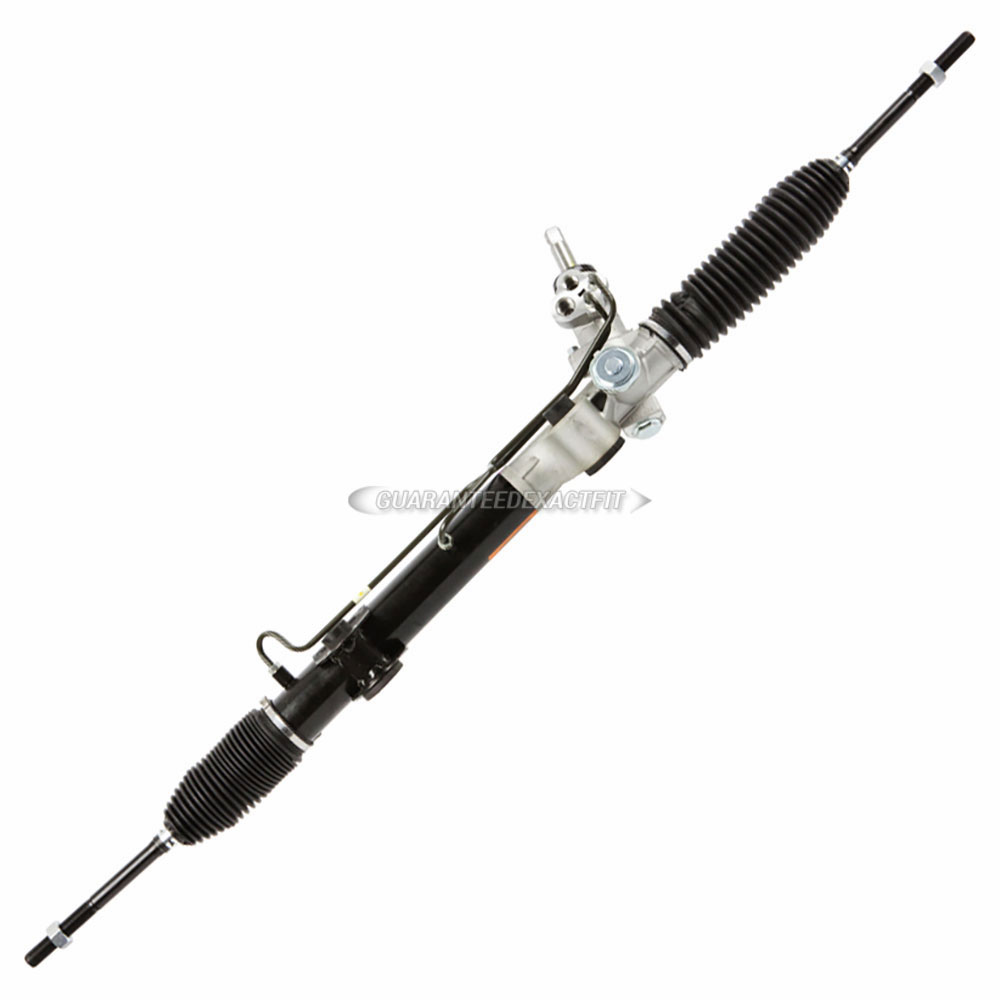

Ok, so I got the new line shipped out quickly. This concludes the good news....
Upon further review, it is correct that you need to remove the airbox, battery, the combined washer fluid / coolant reservoirs, and the fan shroud.
I took a bunch of pics which I'll update later. In short, the broken line wasn't the "power steering pressure line", but rather it was one of the metal lines that is considered part of the "steering rack".
In the pic above, you can see the entire rack. My bad hose is the one that goes to the passenger side - I figure I'll just replace both to be safe, along with the new pressure line that I already have. There is nothing wrong with the steering rack itself, nor do I have any desire to remove & replace it. The issue is, you can't order just the hose by itself, you need order the entire rack. This works out to $500 thru the dealer (ha!), or best case about $230 w/ a $50 core for a remanufactured unit.
Is there any other place that I could possibly source this part? It seems pretty wasteful to order the entire rack if I only need the lines.
Look for KA/KKs in the local junkyards. You might be able to get the rack for a lot less. If there is a core on that, just swap the lines over and take the junkyard part back with the bad line.

I was hoping for your sake it was not that tube.
Unfortunately, it is too common to have it rot out.
There was a KA owner with the same problem. He tried multiple times to "repair" the tube with splices and such, to no avail. He even works at a hydraulic pipe company. Which of course did not have the correct swedge/rotary die to allow him to make one. At a cost of $599.99 for a single use, his company would not go for it... :banghead: Too bad really, he could have made a bunch and sold them to folks like you and many more I'm sure.
Problem with a used one is that it may already be half rotted out, and a new one is still prone to rotting out. :dizzy: But when you look at it, a new rack with a new tube, should (active word is should) last longer.
