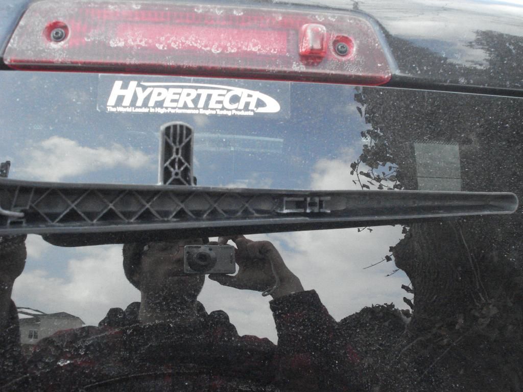

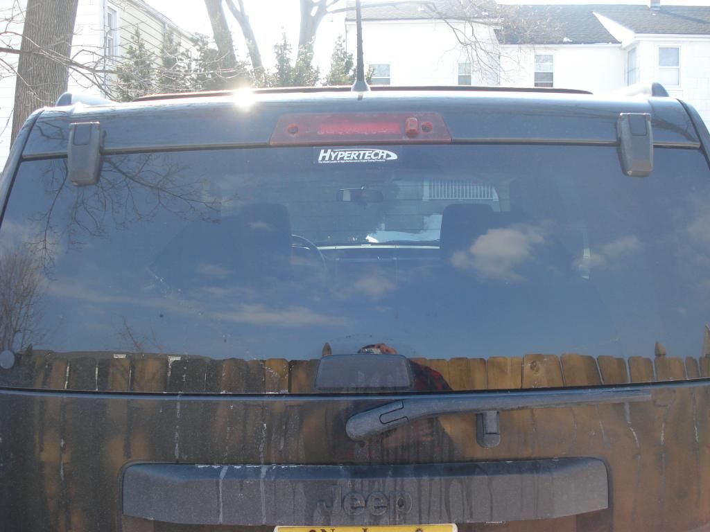

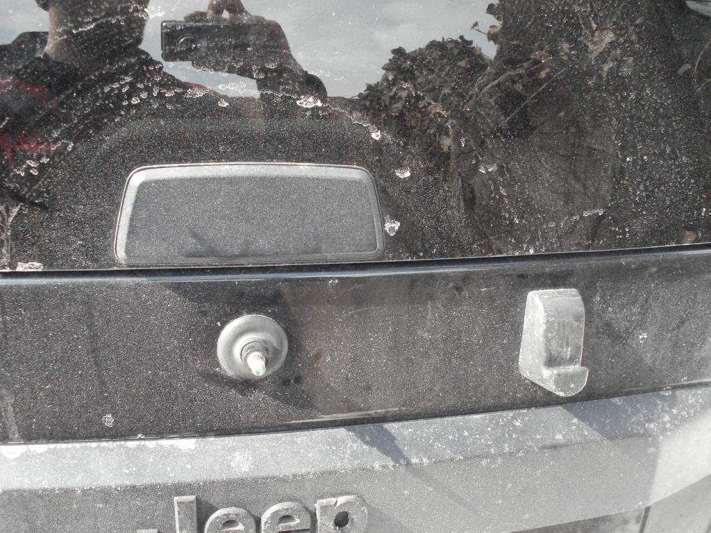

Purchase one rear 12 inch blade for less than $10.

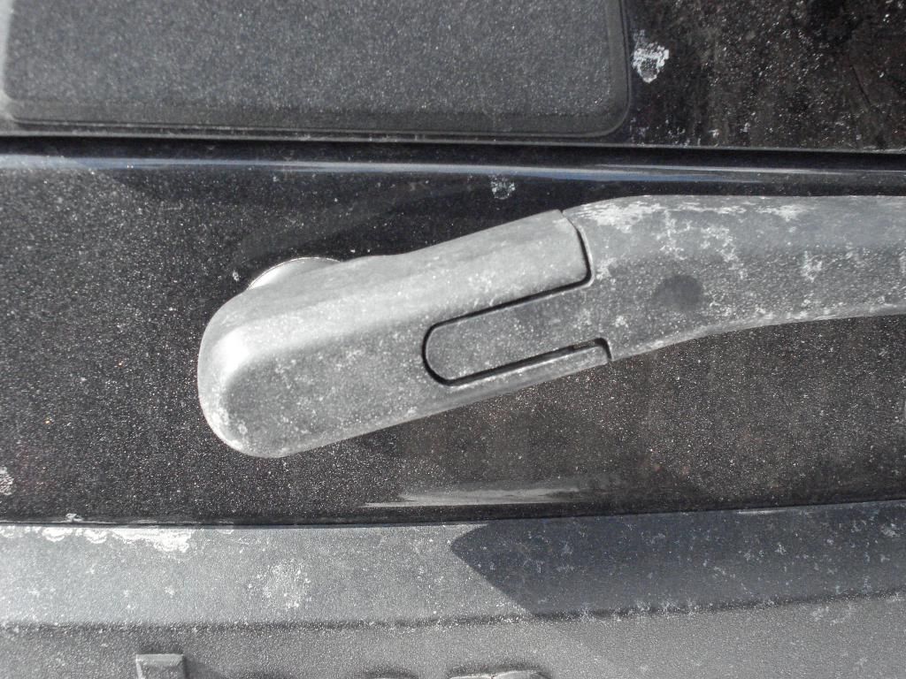

Remove cap on rear blade. Pull away from the Jeep.

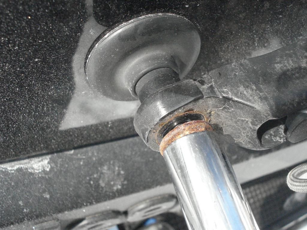

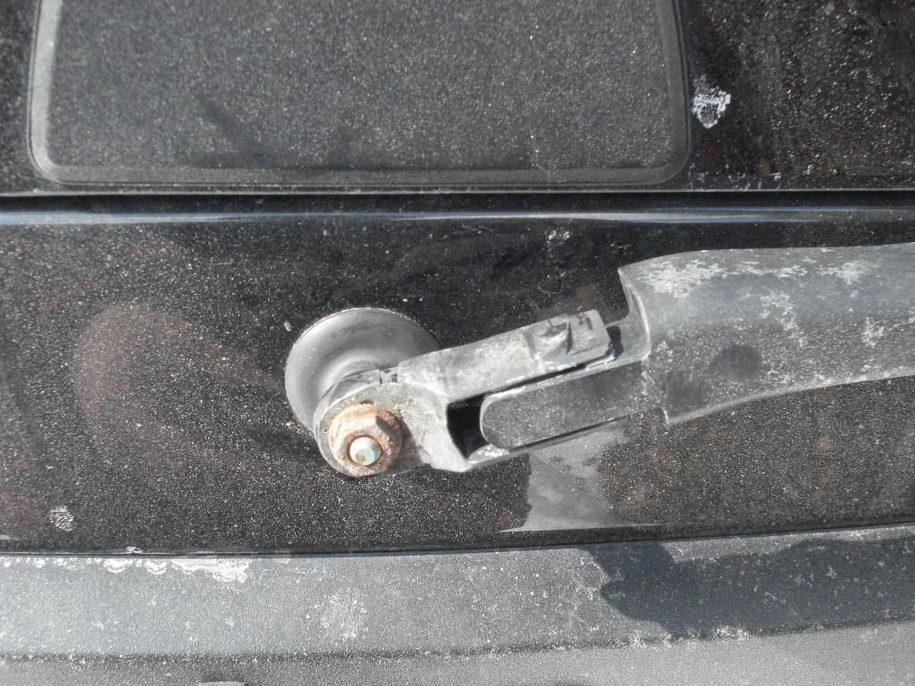

13mm socket.
Underneath the cover. The old blade pulls right out.

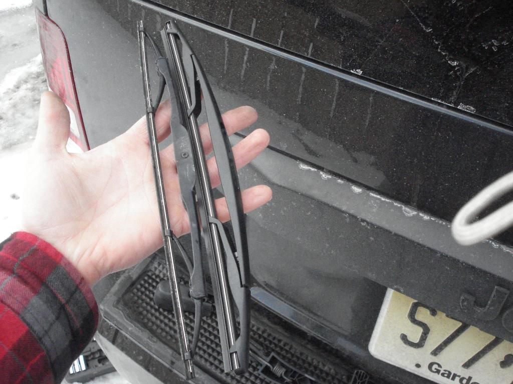

Compare the two.

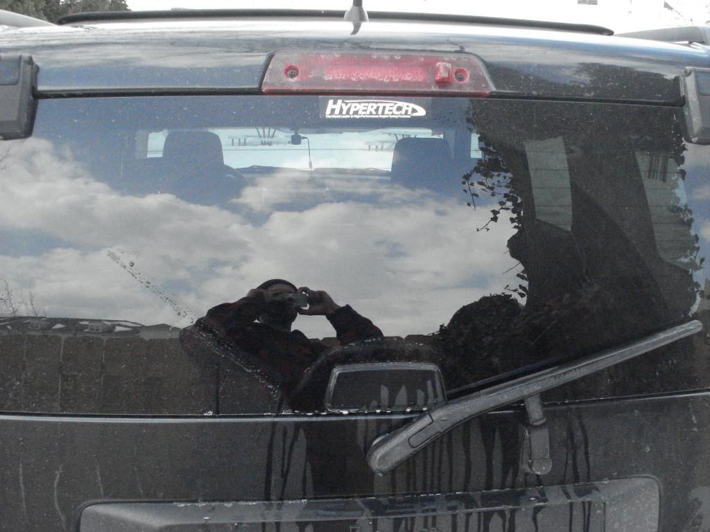

Install and check operation. The new blade pops right in there without much effort.
