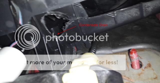

If that is not the case, it could be your A/C condensate drain is clogged.
If that turns out to be your situation, I now know where it is located now, because the A/C condensate drain was clogged in another KA owners rig (same HVAC as in the KK). He tore into his HVAC system, and posted Pics.
If you need the Pics just ask and I will point you in the right direction.

Rear sunroof drain lines
Front sunroof drain lines.
HVAC condensate drain location. Like I said he "He tore into his HVAC system". LOL But with the location known, a simple hole and a grommet would make it easy to clean out.
Setup: remove center console, location is right in front of the shifter where the HVAC housing meets the floor.
The outside of the drain is right above the trans if I remember. There was a recall on 4x2 models because the water would cause the back of the heat shield to lose adhesion and lay on the drive shaft, which would turn into a big lathe until the shaft broke.
