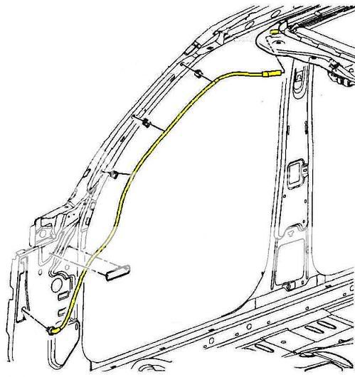

 Post subject: Re: Soaked carpet
PostPosted: Tue Jul 22, 2014 5:56 am
Posts: 1503
Location: S.W Washington
Rear sunroof drain lines
Front sunroof drain lines.
HVAC condensate drain location. Like I said he "He tore into his HVAC system". LOL But with the location known, a simple hole and a grommet would make it easy to clean out.
Setup: remove center console, location is right in front of the shifter where the HVAC housing meets the floor.
