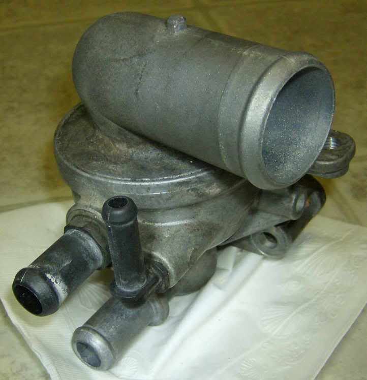

Which bottom port are you talking about? If you can show a picture I think I might be able to help.
Sorry, not the best picture, it is from an earlier post I made on this thread.
The bottom of the thermostat assembly has an aluminum hose fitting and 2 plastic hose fittings ("bottom port"). As the main thermostat opens, the bottom section closes?
Mark's first post on this thread has many better pictures.
Just not sure what each port feeds/does.

The very bottom port (aluminum fitting) is the by-pass port connected to the water-pump inlet. With the T-stat closed, the water travels through here to recirculate through the block. With the t-stat open, this port should have minimal flow with the majority of flow going to the radiator. I don't know the exact balance, but you should measure the amount of the port blocked and make sure it matches. If this isn't maintained (too much bypass with T-stat open), you'll overheat very easily when under heavy load in hot weather.
The large plastic port connects to the viscous heater, going then to the heater core. This shouldn't be an issue. The small port is the de-gas flow (constant air bleed), you'll want to make sure this stays the same as before.

The viscous heater (large plastic) port seems to enter the mid chamber. If the small plastic degas port does the same, they both should be a non-issue.
If Mark's thermostat only opens 3mm (as opposed to stock 10mm) and the upper valve does produce enough flow to cool the engine, can we assume the lower valve also allows enough flow?
As for balance between the two, if Mark's seals off the bypass completely, does it really matter since the thermostat is regulating anyway?
How do we know if the bypass (having less opening) is not over taxing the pump?

FYI - Kap had a lot of pictures on page 1 - this seems to show the 3 output fittings
so if I understand correctly
the small plastic is to the degas
The large plastic is to the viscous heater
the metal output is to the bypass
by opening down - you block off degas, viscous heater and then bypass
so a 3mm opening instead of 10mm should cause the bypass to remain open and probably overheat in high demand conditions.
