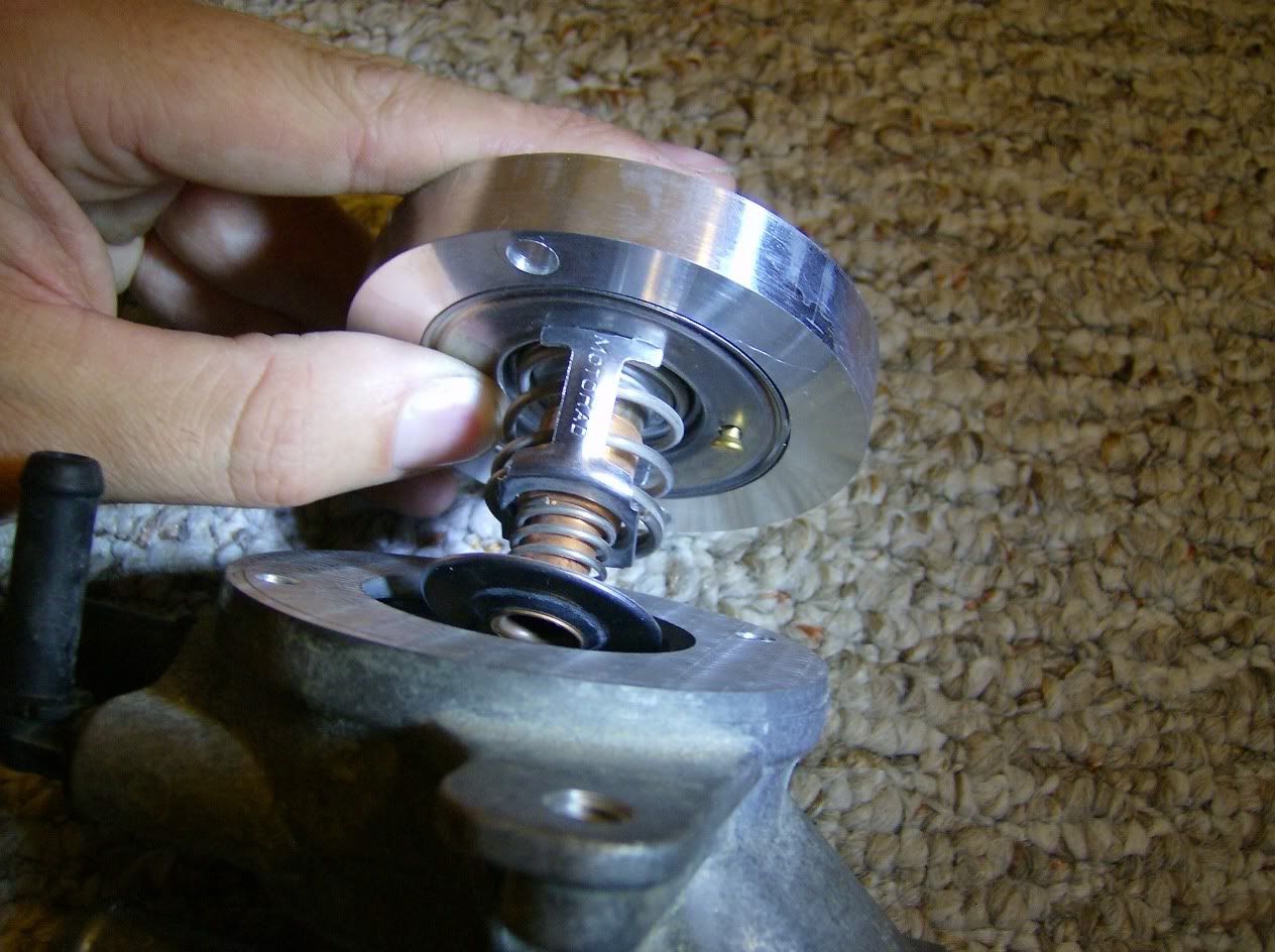

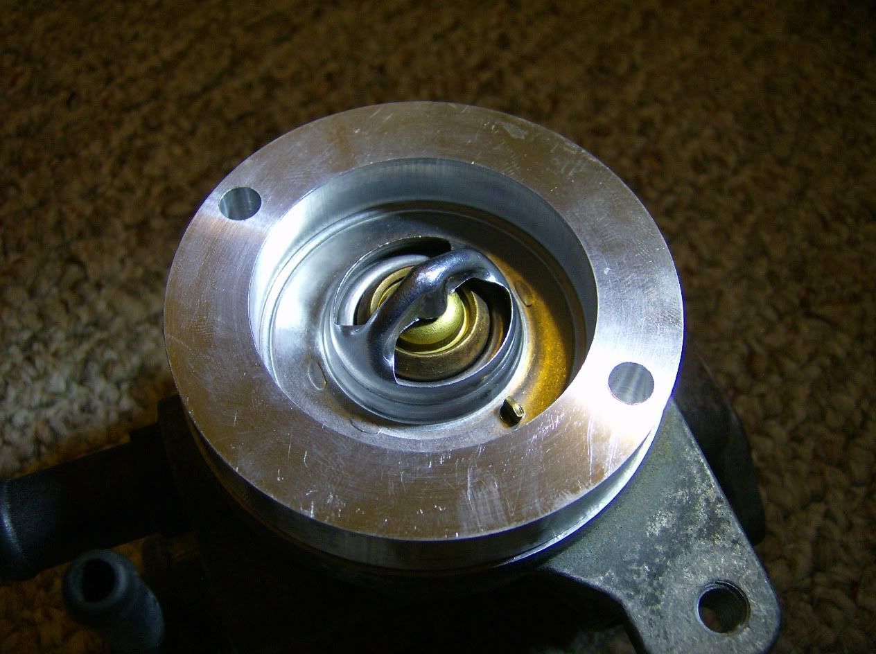

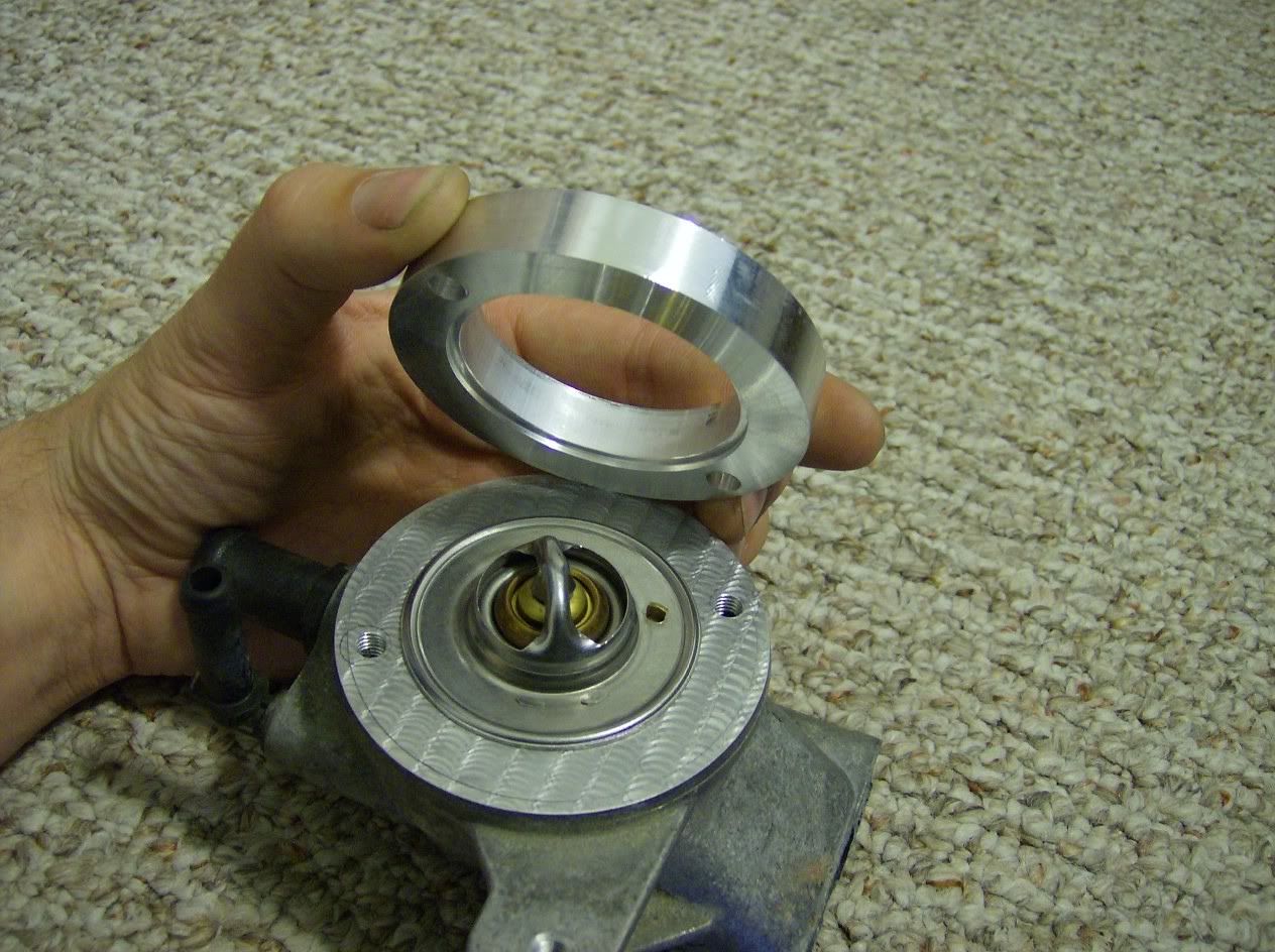

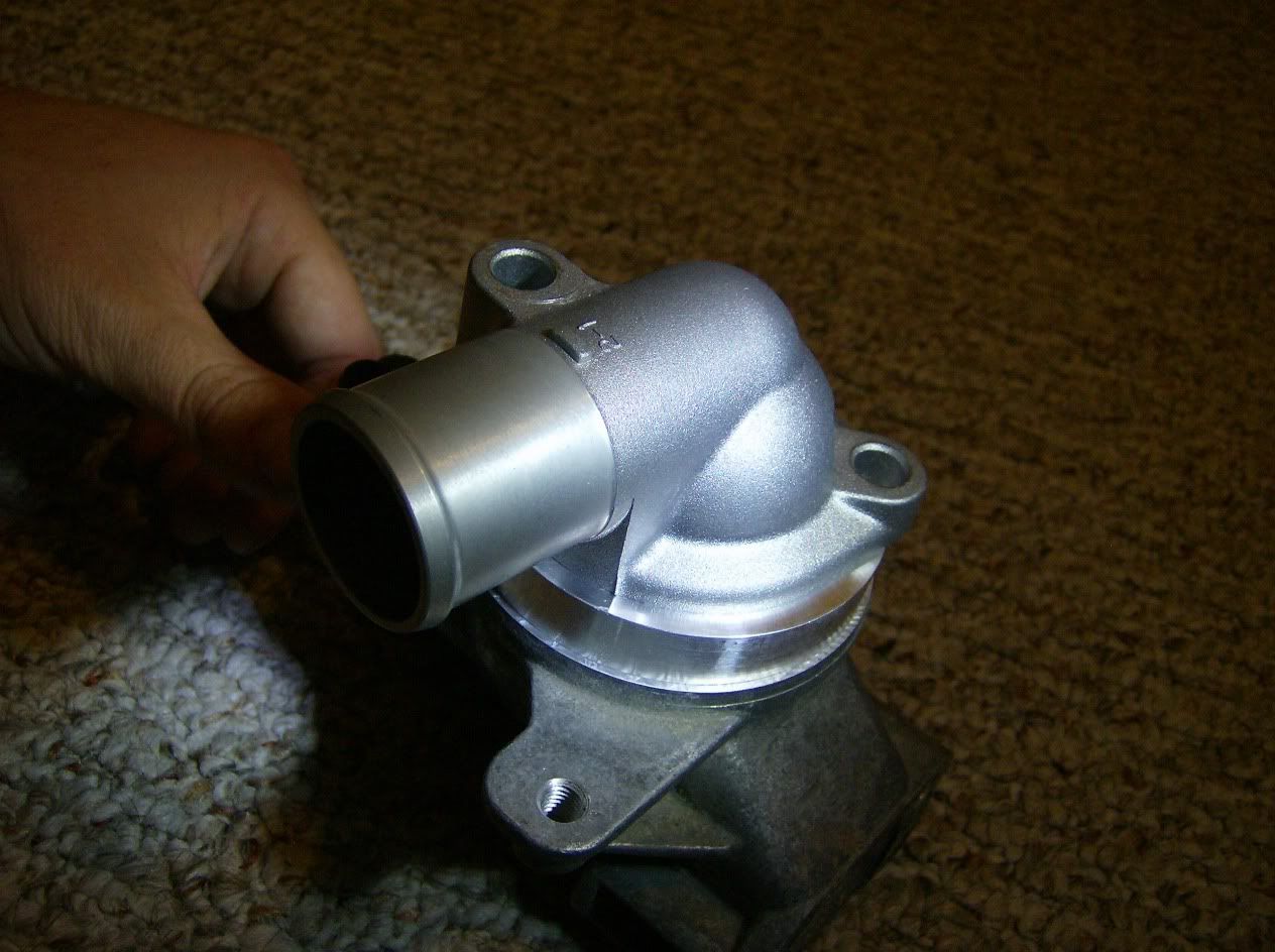

Assembly Photos (gaskets and studs are not shown for the example):
[img]http://i176.photobucket.com/albums/w189/mkzynski/Finished%20housing/TSassembly5.jpg?t=1273962610[img]
[/img]http://i176.photobucket.com/albums/w189/mkzynski/Finished%20housing/TSassembly6.jpg?t=1273962633[/img]

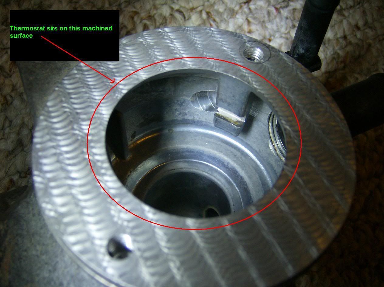

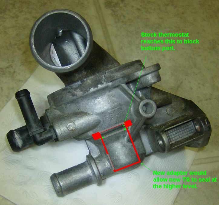

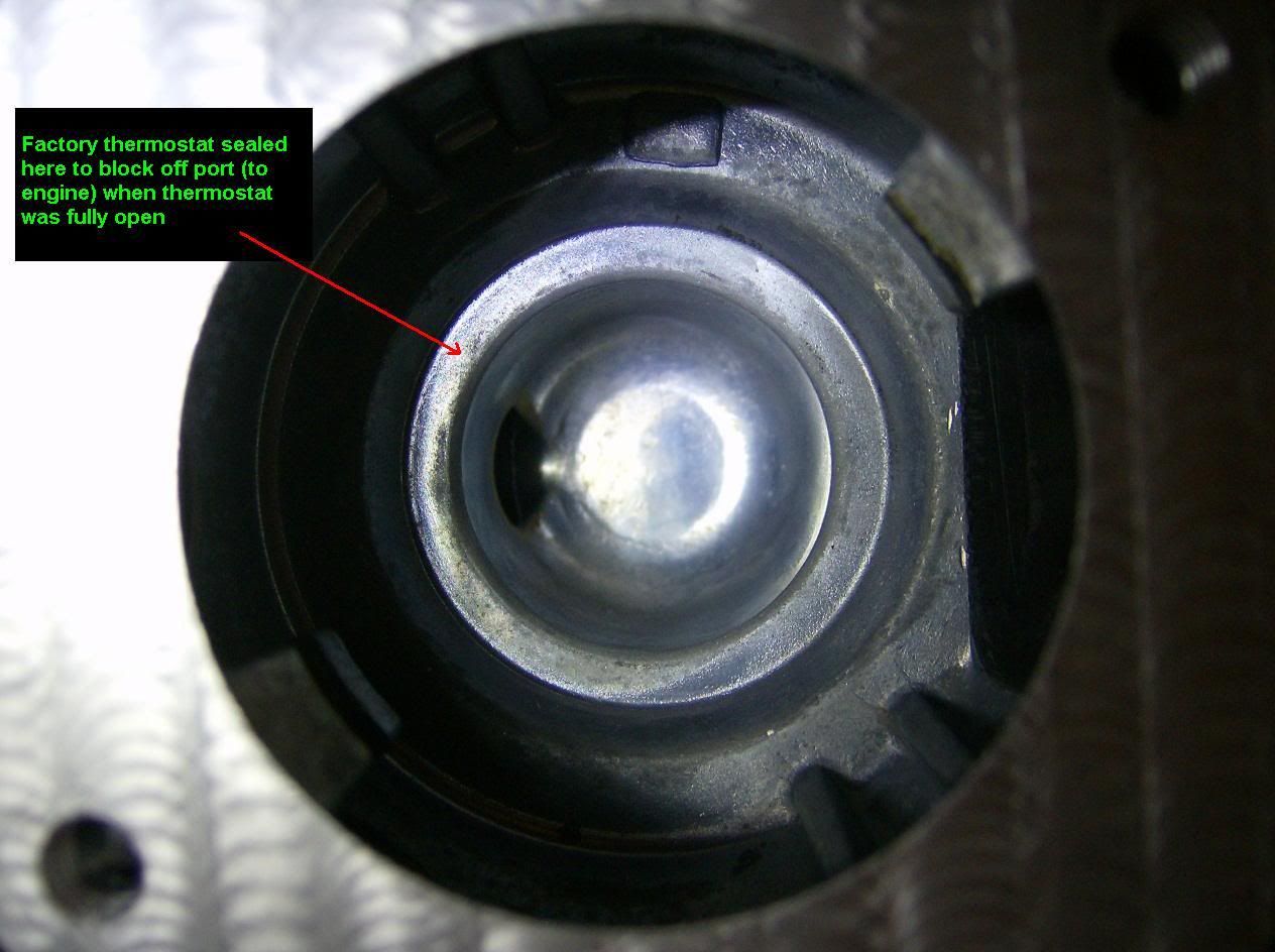

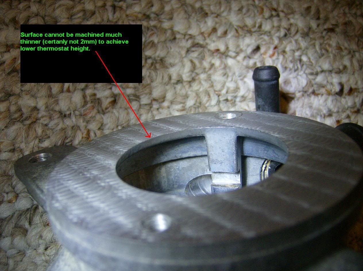

New thermostat does not reach this surface to block off the port (from engine to engine port).
Thermostat is already as low as possible. Machining the surface 2mm lower would compromise the housing and it would fall apart.
Solution: Make adapter piece that raises the block off port sealing surface 2-3mm higher
[img]lower%20sealing%20surface%20to[/img]

The edge of the area you could press it is at a 45* angle...cant press there. Unfortunately you would have to make something that can fit on the 90* angle sides further down that has a lip that comes up.
I will look into aluminum tube with an ID of 1/2" and an OD of 1-3/8". The part of the piece that gets pressed in will need to be around 1-1/8" in OD (thats what the hole diameter looks to be). This should be a relatively simple fix...just need the aluminum round-stock and the time. lol
All in good time my friends. :) I will first look on mcmaster-carr for a aluminum bushing that is the right size, but not likely.

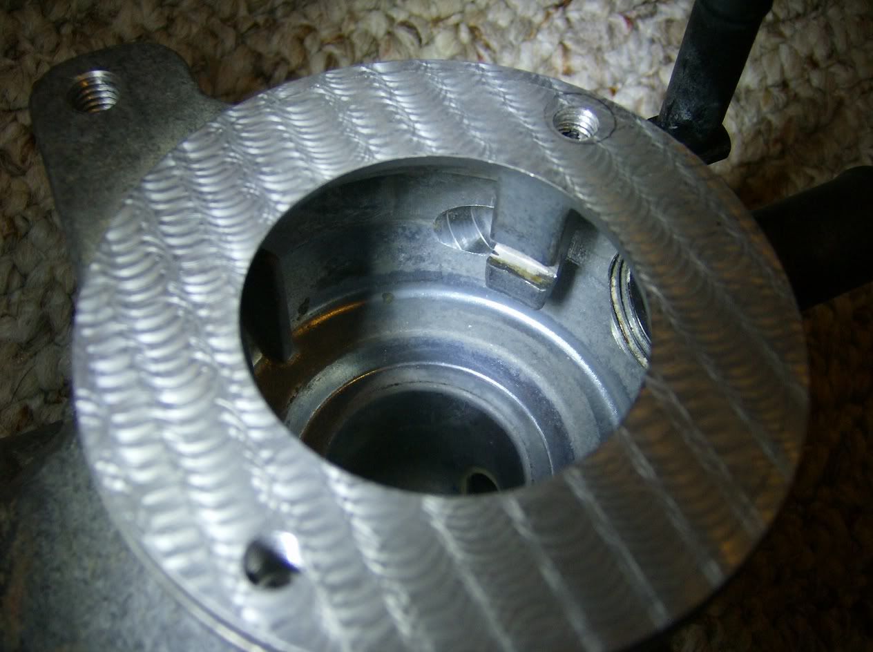

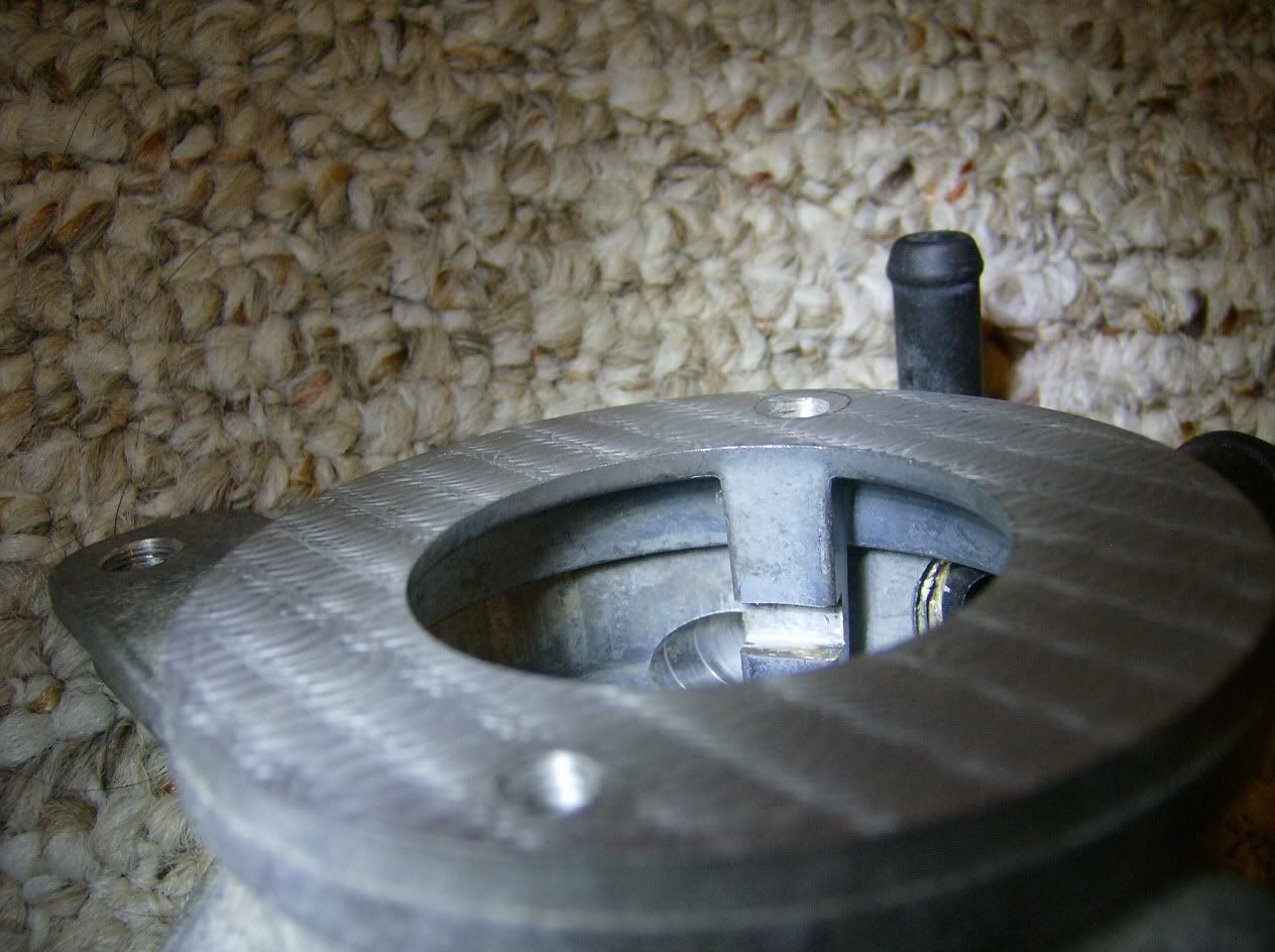

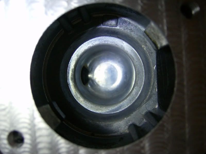

Ok, I think you are getting it. The upper disc moves away from the housing. The large diameter spring holds the tstat against the water outlet and keeps water from going through the radiator at closed tstat condition. You can't see in this pic, but the 2 flanges that stick out on the side are mounted in the middle of the housing. The lower disc is in a fixed pos compared to center shaft and the lower spring absorbs movement after the port is blocked adn the piston is still moving the tstat down further. The jeep tstat is not the traditional one you see in vehicles. On the Stock jeep tstat - The piston at the top is moved out by the expanding wax inside the brass cylinder and pushes against the housing iteslf. This then puts pressure on the water outlet housing itself and pushes the whole assembly down, away from the waterneck allowing water to flow from engine to radiator. As the tstat opens, the bottom flange of the tstat makes contact on the bottom of the tstat housing and seals and blocks off the bottom port back to the engine so water only goes from engine back to radiator at open tstat condition.
Ok, See photos below...the side wings I'm gonna call them rest in those little groves. This is how the large spring pushes the tstat in the closed direction...this force is overcome by the piston movement.
On my setup - The tstat opens by a piston pushing on a bar that goes across the thermostat iteslf (no pressure on water outlet housing like factory design) allowing the thermostat to open. As the tstat opens the lower disc gets pushed down and approaches the seating surface to block the lower port.
Piston pushes on bar going across the tstat on my setup:
So the only real difference is the stock jeep tstat pushes against the housing instead of a bar on the thermostat itself and the fact the factory tstat has a bit more travel capabilities. Thus we need to modify the bottom port so the thermostat can reach adn achieve full block-off during open tstat condition. See below:
Piston pushes against housing on factory setup:
Hope I explained this right...lol its is a bit complicated when you can't hold the parts in your hand. :)
