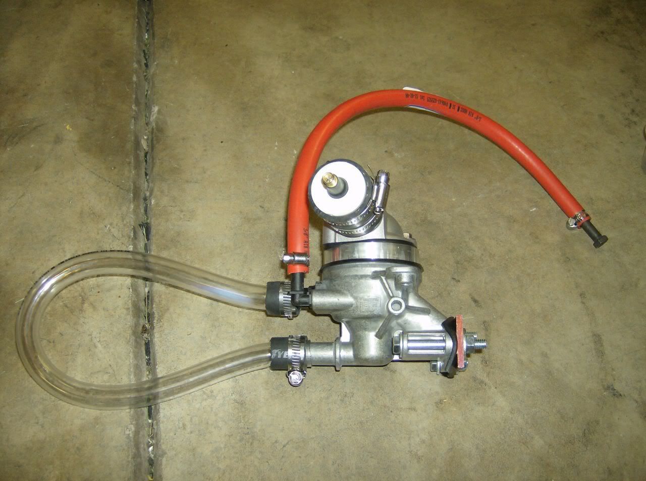

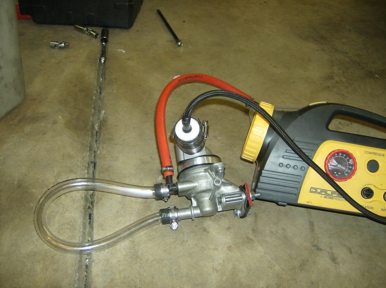

Another Update:
Well, I decided to try and figure out a way to pressure test the units...and...
Great Success!!!
I used a pvc pipe end plug and machined the plastic thinner and installed a tire valve stem for the water outlet hose. I used 1/4" plate steel and a custom made gasket to block off the rectangle port. I bought a 12mm x 1.5 pitch bolt, cut it to length and used a rubber washer to seal off the sending unit port. I used plastic tubing so I could see pressure building. I cut larger ruber hose to put between the clamps and plastic tubing to ensure the plastic nipples would not be damaged by uneven clamp force.
I used a clear hose so I could see the pressure building
Here it is with no pressure
Here it is as I pressurize the unit
As you can see here it is pressurized to 30 psi
Here's a close up of the gauge
After I build 30 psi, I remove the compresser
Another angle
From the back you can see the custom cut bolt with rubber washer installed
A close up of the plastic tube. Easy way to verify pressure remains
Lastly, the whole unit is submerged and checked for leaks with the 5 gallon bucket test
After passing the quality check, the unit is completely dried, the apparatus removed, and all ports are plugged with single piece clean paper rags to ensure no foreign packing material enders the unit during shipping. This way dissassembly is not required before installation on the vehicle.
Well, there you go....quality testing at its best! :BANANA:
