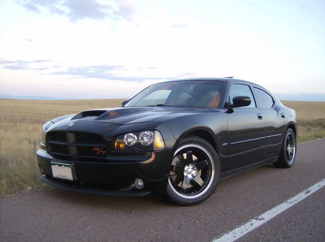

Squeeto, looks like you're not online, going out to dinner with wife...been a long day for both of us and I could use some good food. Applebees 2 for $20 and good food. :)
Good news is I got the charger back w/new hood and hail dents fixed, bad news is they need to readjust the sunroof as it is making wind noise now and may leak and they need to clean the rear carpet where it looks kinda stained. Wife had a bad day at work so we both need some cheering up.
I'll check back in in a coupple hours when I get back. :)
Just for fun, heres a pic w/the new hood. It looks nice. I'm doing everything I can to make it look like a RWD so ppl don't know its AWD...especially when insurance nearly covered the hood cost completely (only had to pay a little of the paint cost):
