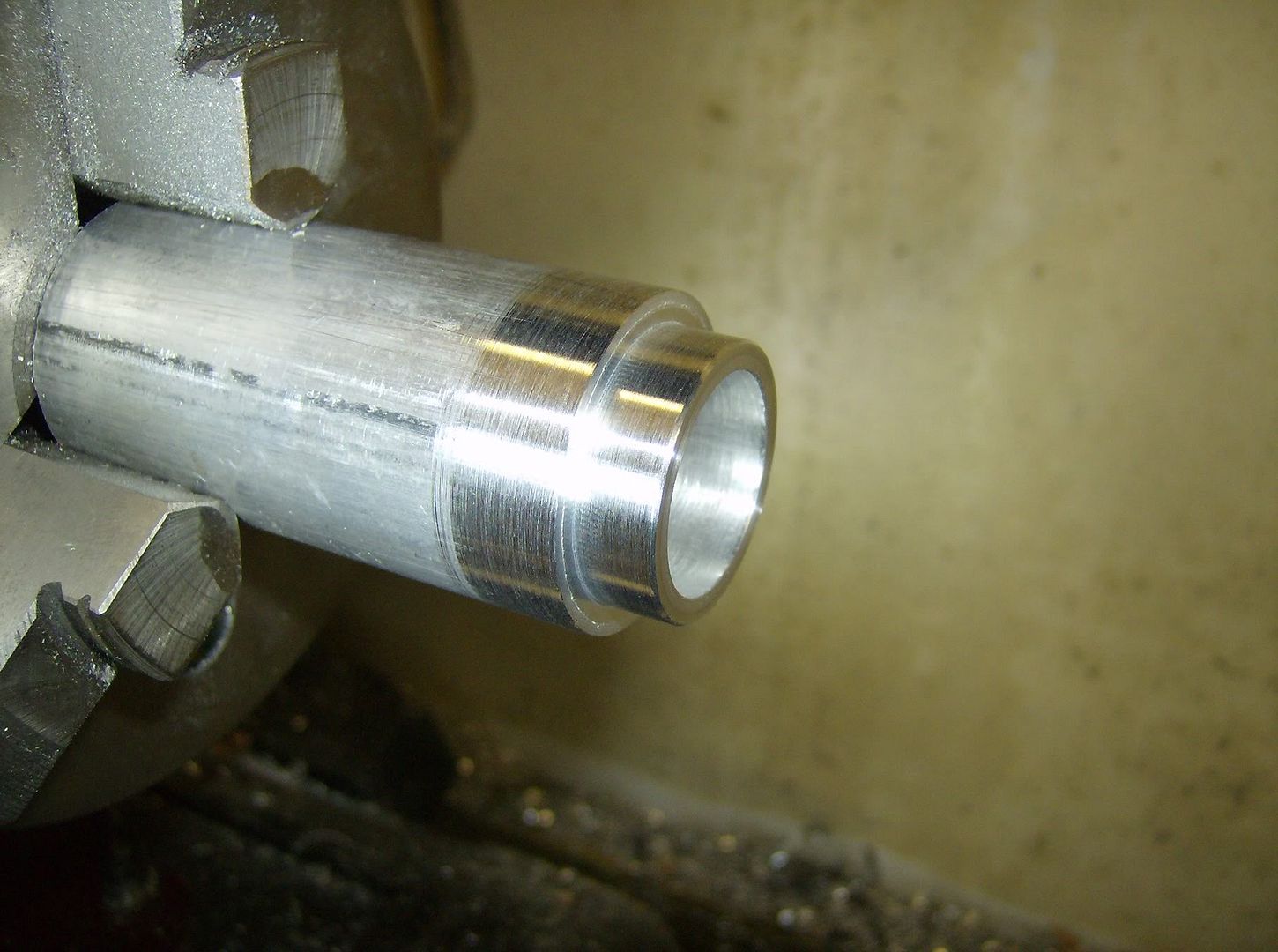

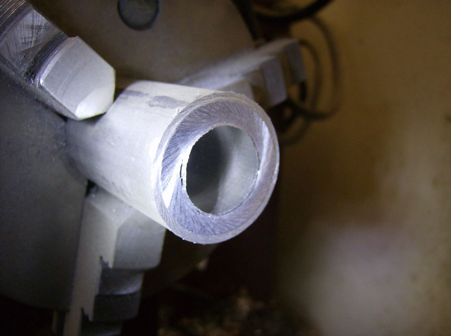

I have the aluminum all chucked up and faced...ready to machine the new bypass port insert when I get home if I am still awake enough after a 12hr shift.
I bought a new carbide tipped cut off tool. There were no carbide tipped cutoff tools the right size for my lather so I had to modify this one:
Here is the cutoff tool before cutting with guideline on it
Cut in half lengthwise to fit in my tool post
Cleaned up the edges and removed some sharp corners and ready to go!
(A little out of focus, sorry)

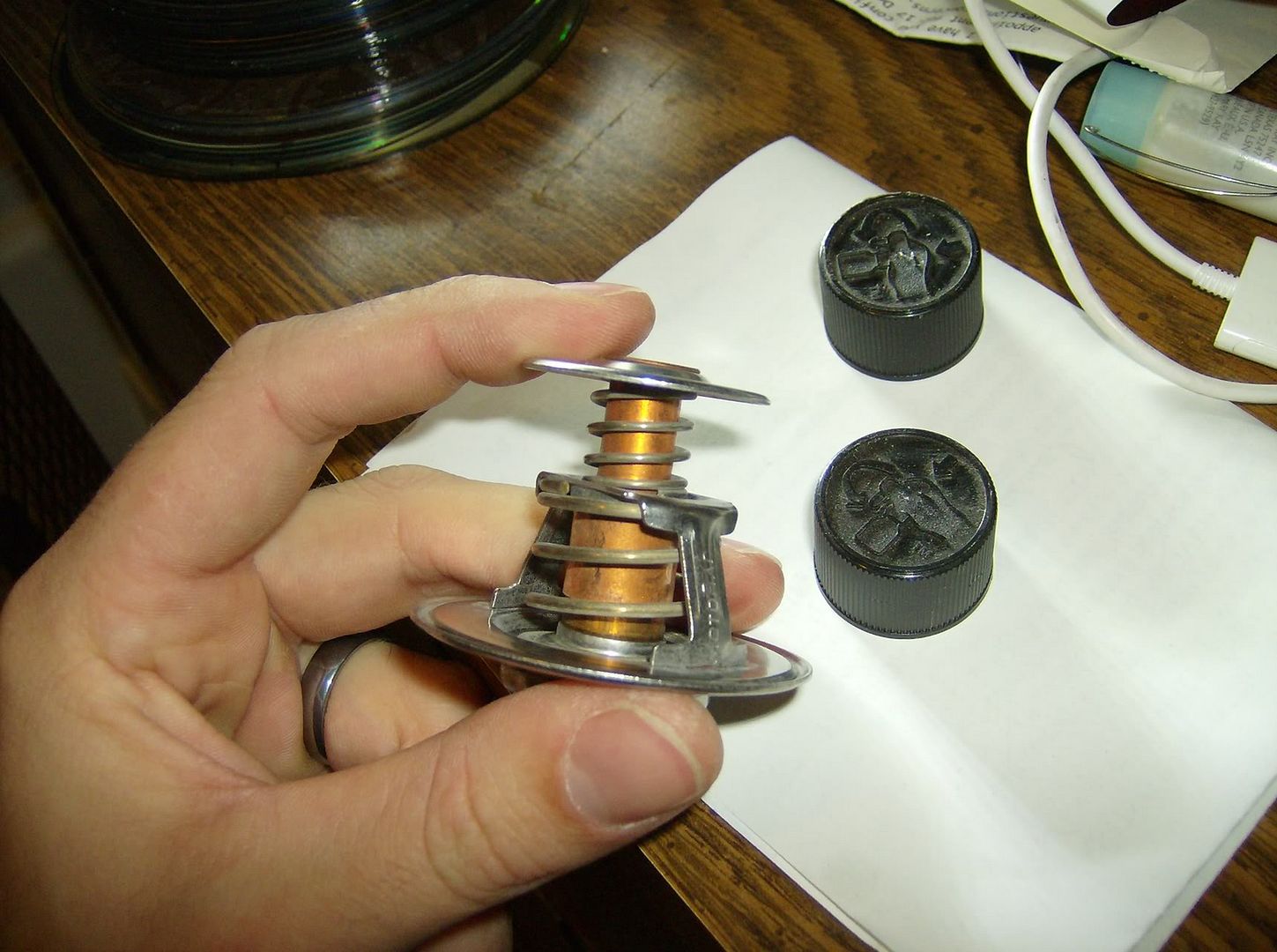

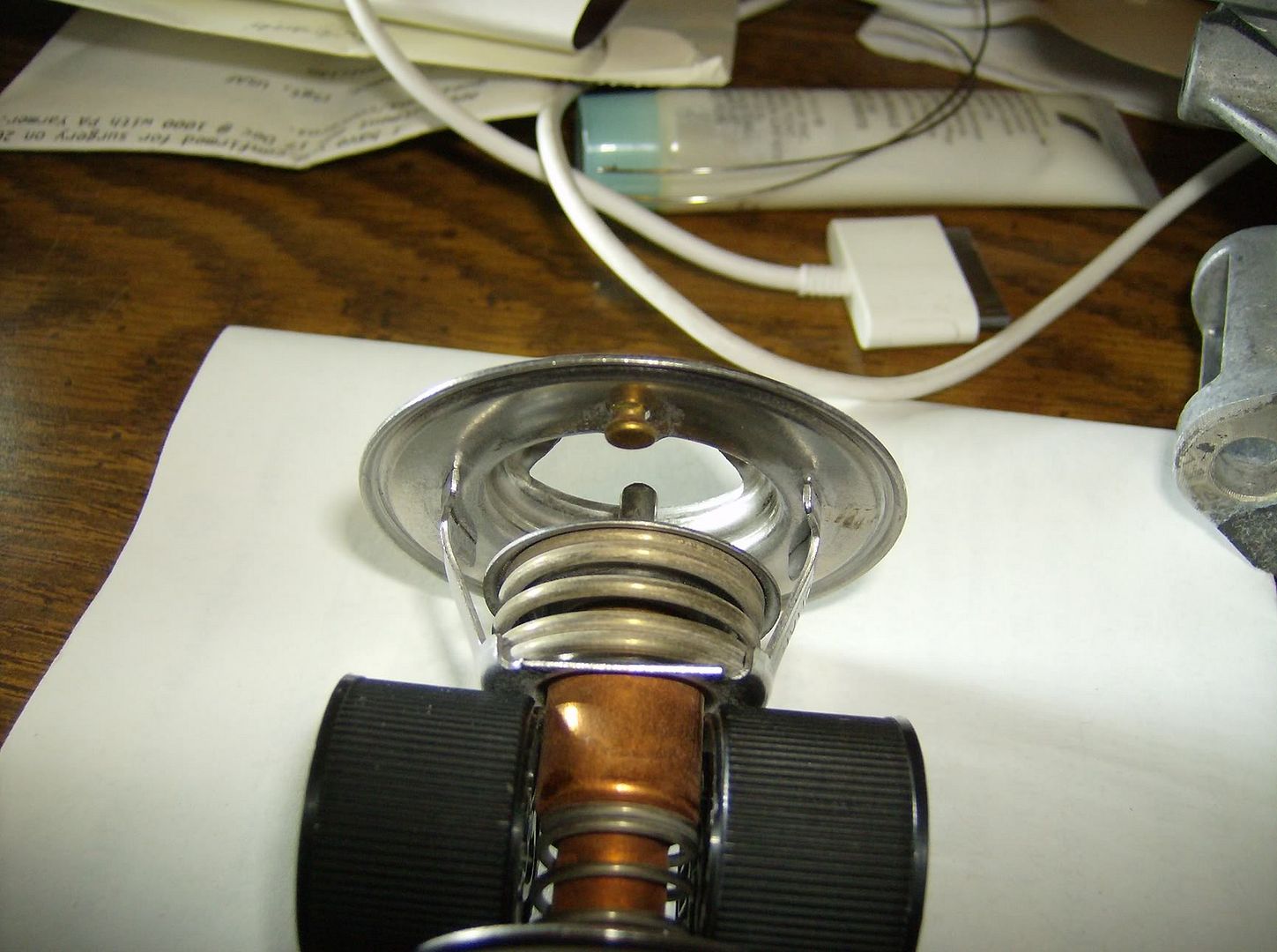

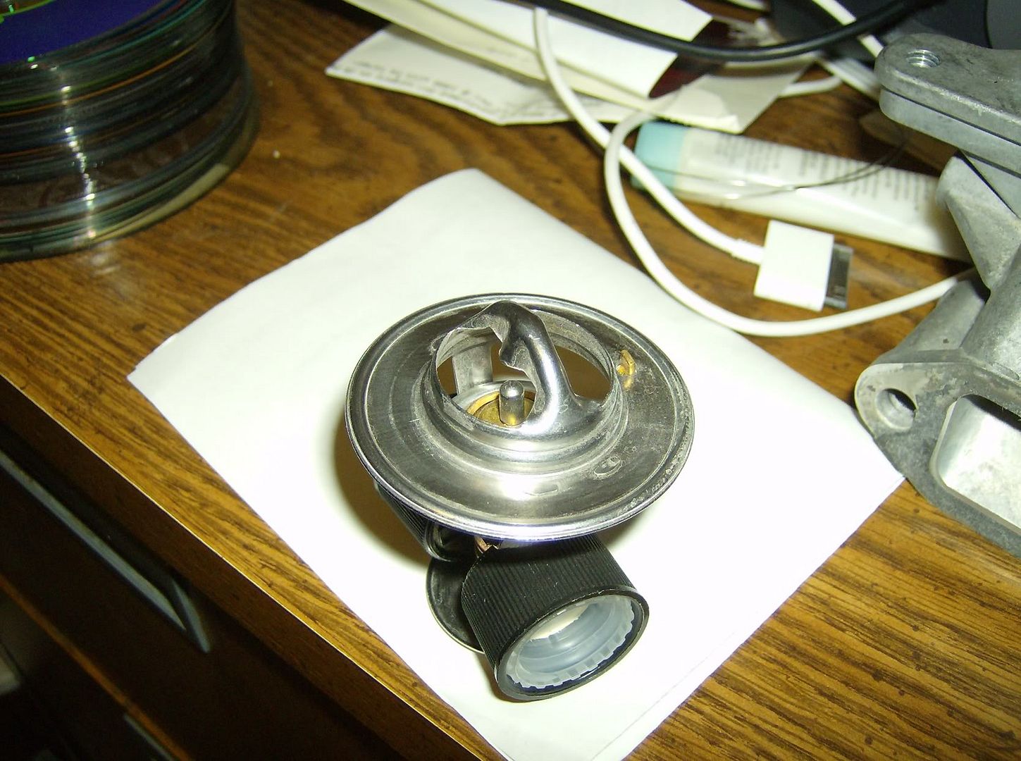

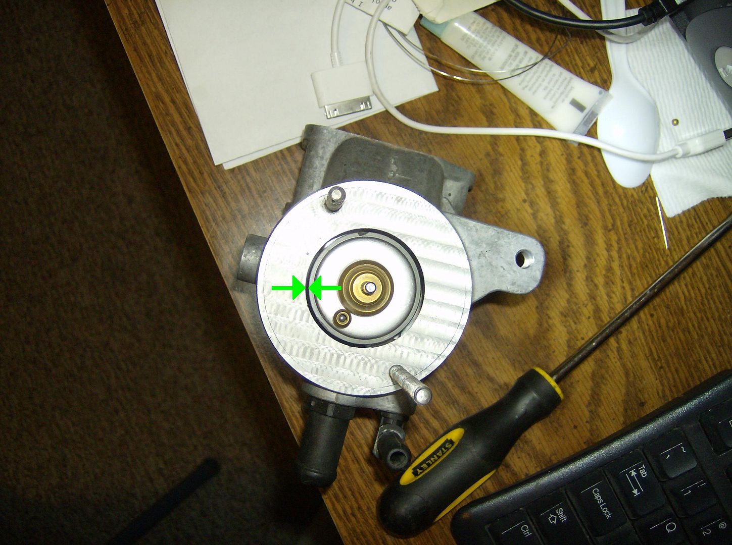

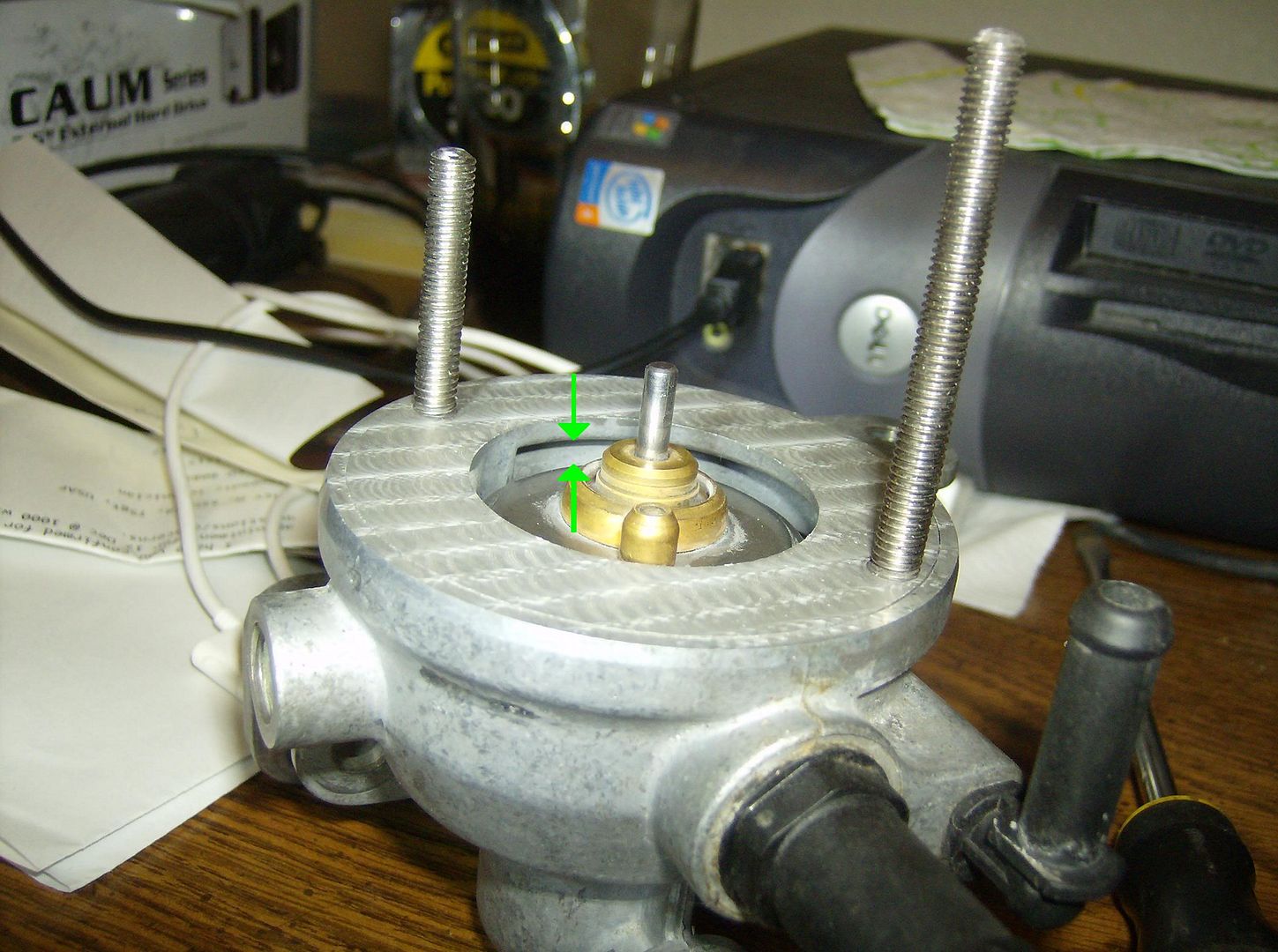

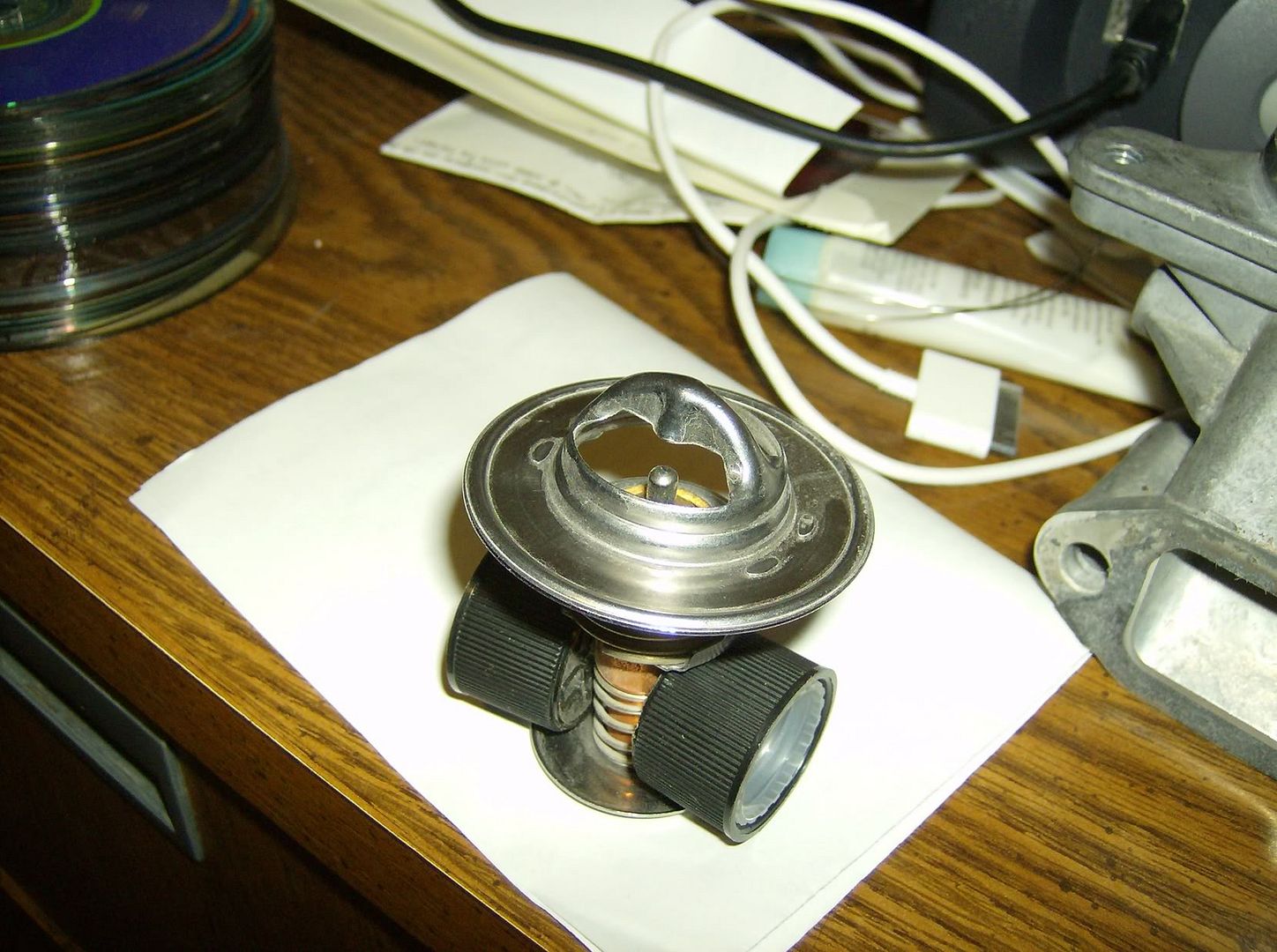

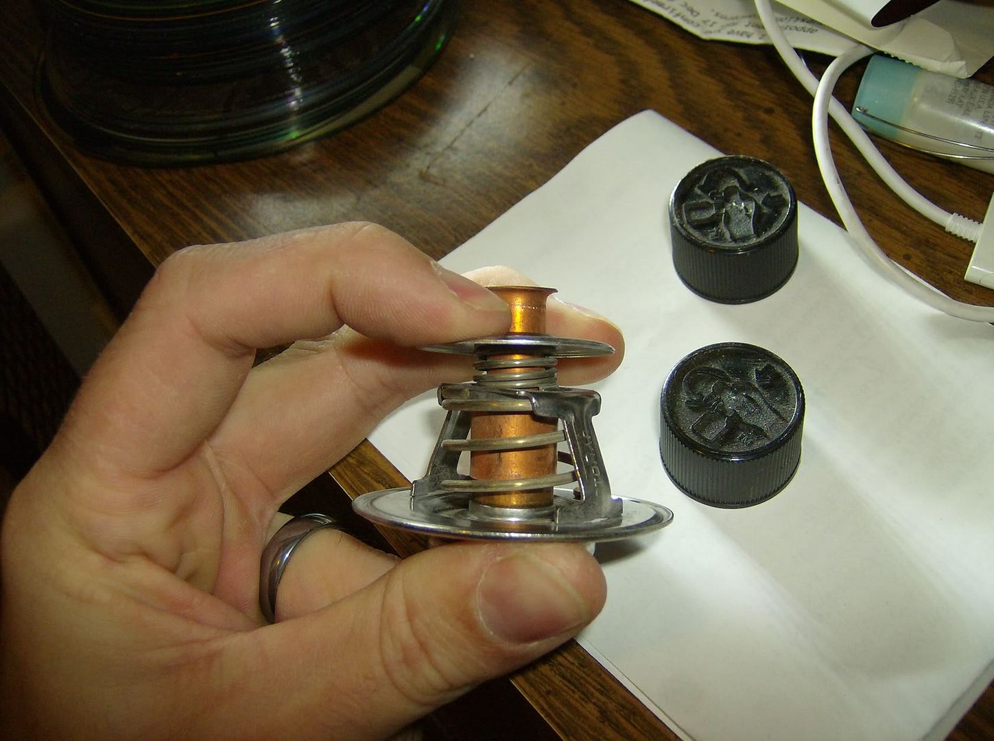

I will take some pics to explain my math, all is not as it seems. :) The original thermostat was basically in a tube w/less than a 1/16" around its diameter as it starts to open. To the sides of it when open it had just over 1/8" where it was barely out of its "tube" at full open. It is true that the new thermostat spec it self when full open has a smaller area than the old thermostat appeared to at full open if you only look at the thermostat, but with the original thermostat the whole device moved by pushing on the housing with its piston and it moved the whole thing down basically a tube and there is not much room around the tstat in the tube until it reaches the very end of its travel and begins to get out of the tube area and into the more open area of the housing below. So I do not believe, based on some calculations I made, that the old thermostat flowed more than the new one. So hard to put this in words...lol Hopefully this helps you understand, but I don't blame you if you don't quite believe me until I put up pics to explain this better. :D
*EDIT*
Here's some pics:
Factory thermostat at full open - barely any room on the outside diameter for coolant flow (shown by the green arrows - CLICK TO ZOOM)
Most coolant flow is through here, still fairly narrow opening (shown by green arrows)
Annother shot of factory thermostat full open
Here's the new thermostat - Plastic caps are holding at just over where it would be at full open, but very close
Side shot
From the bottom
Here is the bypass plate when not in contact with bypass port
Here is the bypass plate showing how much safety travel is built into the spring mechanism so things aren't damaged after the port is blocked if the thermostat expands further
Hope this helps explain - as they say: A picture is worth a thousand words. :D
- Mark

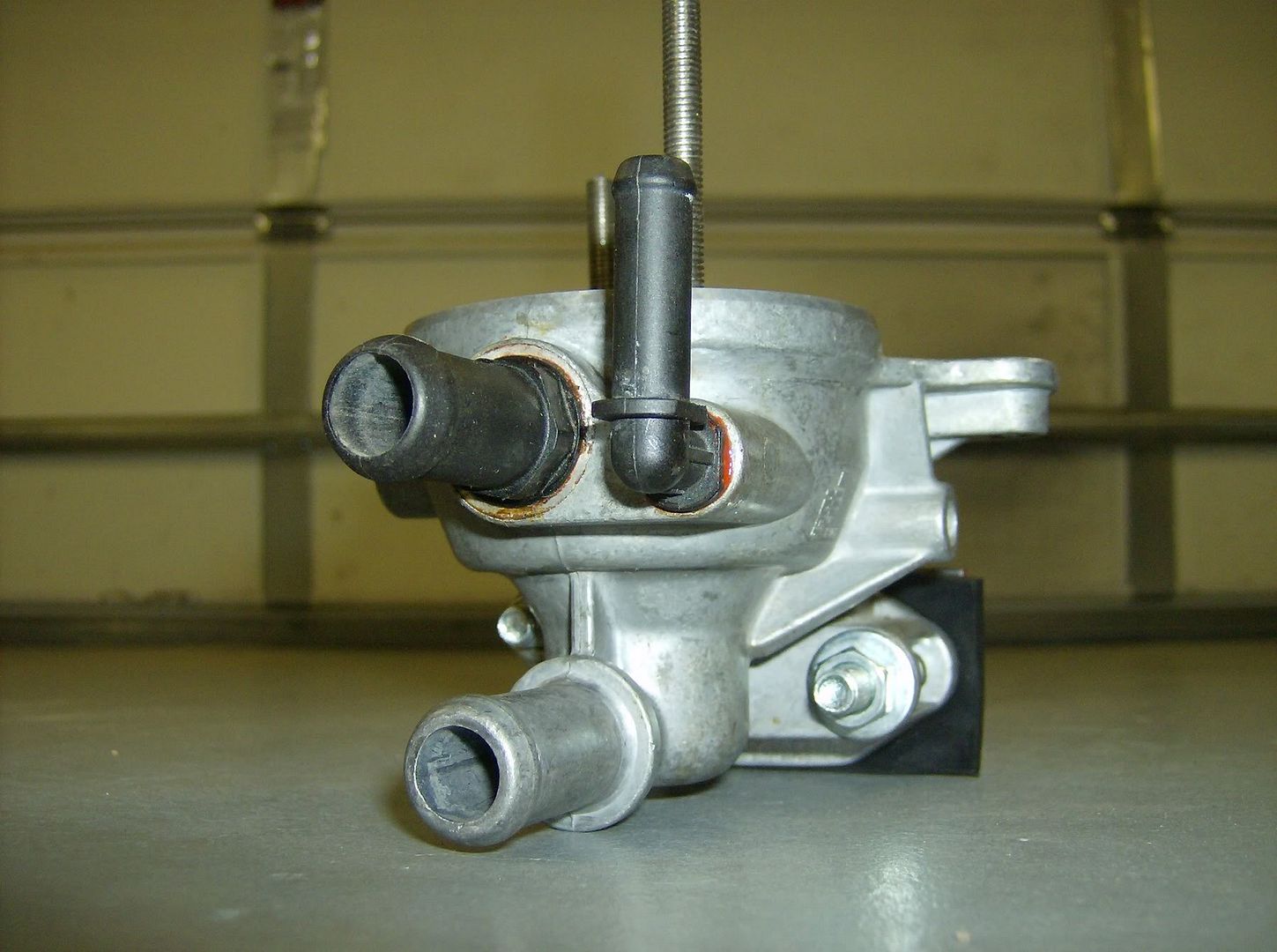

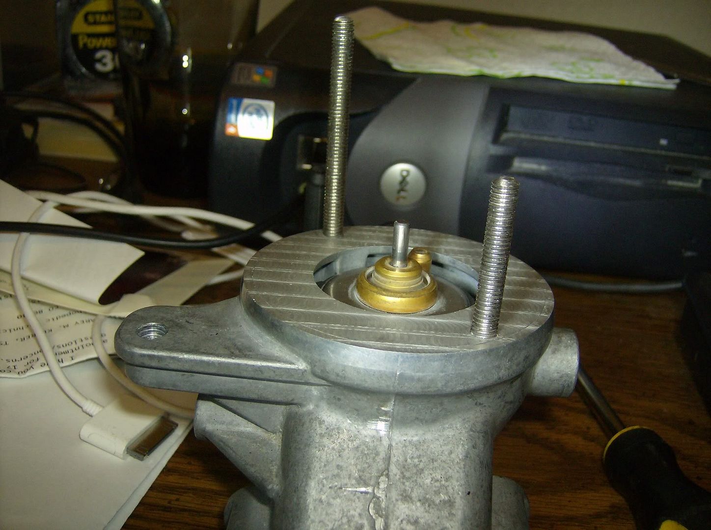

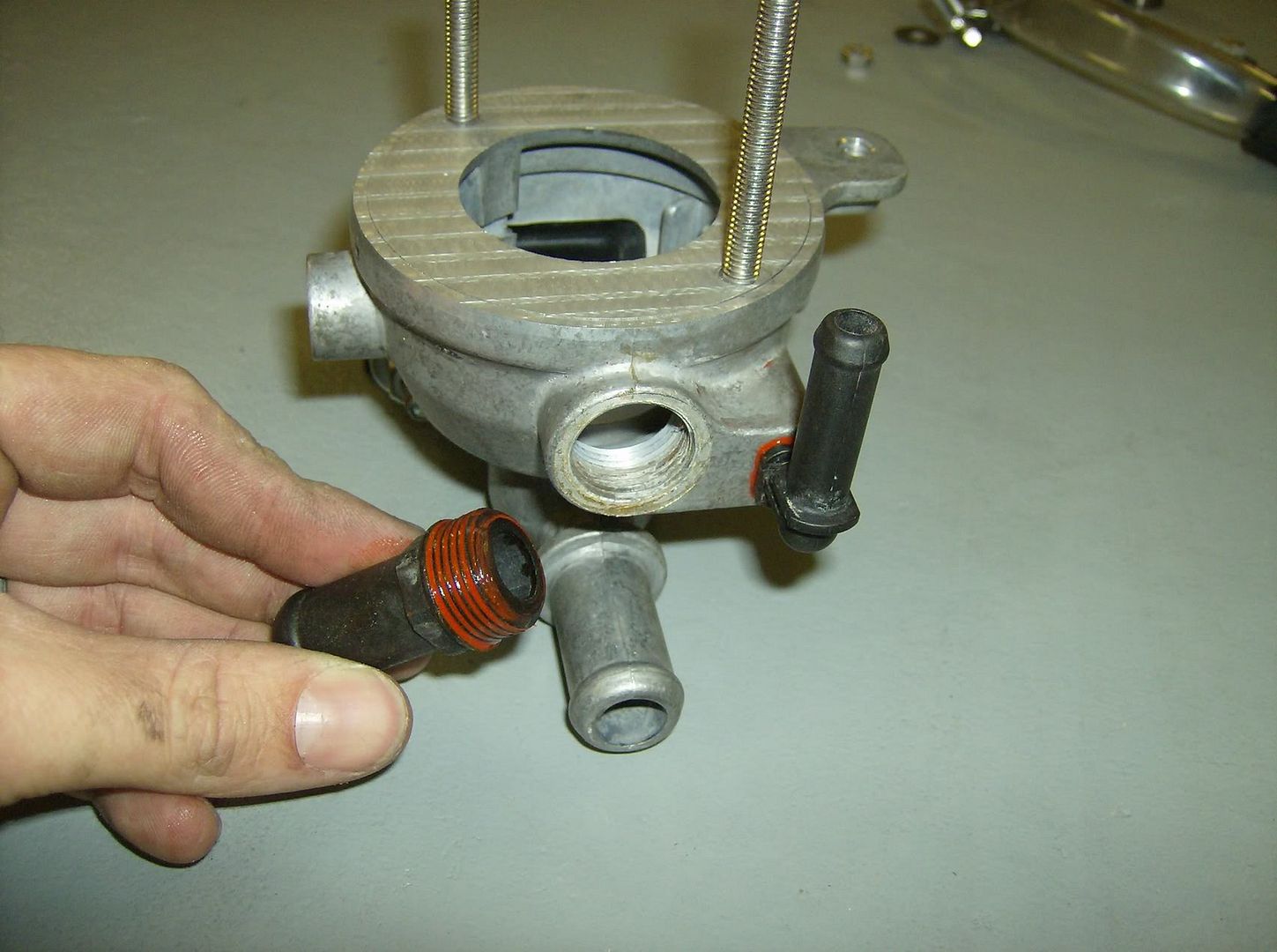

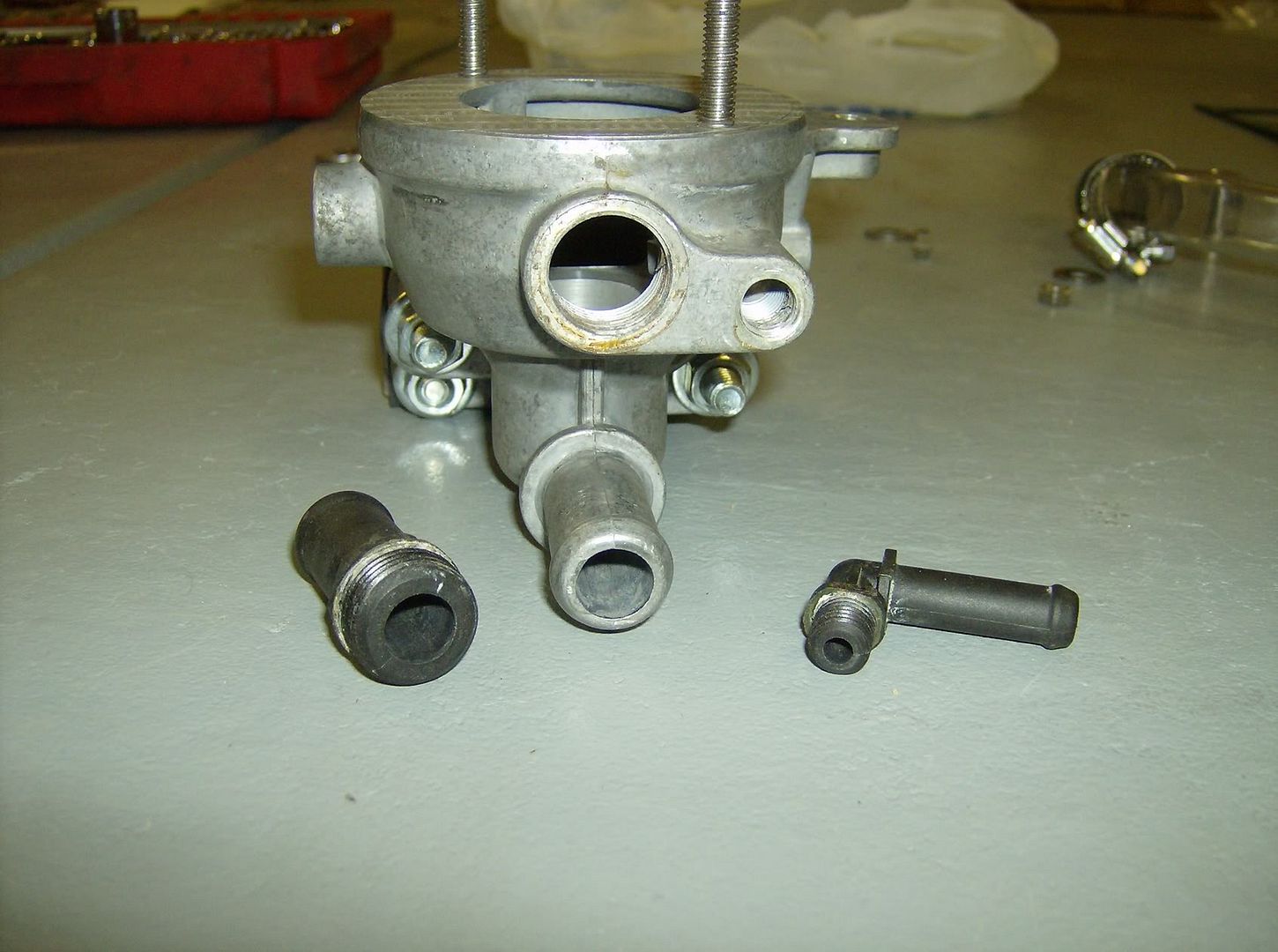

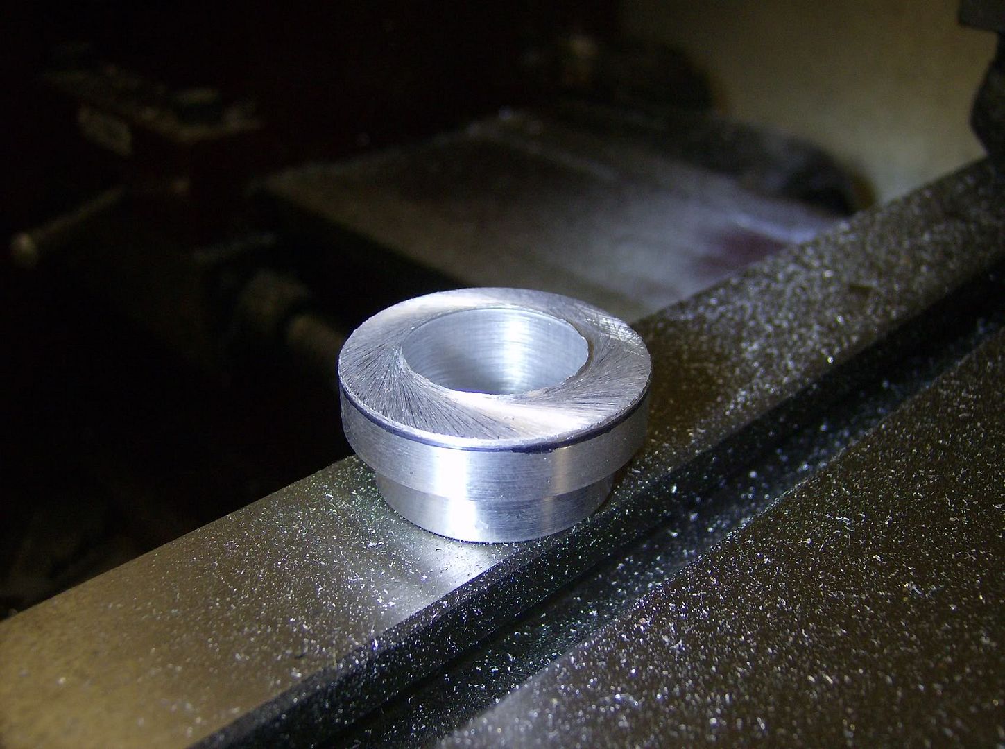

Up all night doing machining and other thermostat work. Got the new bypass port insert machined and pressed into the housing for geordi, got his all assembled with newly designed gasket. After assembly I did the 5gal bucket test and it was leaking from two spots - the small plastic port and the large plastic port. Barely leaked air, so probably wouldn't leak fluid out, but I didn't want to chance it so I unscrewed the large port (have to do this first to gain clearance to remove the small one) and then the small one...very carefully. To my amazement the plastic held up and nothing cracked or shattered. :pepper: Then It was all downhill from there. I resealed and screwed the plastic ports back in and it is curing right now. Also had time to machine 2 more bypass insert pieces and get them pressed in some units and cut one more gasket. Then since one of the units I am sending out is the 1st prototype I was using I had to remove the studs from that one since they would now be too short. I jammed 2 nuts against each other and then to my amazement and with a little bit of effort the studs backed out with no problems. :pepper: This is good to know since if you have been following this thread for awhile we decided to JB weld them in because JB Weld had the best resistence to glycol and heat, etc - better than any thread sealant available. Now w/the studs out I can re-JB Weld new ones of the correct length in and reuse the housing. Here's some pics from the night of work.
Machining one side of the bypass insert
What it looks like to use a cutoff wheel w/ a grinder w/ the lathe turning in the opposite direction to cut off the part
Here's the part, this gets flipped around in the lathe and machined down further on this end for a nice finish and the proper length
Here is the newly designed bypass insert next to the old design - just under 1/8" thicker than the old design
As mentioned before the factory sealant on the threads for both of these plastic ports had failed and they were both leaking so they had to be removed (now we know we can! lol).
After removal I reapplied sealant and reinstalled
All finished, just waiting to cure so I can reassemble the whole unit and pressure test again.
This is a perfect example of why I quality test ^^^^^^^, imagine how sad geordi would have been if he installed this and it leaked!!! It would have been a HUGE inconvenience for both of us and extra shipping costs, time, etc. Glad I found the leaks before sending it off so I could fix them before they could ever be an issue for him!
Well, I work again tonight and tomorrow night from 7pm to 7am and I've been up all night so I need catch some Zzz's before I have to get up again for work tonight.
I hope you all enjoyed the photos, it was nice to find out that the little plastic port was threaded in and is replaceable if it ever snaps off. A little peace of mind. :) Would probably go brass if this ever happens. I may end up going to the parts store and looking around sometime...I could possibly offer nice strong brass ports as an option for a small aditional cost.
Merry Christmas everyone!!!
- Mark
If you find a good fit in brass, I'd pay that cost. Merry Christmas to you :)

dgeist wrote:
- Mark
X-2

Curius as to why use brass and not aluminum like the housing itself?
 Post subject: Re: 192 Thermostats: Info/pics/waiting list - moved to 1st p
PostPosted: Sat Dec 25, 2010 8:48 pm
Posts: 5431
I've never heard of fittings like this in AL which is a very soft metal and easily galls. Most all plumbing fittings are plastic or brass so if one is ugrading from plastic the easy choice is brass. Works well but of course you have to be careful screwing brass into AL as brass is harder. My bet is these are standard fittings and brass upgrades can be easily obtained unless we are dealing with metric threads that do not match US type threads.
