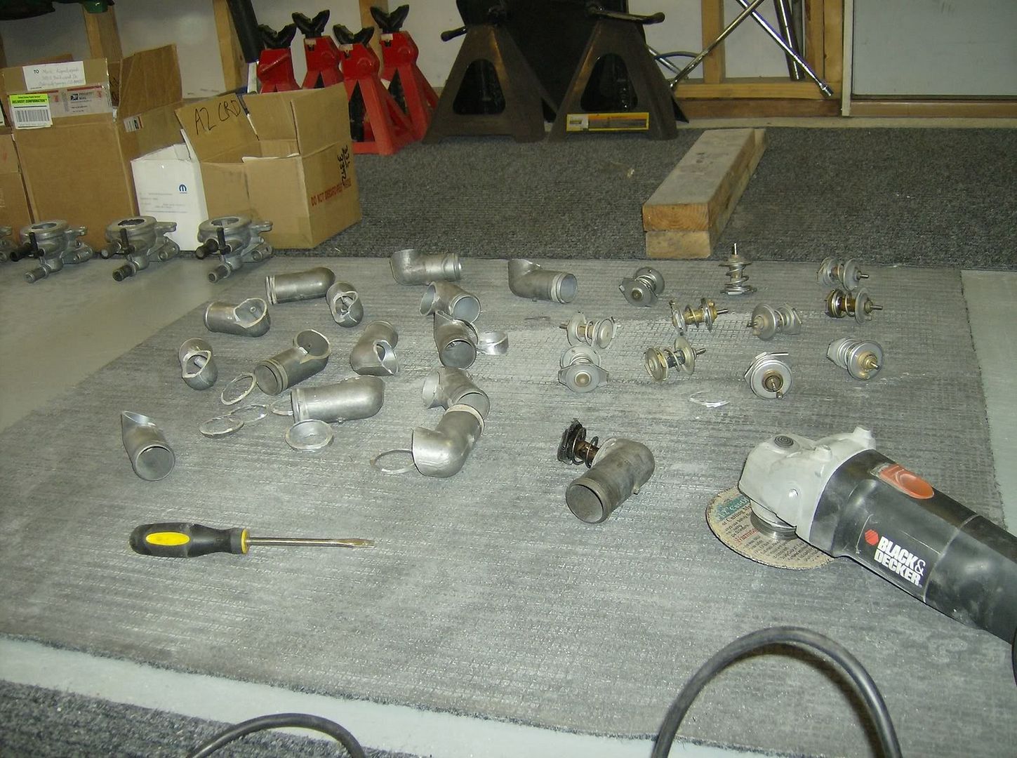

Update:
I marked all the units on a flat spot with an engraver to keep the cores straight so I can get your same core back to you and also just in case there is a cracked core or leaky fitting I know who to contact. If a 90º elbow brakes during removal I would expect the owner of the core to pay for the upgrade to the brass 90.
The good news is that in all cores (so far) that have had a leaky fitting the 90 has been removed easily (probably because the sealant is breaking down and degrading/leaking). The only 90 that did break was one that wasn't leaking, and the owner just wanted the brass upgrade for long term strength.
Seeing as whatever compound used to seal the ports is breaking down over time, it makes more sense to upgrade to brass sealed w/ the JB Weld so you don't have to remove the unit ever again to reseal the ports. <-- My :2cents: again. Take it with a grain of salt :ROTFL:
Stoutdog has the first brass upgraded ports (unit already shipped and received by him) and as soon as unit is installed we'll get feedback on how the hoses fit. :)
If the new slightly larger brass port fits stoutdogs factory hose nicely, we are good to go. If not, I will order some brass and drill/machine/thread from a solid piece.
Nelson15 has requested the brass, I will wait untill I hear back from stoutdog before I send nelson15's out w/ brass so I know if a smaller straight port is needed.
I'm going to be slicing all the cores up in the morning when I get off work (step 1). Time to start the next batch. I think we have 12 or so cores now so it'll be a busy morning. Hopefully this batch will go quickly. :)
If you want in on this batch, send your cores ASAP. Once all the tops are cut off and all the core surfaces are flycut flat, that closes the batch since I will be setting the lathe up to machine the round parts and don't want to go back and fourth. All cores received after that point will be in the next batch.
- Mark

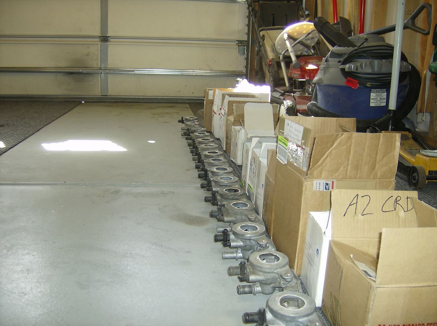

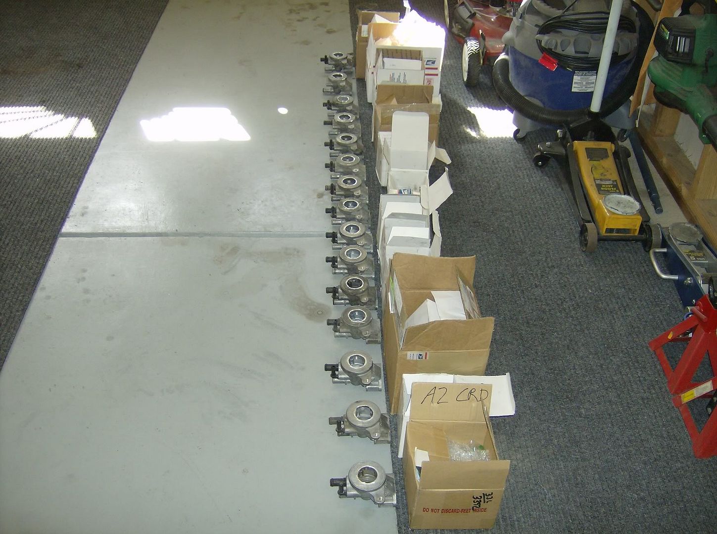

The carnage in my garage is hillarious, total of 15 units all getting tops cut off at once. Just had to take a few pics and share. :frankie:

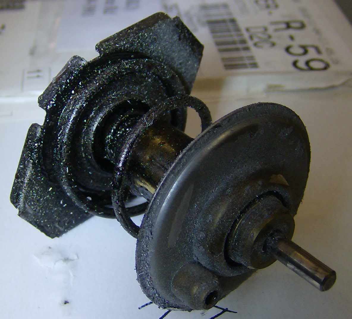

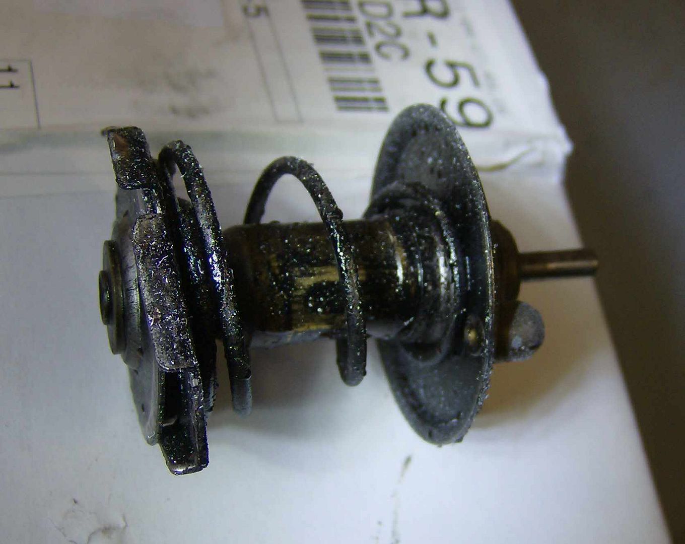

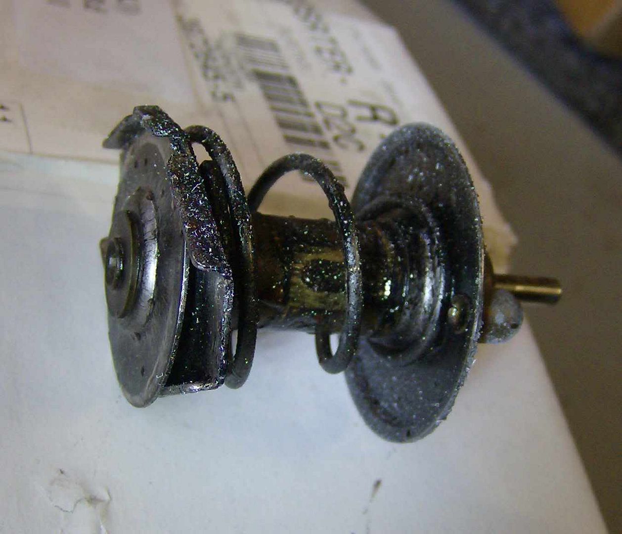

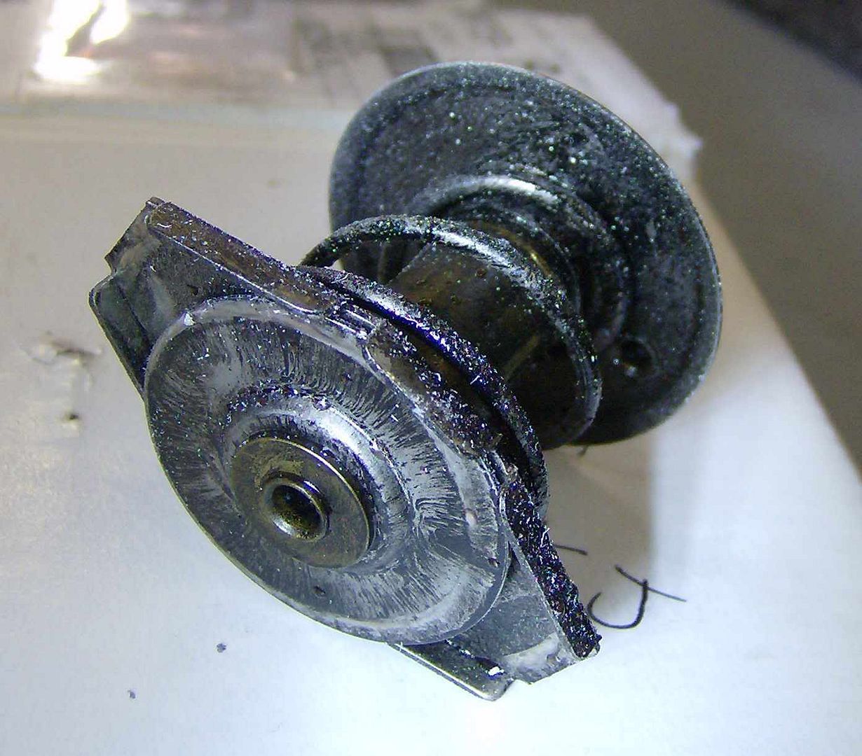

I almost cried as I cut the 3 BRAND NEW thermostat housings open. Roughly $300 in brand new units getting cut open for cores. Some people wanted to get in this next batch and sent me new ones. It DID offer some good insight though.
Originally I was thinking the thermostat springs were weak allowing the thermostat to fail open.
Getting to cut the new units open allowed for proof of this concept. It was obvious to me as tested the spring tension of all the old units and compared it to the tension of the new units that the metal had just fatigued and that it is the SPRING that is weakening over time on the factory thermostat and allowing the thermostats to open prematurely.
- Mark

Another quick update:
:!: :!: :!: I noticed this with one of the thermostat cores: :!: :!: :!:
It looks to me like there was definitely oil in the coolant at some time. Hopefully the core was from someone's bad engine, or the oil on it was from something that happened in the past, etc and its not a new problem. This could possibly be a head gasket gone in a spot between oil/coolant passage with the engine having oil mixed w/ the coolant. Or, possibly it had a head gasket go in the past and it is just a little oil that was stuck to parts here and there and it's fine now. A lot of possibilities, but it should be looked into.
Thankfully I marked all the cores with the engraver so I know who's it was and I sent them a PM.
Anyway, I'm done in the garage today, off to bed...working night shift again.
Check your messages to see if you got a PM from me.
- Mark
Ha! That's the most organized carnage I've ever seen :)
(yippie, yippie, mine's on the floor there somewhere) :BANANA:
Dan
Dan
You make me laugh inside :D
The good news is that Step 1 is done, and yes, yours is down there somewhere. :) The bad news is my wife just ran over all the units while backing in the Charger... :JEEPIN: ...OOPS!!!
...Just kidding. :goink: Thankfully I thought ahead and picked them all up before I came in and took a shower. She just asked me..."you did pick those up right? Because I already backed the car in" as I showed here the photo of the hard work I completed.
:ROTFL:
