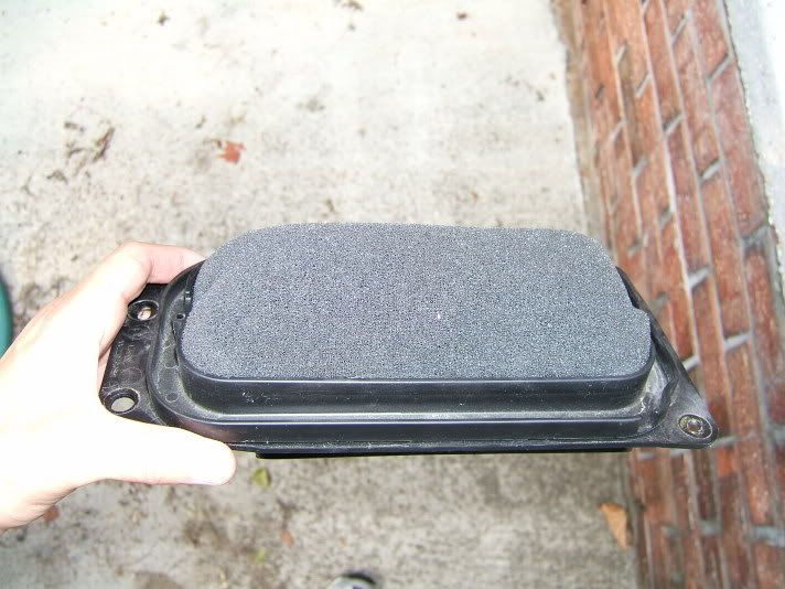

I put the aftermarket Mopar filter on my mother Jeep. They didnt make one for the KJ so I just used regular filter media. Not as good as the WK filter, but it helps.
PostPosted: Wed Sep 26, 2007 8:05 pm
How often do you clean/replace them?
Oh wait. How often should they get cleaned/replaced? :lol:
PostPosted: Thu Sep 27, 2007 8:49 am
Mine has been in there for two years and Ive not checked it. :shock:
haha, I use the inside air more than the outside but I would say its time to check it.
The WK filter should last longer since it has more surface area. Ill probably change it every 30k or so.

Actually there is a cabin filter:
This is the receptor:
-->23 55037522AA

And these are the filters:
3F QUALITY 1580
Cabin Filter
adaptor 55037522AA
Filter type: Pollen Filter
Trade Numbers:
- 1580
- E1580
- S1580
- XF1580
This Italian company (3F) produces
the same filter as eolo
as orione
the 3F company that makes the filters above sell mainly to Europe/russia under it's 4 brand names (eolo, eco, orione and flash-air), but you can either order them from any online store that carries them, or just have someone import them.
Here's another one
from FRIGAIR part# 1318.5382
FYI, this
goes on top of this
2008 JK Rubicon CRD

I just bought a 55037522AB and it is NOT a cabin air filter GRRRRRRRRRR.

Like the last pic states '01 KJ's and the pic above that states that one only fits KJ's made from 10/01 to what ever,what about the KJ's built from 03/01 to 09/01? Oh and yes all considered model year '02 by the VIN,heck the '14 WKII's are going to be hitting the dealerships in about 2 weeks and it's not even Feb of '13 yet.

jinstall wrote:
is this like this on top or anything similar? :?
2008 JK Rubicon CRD

So where is the filter / part number ??
Looking at the listings it doesn't make sense plus these never had them from the get go
What doesn't make sense? The filter receptor is the same for a lot of Chrysler models.
The filters are from 3F and Frigair (at least the ones I found recently)
2008 JK Rubicon CRD

Well I have 2 friends in Germany looking and a friend in Romania looking for these filters. I am going to try one and see if it fits. If it does, I might order a 100 of them and sell them.
I saw the RECEPTOR part AFTER I picked up the Jeep part from the dealer. The AB part is different from the AA part#. It has a square basket instead of the round basket like is shown.
How does the filter mount? If it replaces the "receptor" then thats fine, if it goes over, then the AB part # will not interchange.

yes considering I looked up the filter# he posted and it came to within mm of the OEM part# he posted. I have been researcing this for about 3 days now. More so the filters not the OEM part.

Here is the profile.
There is a filter for the AB part as well - the AB one was fitted after 06 I think.
And they both sit on top of the receptor. Actually if you look at the pivs closely, it is secured with a screw on each side.

Here is the one for the AB
