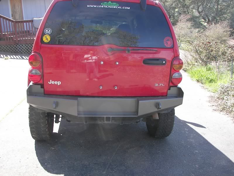

Here's what Marty sent me. Good stuff
I can't find that PM now, so I don't remember all I wrote, but it is pretty simple. Remove stock bumper and flares. Cut slots in rear crossmember pinch weld directly inline with framerails and the same width as shown here:
http://www.rocklizardfabrications.com/100_3721.jpg
http://www.rocklizardfabrications.com/100_3722.jpg
Approximate dimensions of cut although it is a good idea to cut just a hair over to make sure the bumper slides in and out without catching on the pinch seam:
http://www.rocklizardfabrications.com/100_3720.jpg
http://www.rocklizardfabrications.com/100_3723.jpg
Run wiring through notches in bumper mounts, but not between bumper and rear crossmember face (not enough room. Line up holes with holes in framerail (use a round bar/hole finder if slightly off to get bolts lined up with bumper/skid/hitch/framerail). Get the bolts snug but not tight so you can adjust the bumper side to side/front to back for best alignment, then tighten bolts to specs. Put flares back on and mark them in a straight line with lower bend in bumper quarter plate as shown here:
http://www.rocklizardfabrications.com/100_2112.jpg
http://www.rocklizardfabrications.com/100_3009.jpg
Use supplied trim to put on edge of cut flare to give clean finished look.
Matt again: I'll say there's an art to mounting it. It can be done with one person. First, use a jack to hold your tank skid in place an center it on the bolt holes. Then lift the bumper and sit it on the 'shelf' of the body. The bumper will just sit there and you can whip a couple of bolts to keep it until you center up all of them. 15 minute job once you prep it ala Marty's instructions above.
ps: pound the dents out of your skid first.

JJsKJ wrote:
Thanks for that info Matt, that will come in handy.
That 'ledge' part was the grandest revelation. Sure beat wrestling all that weight.

PostPosted: Fri Mar 23, 2007 7:52 pm
Posts: 786
Location: on the bayou
cool thanks for the write up Matt/ Marty. A couple more questions. How did you get the rivets out on the inner bumper piece? Drill them out? Second, how about measuring and cutting the rear flares? I have a bagfull of plastic rivets, but broke a couple of the other plasic clamps.
oh DaveKJ, I used Hammered. Put on two coats of auto primer then four coats of Hammered. hope that holds up. Did the gas skid too, just so it'd match.
thanks
mike
PostPosted: Fri Mar 23, 2007 8:34 pm
Mr. Machine
Mr. Machine
Posts: 1340
Location: Sebastopol CA
Signcutter21 wrote:
cool thanks for the write up Matt/ Marty. A couple more questions. How did you get the rivets out on the inner bumper piece? Drill them out? Second, how about measuring and cutting the rear flares? I have a bagfull of plastic rivets, but broke a couple of the other plastic clamps.
thanks
mike
Drilled out the rivets.
Took Marty's advice and slipped the bump on first, the marked the cut with tape. See his pic. Then removed the bumper and used a sabre saw with a wood blade (counterintuitive but it gives a better cut) to cut the flare.
When I broke some front clamps, NAPA didn't have a replacement (as they do for the rivets) so I had to get them from a dealer. The white springy things, right? Actually the bumper has holes for attaching them back but I did not do so. I found that after putting the rivets back in the flare was tight enough.

Install went fairly easy. Probably two hours of work between taking the bumper off and test fitting the new one and tighting it all up. Had a extra set of hands which made a big difference. I'll try to get pics up in the next day.
Found it easier not to take the flares all the way off. Just popped the back three rivets out. Used small cheap hacksaw to cut the flares. Used dremmel to get the pinch seam nice and even.
later,
mike
Oh yeah. I should have mentioned there was no need to totally remove the flares.
