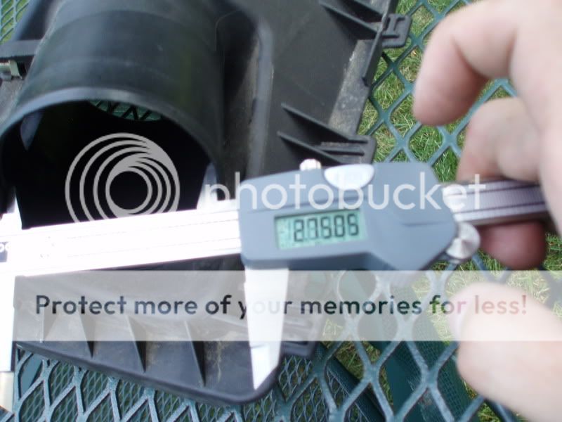

Any change in the diameter at the MAF will throw off its reading. It's calibrated to that diameter pipe.
I'll have to break out the calipers and measure the exact diameter of the original MAF housing and compare it to the new one.

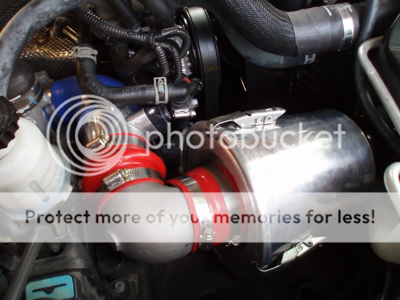

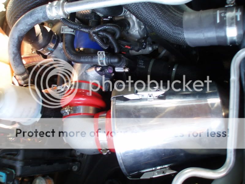

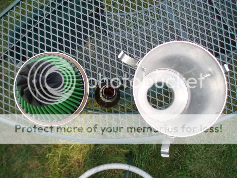

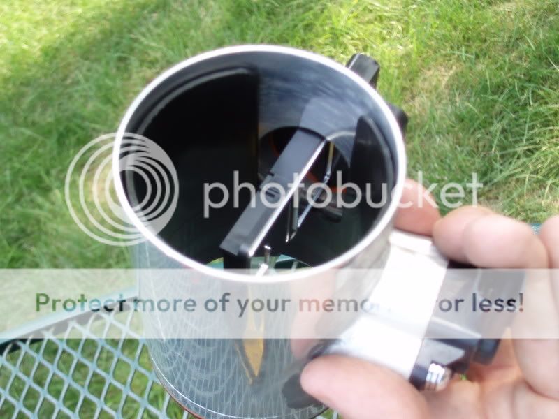

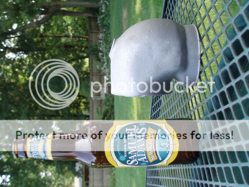

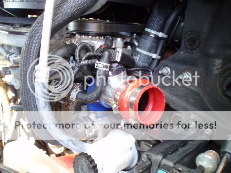

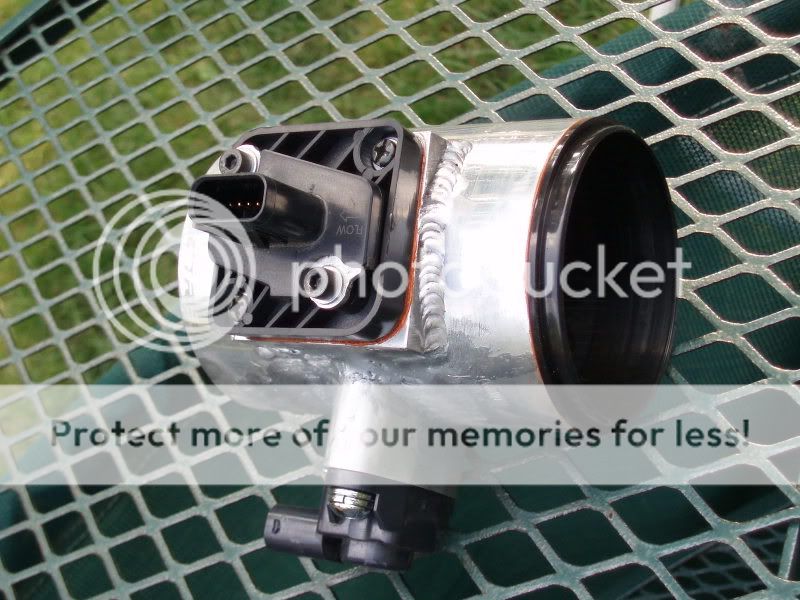

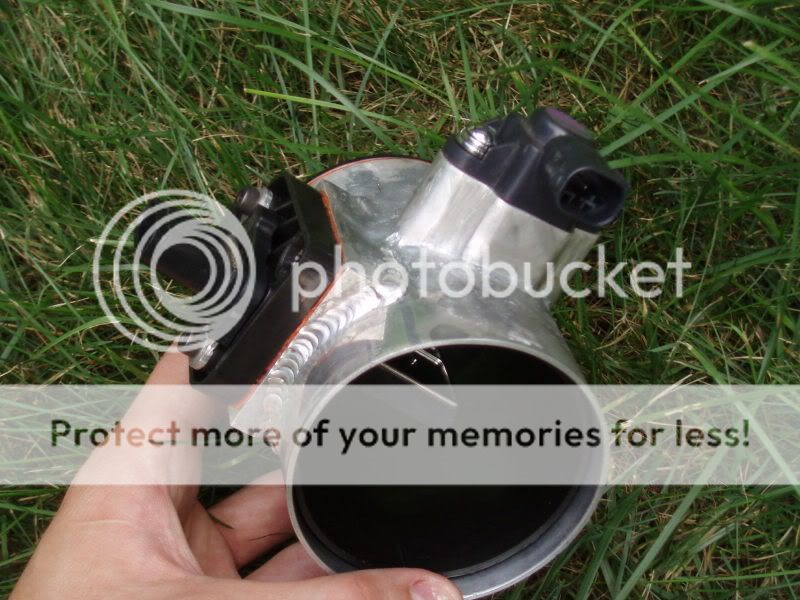

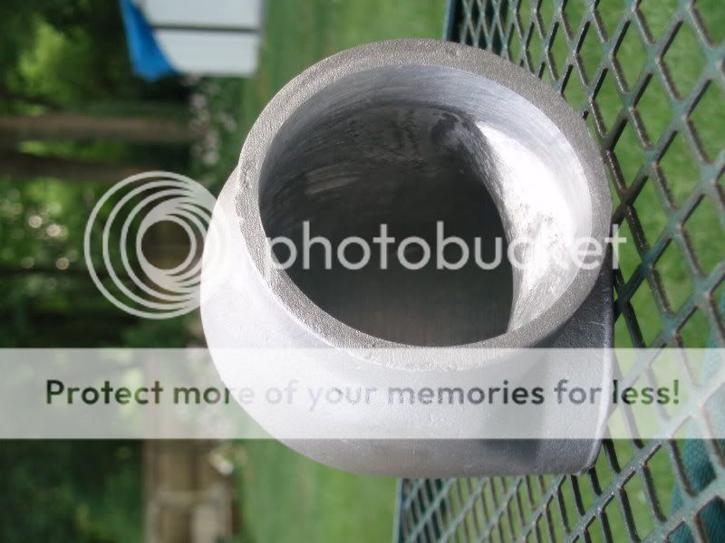

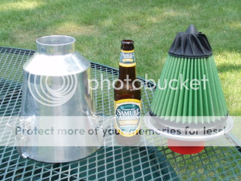

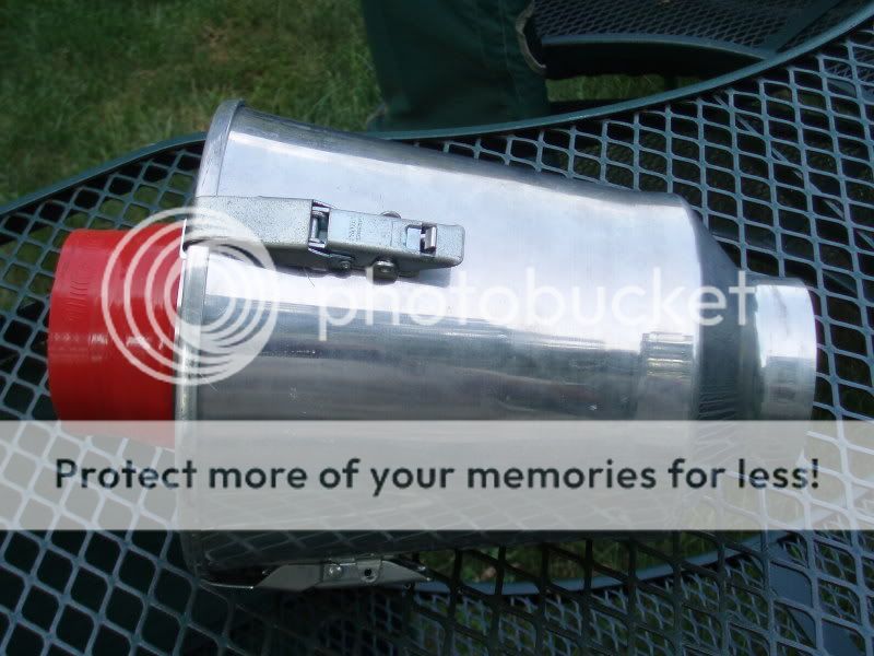

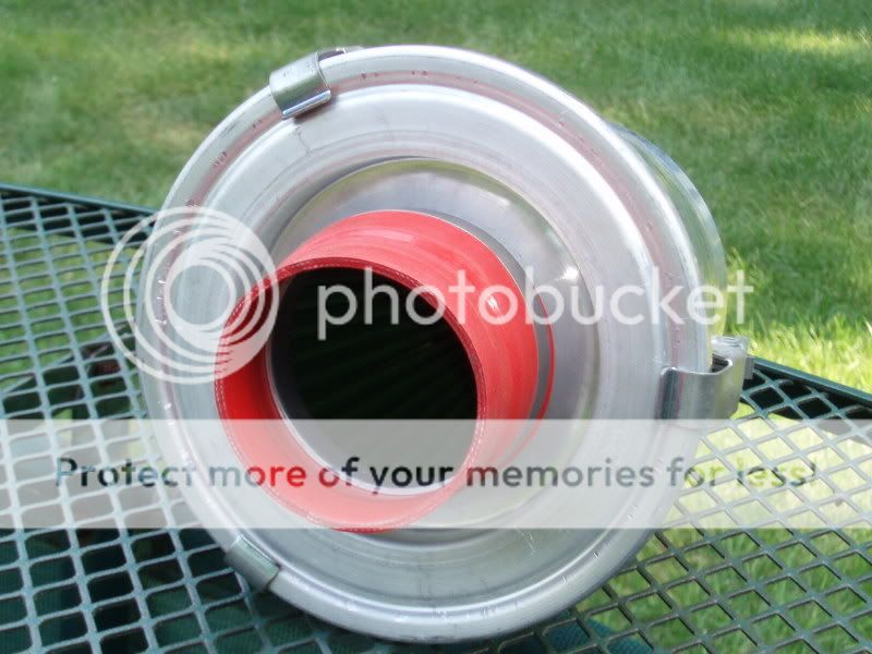

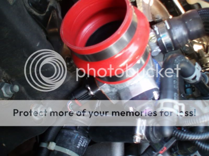

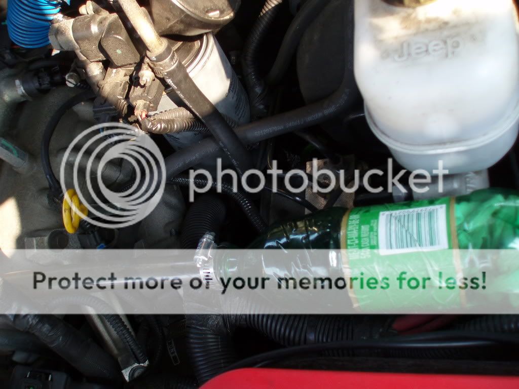

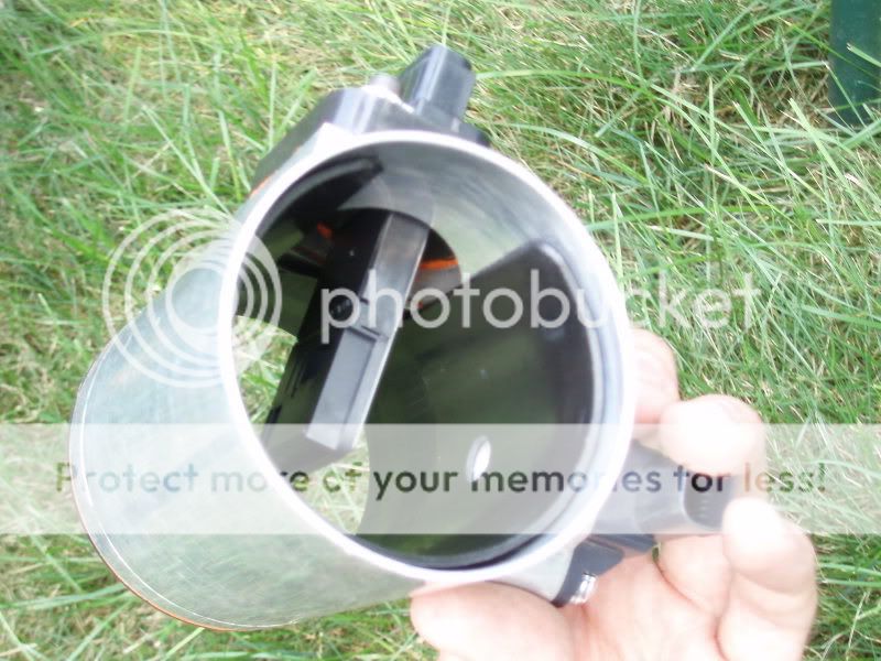

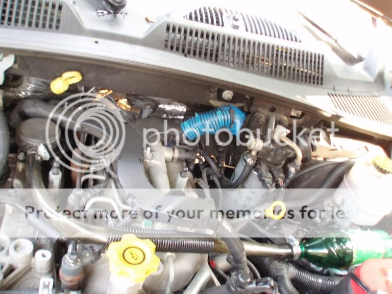

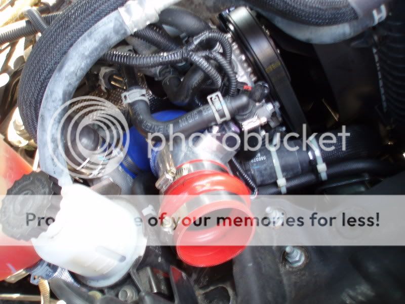

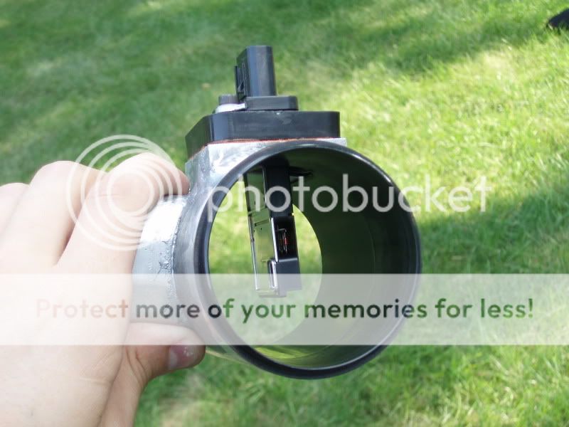

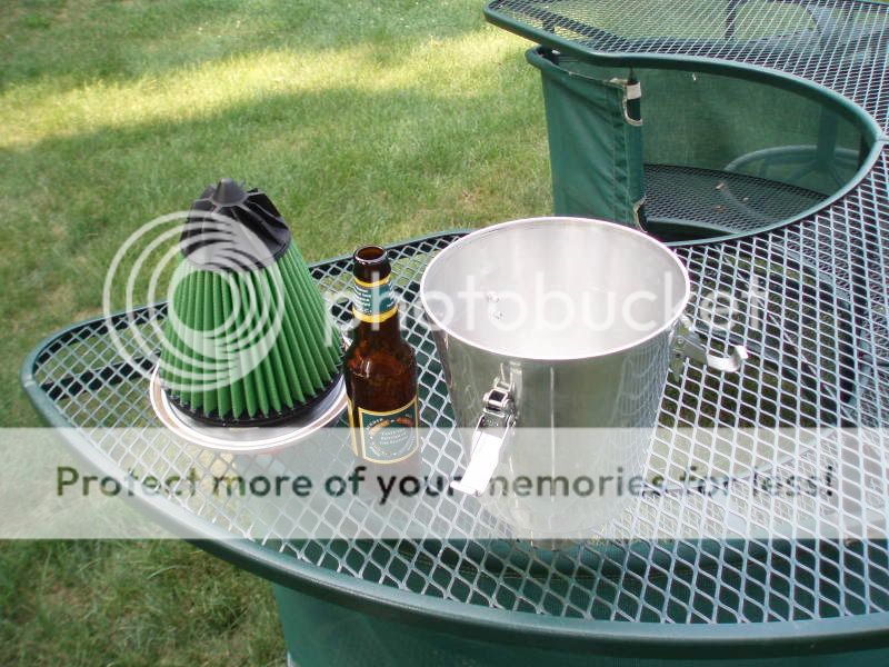

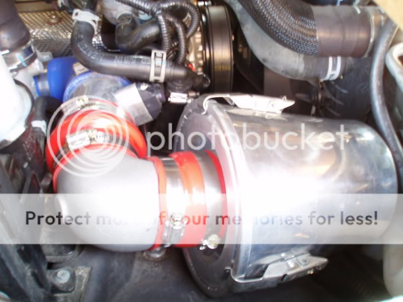

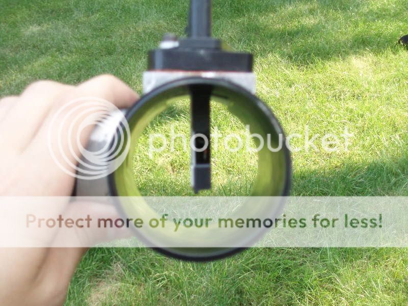

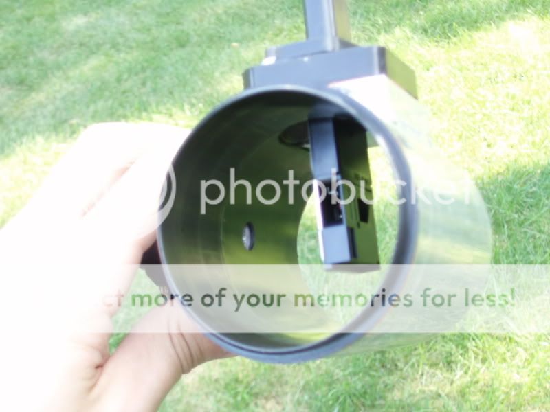

I disassembled the intake to test for leaks and took a bunch of pictures while it was out. Maybe somebody can look at the pictures and setup to help diagnose the reason for the P0101 code.

Looks like there are two things that may be your problem.
First, your Mass Air Flow Sensor looks to be at a different height from what it looks like (from stock to the airflow). If it is at different height it will affect the calibration.
Next on your EHM or crank case breather, you show it going into a pop bottle. Is there any way for the vapors to get out? The engine does have to breath through this hose or you will loose some oil seals somewhere.

Its difficult to tell from the pictures but there are holes in the soda bottle.
I am awaiting a catch can to become available at my local parts store as a more permament solution.
Thanks, that's a great point; I never noted the stock protrusion depth in the OE configuration. There are really no provisions on the aftermarket MAF section for changing the protrusion depth. If the height is significantly different from stock, than I may have to get creative. I would have to remove the plastic intermediate adapter plate and fabricate a slimmer one.
I am going on vacation thursday morning to Aruba and will take some measurements when I return.

It’s hard to tell from the picture but if you are using that clear type of hose for the CCV vent, DON’T!! When it gets hot, it collapses. Especially at any bend (like the one in the front of the motor). (Don’t ask me how I know).
Also remember that the CCV hose (about ¾ inch ID) was a free flow into the intake of the turbo. Your soda bottle with the little holes in it, will it freely flow the same amount?
If your worried about a “Catch Can” setup, one could always take an old mayonnaise jar, and since it has a metal lid (or use a pickle jar), you can solder in two 5/8 copper fittings (3/4 inch OD) into the lid. Now you have an “In” and an “Out”. Now you can take the out hose and stuff it under the Jeep somewhere. No greasy mess.
