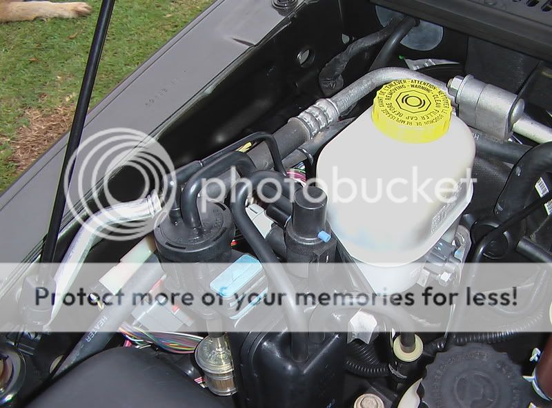

The ECM is on the right side looking from the front and there are about 3 connectors on the left hand side next to the airbox.
I have disconnected the main unit on the right but not the connectors on the left hand side or the one on the gearbox. I'm not sure where the connector is on the gearbox either.
Let me explain what happened, tried to start her and she turned over twice and then gave the battery flat click click. Cluster lights were on and radio were on so the battery wasn't dead. I then jumped started her from a GC
and then i noticed that she had thrown an error when pulling off. On the way home, i switched her off and on about 4 times but the CEL would stay on. I'm just wondering if there was a power surge that may have blown something but then wouldn't the fuse blow?
[img][URL=http://s385.photobucket.com/albums/oo292/mackruss/?action=view&current=IMGA0794.jpg][IMG]
[/img]Image
[img][img]http://i385.photobucket.com/albums/oo292/mackruss/IMGA0791.jpg[/img]
[/img]Image
06 CRD LTD ( Euro )

Wow! That is a super-clean engine bay, if that area is any indication - ok, so no module
You'll need to get a scantool on it, as ECM may require reflash to de-confuse it - worst-case, replacement ECM, as that is a hard communication error over the PCI buss, servicing the TCM, ABS, BCM, and ECM - thus, the hybrid label for the KJ CRD's

BTW, Mackruss - excellent pics, very revealing:
Folks, there is the elusive turbo controller, replete with solenoid-operated vacuum regulator, filter and reservoir
Also, observe and weep, for there is the clearly-exposed DCJ part number for the mystical and legendary Euro ECM, configured for manual transmission service - P56044773AD - ennybody wanna lose their 545RFE?
