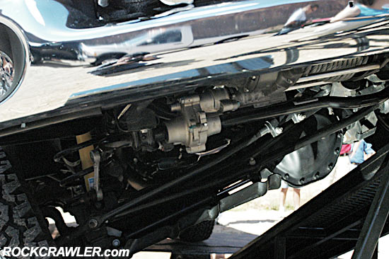

A post in the Newbies section got me to thinking, a few new trucks use an electronic sway bar disconnect system. I know the new Wrangler Rubicon does, and I also found out via Google that the 2005 Dodge Power Wagon does too.
...you control the disconnect from a switch on the dash. The switch has two settings - On-Road and Off-Road. If you put it in Off-Road, it disconnects the front swaybar. Re-engaging the bar can be done in three ways: switching back to On-Road mode, driving over 18 mph, or switching to 2WD or 4HI.
I'm guessing it's the grey box thing in this pic;
I wonder how easy it would be to get one of these boxes as a spare part from Dodge and fab it up onto the KJ. Presumably you'd have to cut your sway bar in half? What would be cool is if you could wire it up so that it disconnects when you engage Low Range (just tap into the switch that activates the dash light!) and re-connects when you go back to another mode.
Anyone got access to a Power Wagon to know how this thing works?

Turns out the Rubicon and the Power Wagon use the same disconnect module. It's the SmartBar developed by American Axle & Manufacturing, Inc. There's all sorts of spin about "microprocessor controlled" and "24,000 lines of code", but I imagine all that's to do with the decision to connect or disconnect automatically. I would think that the actual modul itself would be relatively simple.
We just need someone to write-off a brand new Power Wagon so we can find out!
