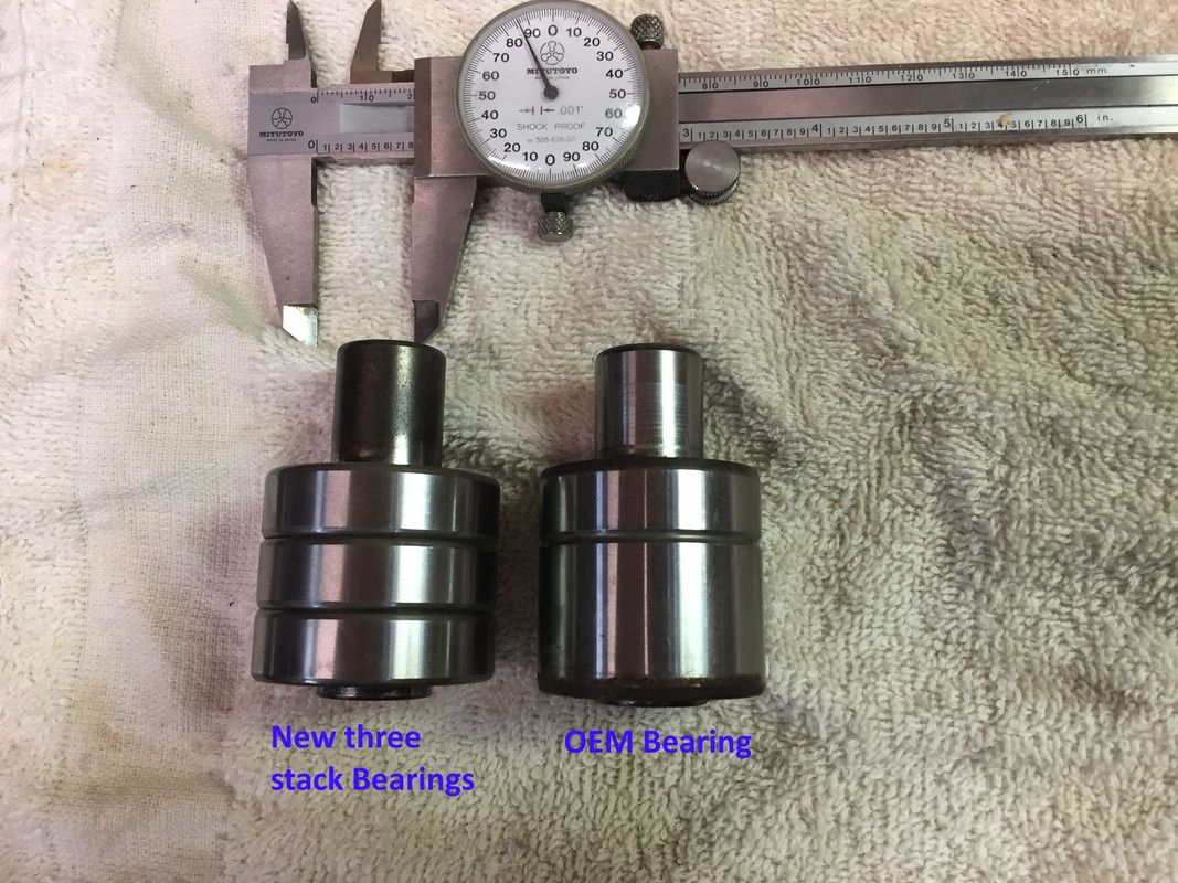

Some notes on today's progress:
Cut one of the OEM bearing in half, discovered the front bearing is actually a roller bearing and the rear bearing is a ball bearing. See 4 pictures below.
Using the OEM shaft, I was able to press the new three bearings onto the OEM shaft. Perfect fit!
Added (drilled & tapped) an additional set screw like the OEM one in the housing to help hold the new bearings in place in the housing.
All that's left is to get the housing machined out to press fit the slightly larger new bearings. Less than 0.5mm larger OD difference.
Getting close, what do you think?
Side by side of new bearings vs OEM bearing.
Picture of OEM bearing cut in half showing internals.
Picture of new bearing stack on top of OEM fan hub.
New bearings vs OEM bearing looking down from pulley end.

One small question ~ What stops the shaft from moving in the bearings? Is there a lip at the end?

The shaft is pressed into the bearings, it is a press fit! But I do plan to add a lock collar on the front side as a safety and spot weld a ring on the back end of the shaft so the shaft cannot move in either direction. Just to be super safe. I am a firm believer in over building.
I have ordered an adjustable reamer to ream out the housing to allow the slightly larger bearings to fit.
I will post some pictures once I get all the parts and components together and get one fully assembled....
On a side note, I have looked high and low and researched looking for the exact bearing that is used in the OEM housing to no avail in this part of world.
Found some close matches overseas but nothing having a perfect match.
It is called a waterpump bearing and it has one set of roller bearings on the front end and a set of ball bearings on the rear or back end of the shaft. The shaft itself is the races for both bearings. The only way to get the bearing apart is to cut the outer shell off. :banghead:
The shaft is 20.00mm and the outside of the OEM bearing is 40.00mm
If anyone knows or can find one of these oddball bearings, I am ALL EARS!
