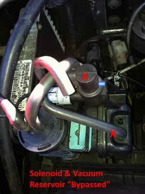

Did manage to bypass the turbo vacuum actuator to see if that made any difference, which it didn't. Not considering that to be a potential cause for now.
Did you bypass the one with the little air filter, or the other one with the blue nubs? The one with the air filter is the vacuum modulator, the one with the blue nubs is a vacuum solenoid. The solenoid is a popular failure point, and is completely useless of a part - it closes to seal off the vacuum storage box so that the turbo is maintained with vacuum energy even when the engine is off. Why this matters, I haven't a clue. But when it dies, it frequently gets stuck closed, and the turbo gets no vacuum so you get no boost.
You can bypass that very easily - pull the supply hose from it and connect that directly to the vacuum box. The sizes are a bit different, a small ziptie can help as a "hose clamp" here for the test.

For reference and as a test, this is what he is talking about:
Connect hose "A" to position "B" as shown in second picture. This bypasses the vacuum reservoir solenoid and the vacuum reservoir.
The vacuum solenoid has a history of failure.
That's exactly the method I used, but it made no difference.
