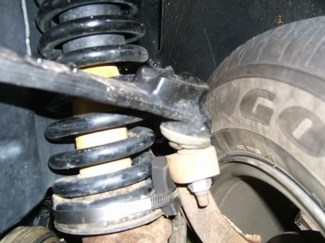

Ive always wanted to do bigger clevis lift but couldnt without getting UBJC. I finally got some free time and brain stormed alittle, this is what I came up with:
If anyone knows anything about a coal prep plant, this is used on the screeners to keep them in place:
Alittle time with a hack saw and I made these little guys:
I need to do alittle adjusting but I think they will do just fine. One of them gets pushed between the coils so I will have to keep my eye on that one. Im just worried one will come off and I wont know about it. It only take ones time to destroy the UB boot and I cannot afford to buy any new A-arms.. :?
What do you guys think?
Im going to add more conduit washers either tomorrow or sunday, ill be sure to post pics and measure how much more lift I get... Not to sure if Ill add one or two more washers.. What do you guys think I should go with? 1 or 2? I already have one in there..

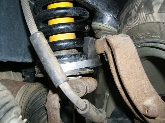

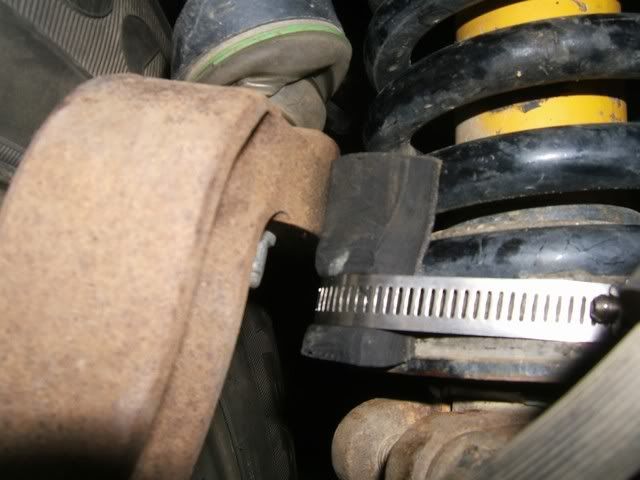

PostPosted: Fri Oct 20, 2006 6:54 pm
Update:
I worked on it alittle more and Im not to happy with them. If the suspension is at full droop and you turn the wheel, it just pushes them out of the way. Does this happen to people that have the franken lift with the old style bumpstops? Maybe if I made them aliltte wider and taller they will stay in place better?
You can tell its pushed to the side:
Those balljoints take alot of crap! Look at that boot!
Ill work on it again tomorrow.. Ill probably just make them wider so they wont get pushed to the side like like..

Make them taller and wider. It looks like in that last pic that the boot may be torn already. Could be the angle of the pic though.

No, not torn. Ive not done the clevis lift yet so nothing could of caused a torn boot, yet.. :wink:

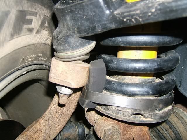

I dont know where to start looking for the polyurethane? Me dad and I worked on it some more and made them much bigger. Im going to leave it alone for awhile with no extra cleavis lift to see if they stay put. Since it limites the downward travel some, they get hit before the strut maxes out. Hopefully they will take some good hits on the hw and Ill get to see if they will work.. If they do fail, then my balljoints will still be safe since the strut will still catch it.. Then Ill add some more washers.. :wink:
Those pipe clamps are not very strong.. I already broke one.. :wink:

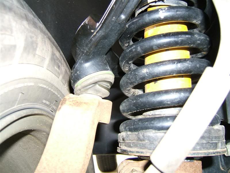

PostPosted: Fri Oct 27, 2006 10:18 pm
Bernardio wrote:
Maybe you can cut a recessed area for the band clamp to fit snug into. That way the band clamp will have a better hold on the stop and shouldn't rotate as easily. Also, are the OME struts that much longer that the stock struts that we need to worry about UBJ contact? I did about a 1/4" clevis with the stock strut and didn't think the UBJ was very close to contacting the spring. How much longer are the OME struts compressed/extended anyhow?
They do not seem to be much longer.. Im very confused by all this b/c most people do a clevis lift without thinking about it.
The reason im confused is b/c of this pic which i took myself:
I know ive got the ome struts b/c one, eddo sold them to me and two, they have the part # on them and ive matched them up..
Here is the upper balljoint with one conduit nut:
But get this, here is the other side with one conduit nut:
I know the spring is turned some, but it still doesnt look like its as close at the other side. There was barly an 1/8in on the other side, if that..
Ive not taken one with the second one added..
Anyway, Ive put around 200miles on it since adding the bumpstops and the extra conduit nut and all is well. I checked them out today and everything is fine. Many bumps and dips to max the suspension out, seems to be working just fine. :D
PostPosted: Sat Oct 28, 2006 8:39 am
Posts: 1626
i think it's just because the spring is turned.
PostPosted: Sat Oct 28, 2006 9:24 am
It may be. I guess its just an optical illusion(is that the right word?)..
Either way, everyone else can do a good sized clevis lift. I wish I could of just turned the other spring.. :? I didnt like the angle that was on the balljoints at full droop anyway. The bumpstop helps that.. :wink:
