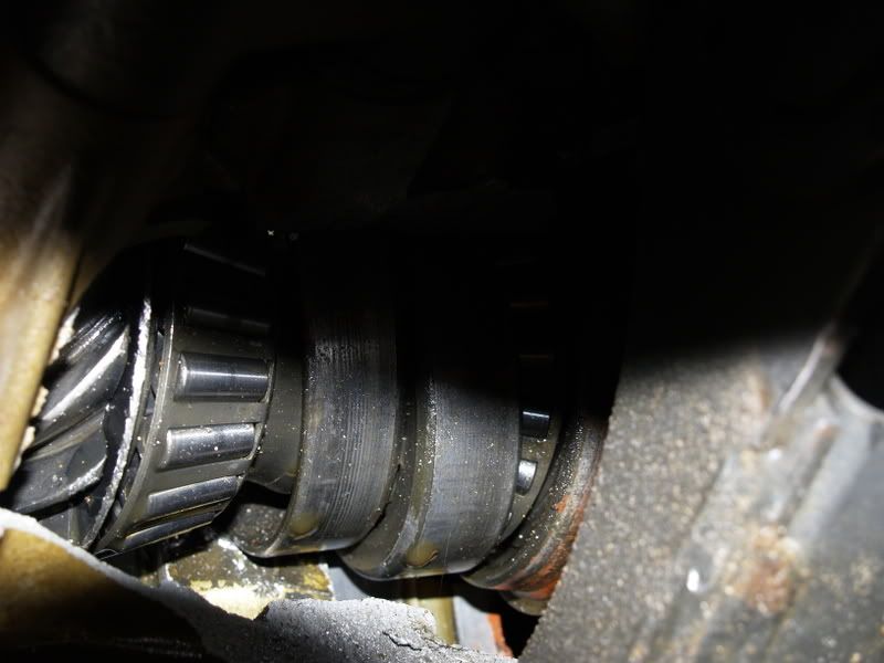

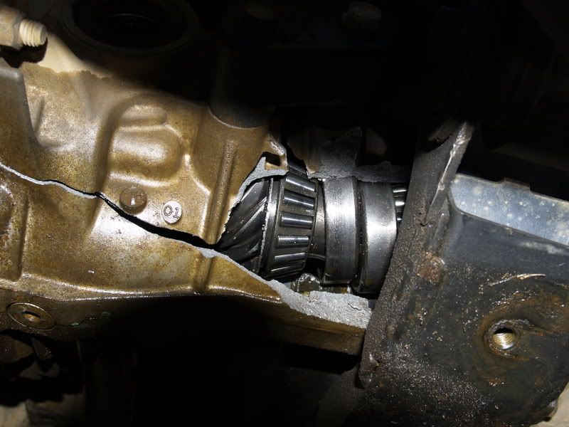

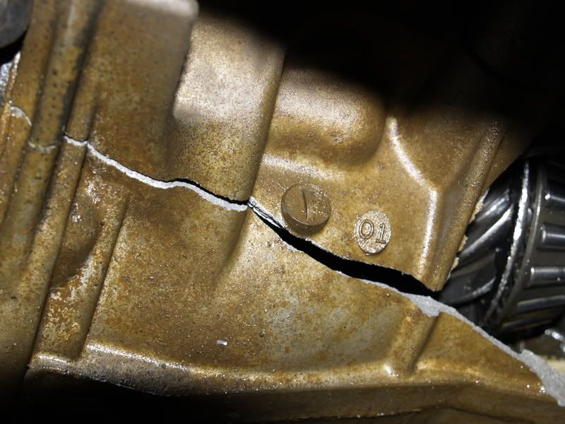

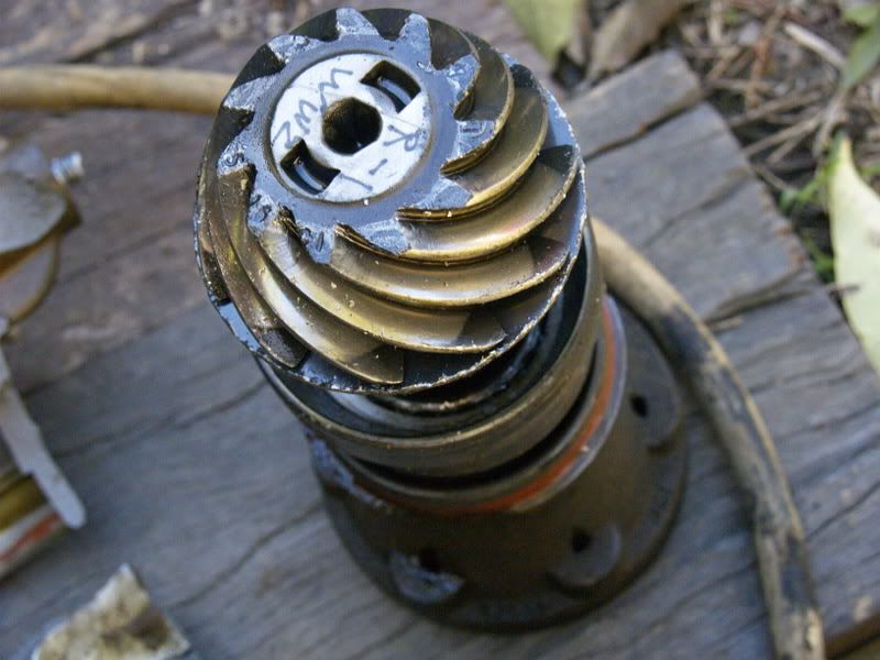

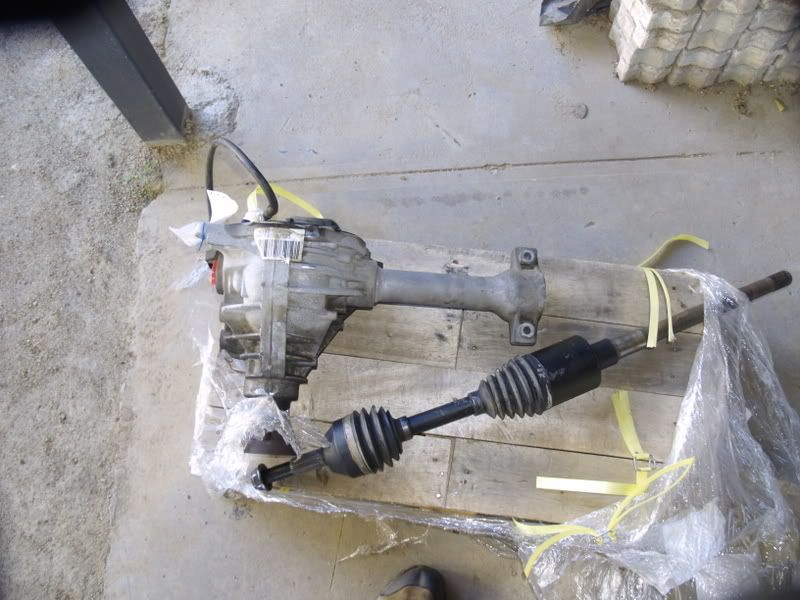

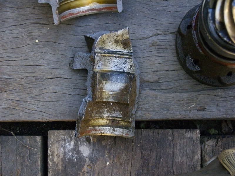

 Post subject: lots of picks
PostPosted: Sat Aug 16, 2008 7:59 pm
Posts: 2210
some picks

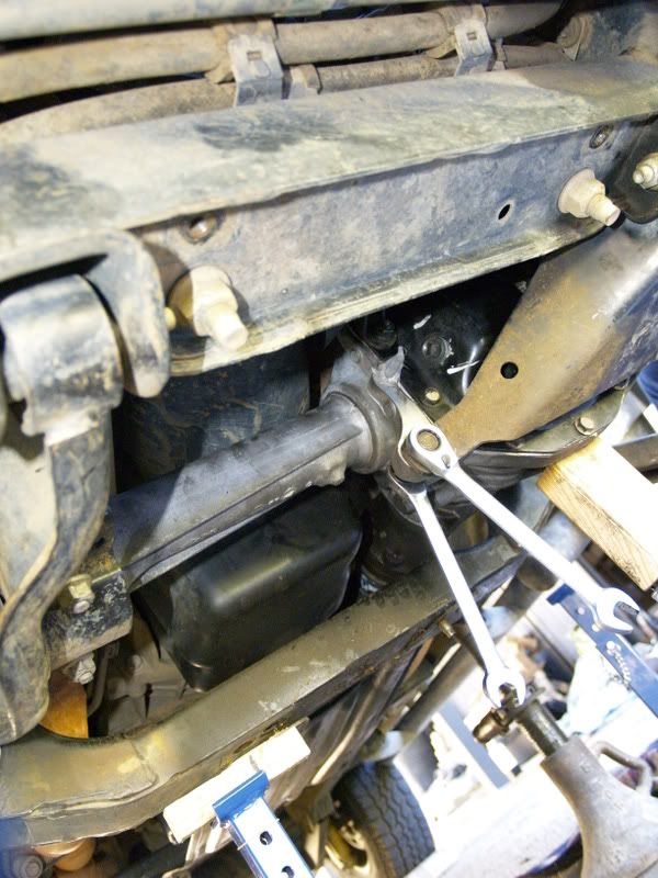

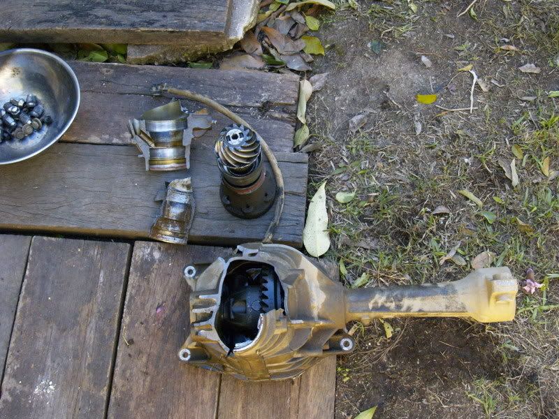

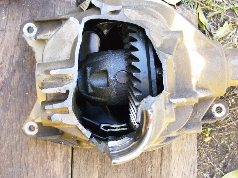

team jags Dana 30a with internal veiwing portal

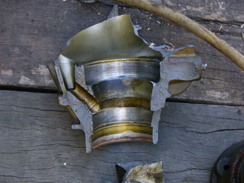

cracked eh
the bits that fell off while we were unbolting the front diff

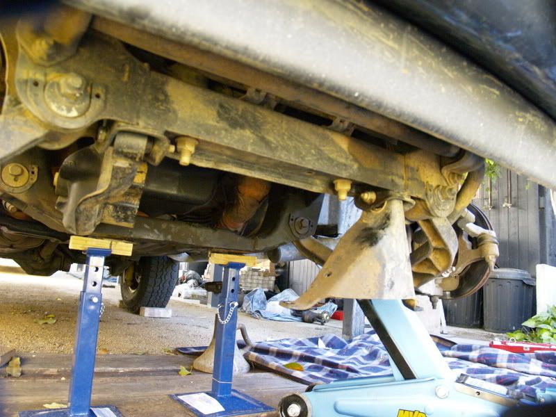

the end reult
no diff no shafts
the new bits
bolting it back up
yes they are magic spanners
the end result it took most of the day as we had not done a full diff replacement before but it went smoothly the KJ survived a 80 k trip home with no clunks crunches or other front diff issues

Well done lads. By the look of that old one I'd say one of those collars around the pinion casing might be a good idea.
