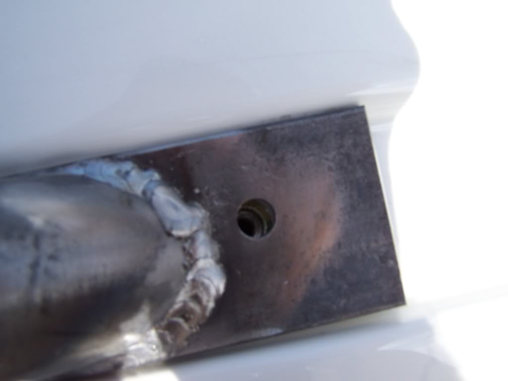

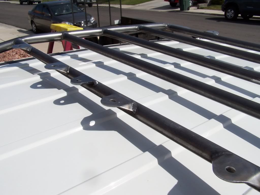

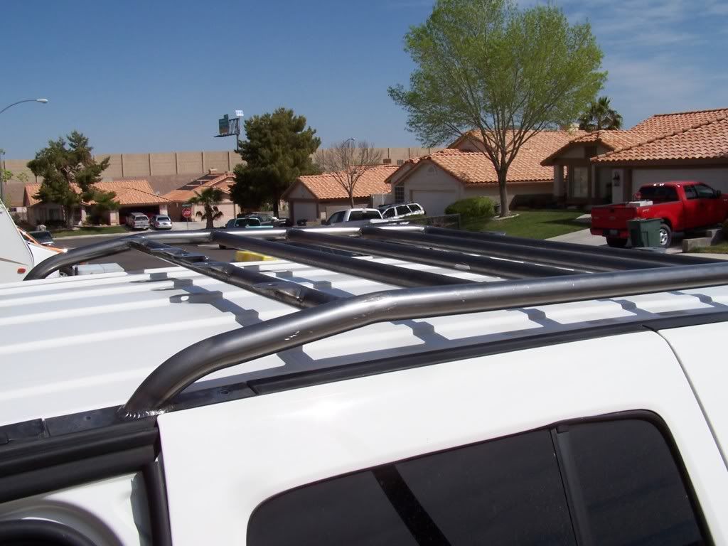

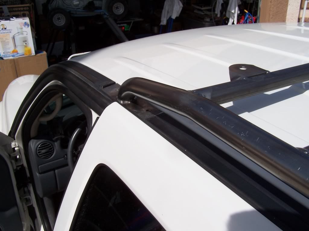

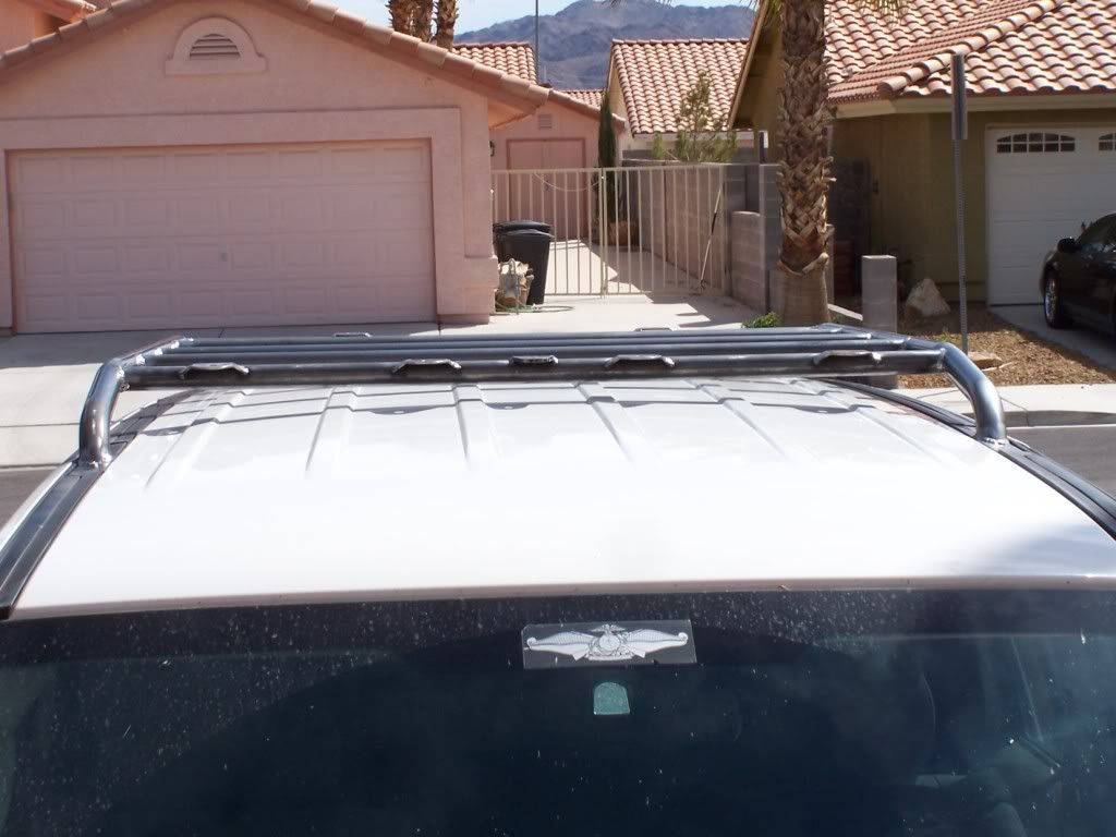

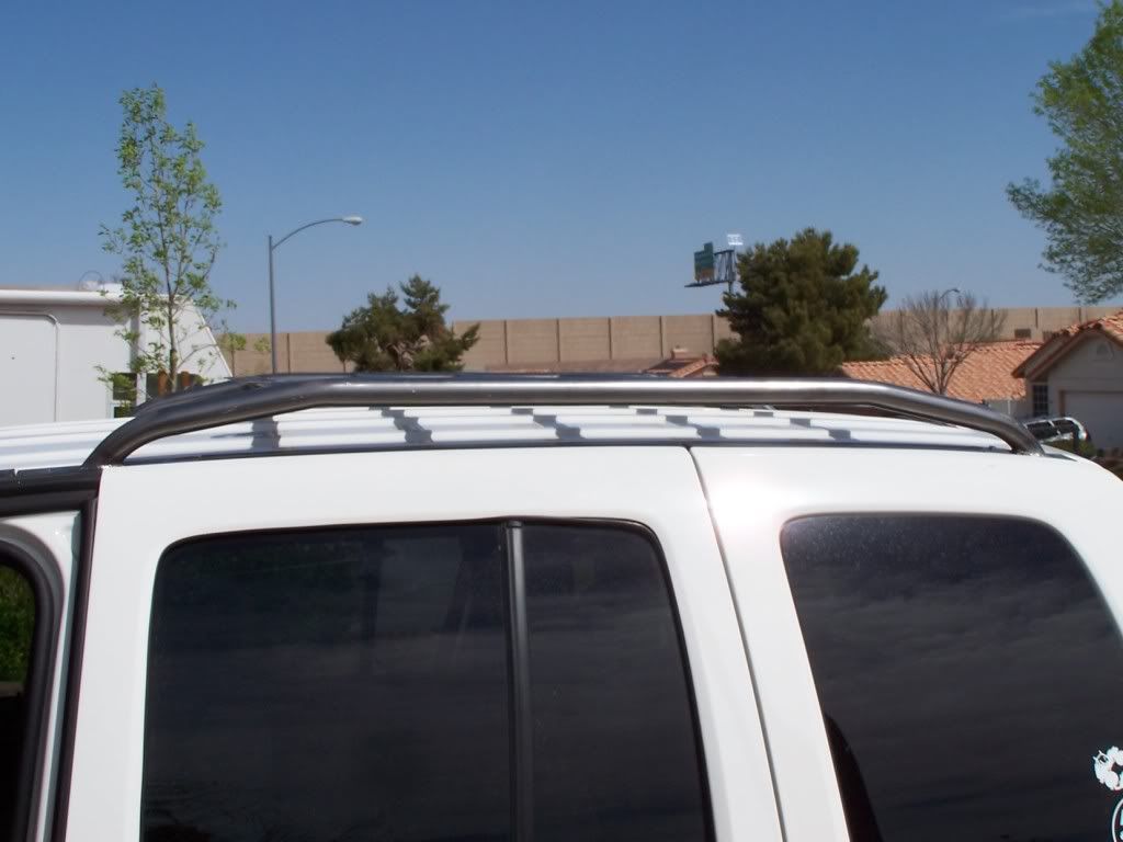

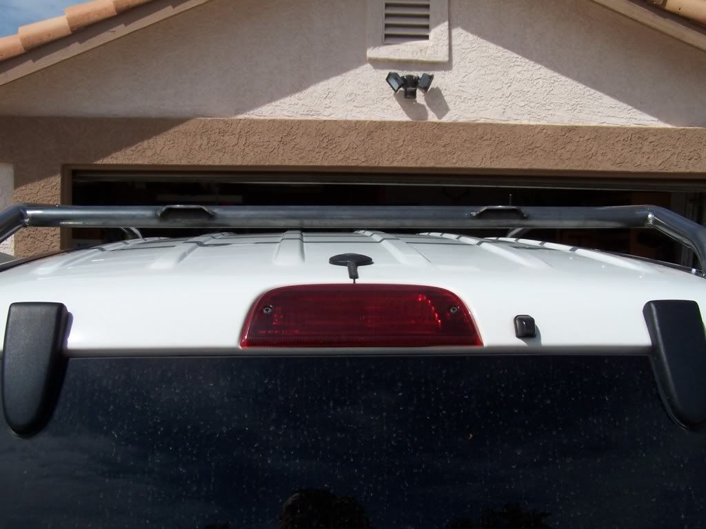

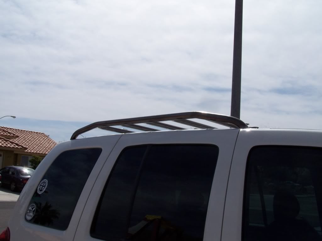

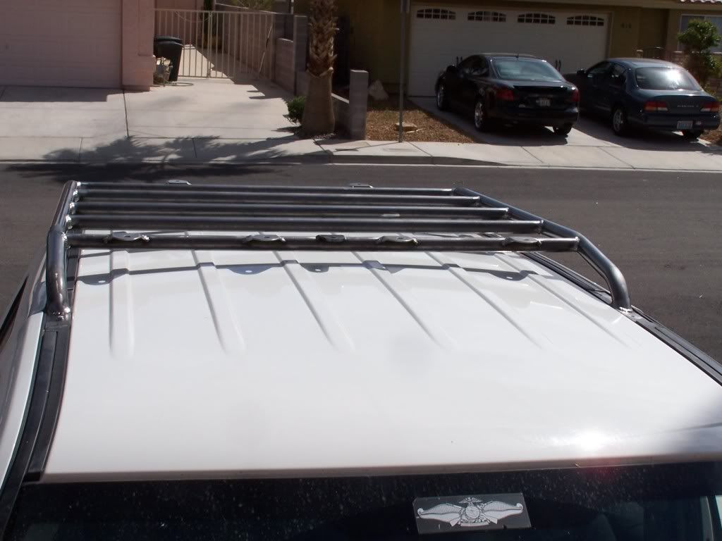

Just checking the fitment, had a few issues with the the holes lining up, but an easy fix. well be painted tomorrow

Looks real good, of course not as good as my RL Gecko but........ :wink: :lol: :lol: :lol: :lol: :lol: my holes were a little off as well, not much just had to reem them a little.
Putting any lights on it?
Tom
PostPosted: Sun Mar 29, 2009 8:10 pm

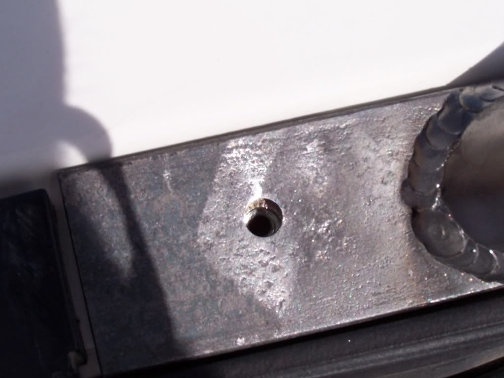

It seems those dang nutzerts are a bit off from KJ to KJ,the holes on my Gecko rack lined up just fine and they all have been built on the same jig.I can't remember who's roof got chosen for the jig measurements.
Posts: 2133
Location: Sin City USA
Tom
I was trying to reem them in too, but there wasn't enuff room. I think im gonna have to make the holes bigger. I can get 1 bolt on every side perfect, and the drivers side front I couldn't get any of them in with out them going in at a bad degree/angle, was worried id screw up the nutzerts. so that side will definitely have to be made bigger. As far as lights yes, just deciding which ones to get.
2016 JKU RUBICON
other mods coming soon...
PostPosted: Sun Mar 29, 2009 8:38 pm
Looks slightly bent upwards. I wonder if you bend it down a little, it may fit.
PostPosted: Sun Mar 29, 2009 9:14 pm
Posts: 2133
Guess I need to break out the BIG hammer and give it a few whacks....
2016 JKU RUBICON
PostPosted: Sun Mar 29, 2009 10:50 pm
or a little bit of dremel or di-grinding would do wonders :)..

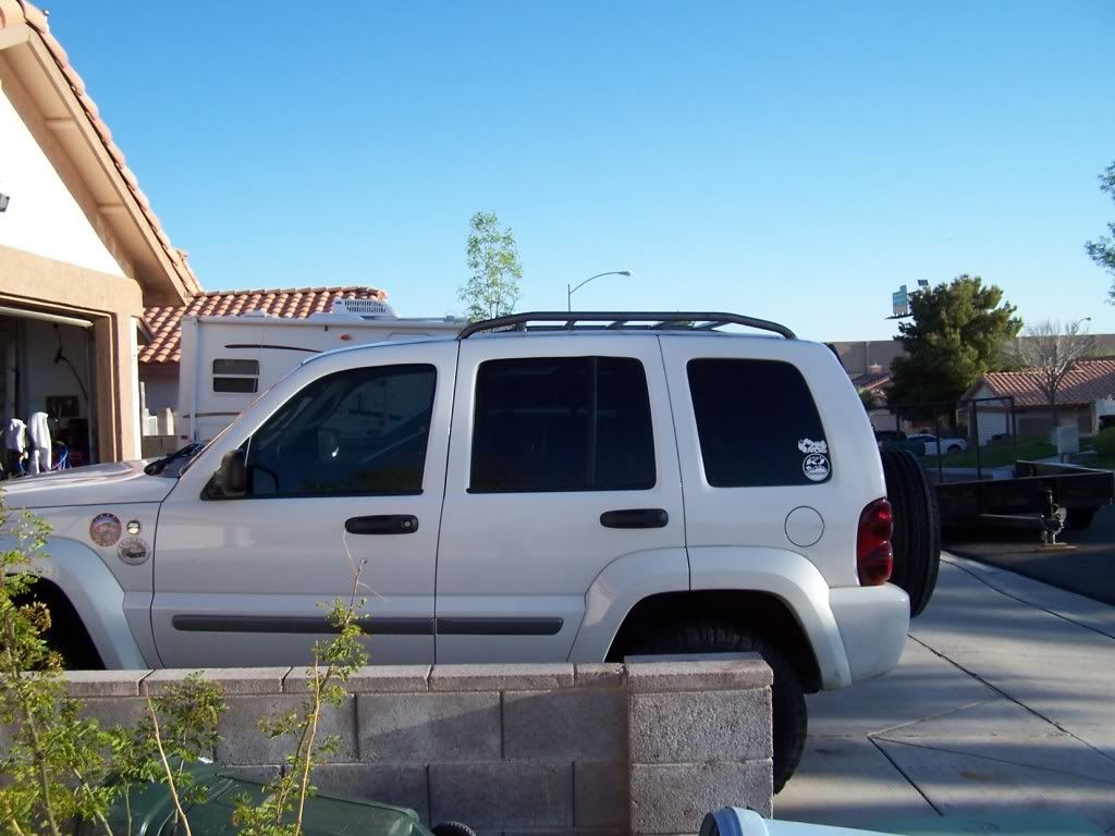

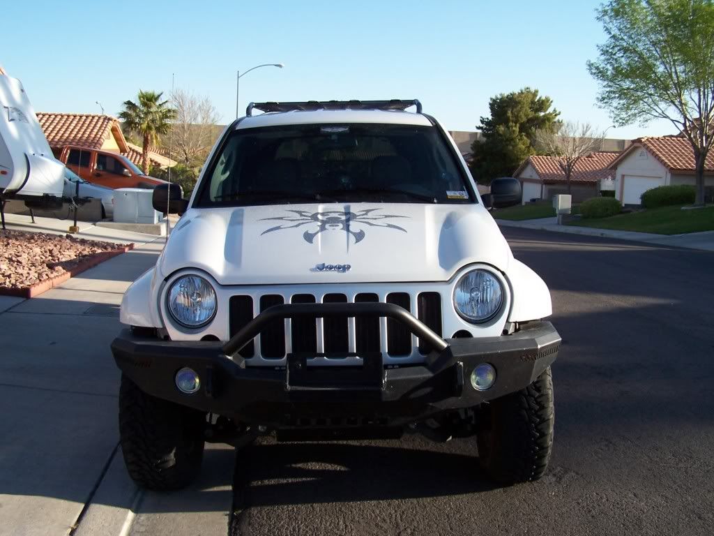

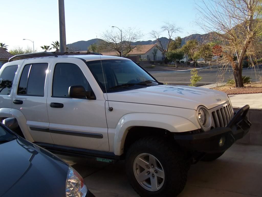

can we get a pic, a little farther away, of the whole jeep. also how are you painting it?
PostPosted: Mon Mar 30, 2009 1:41 am
Posts: 2133
Ill ill take a pic tomorrow. Im getting it powdercoated.

I think those holes being off are going to be a universally random problem with anything rigid being put on the roof's of our KJ's. I've got the same concern with the rack I'm building to my roof. I guess the only thing you can do is die grind them into slots at the time of the fitting. Hopefully everyone has a tool to do this but I bet some won't.
I bet everyone will have to make some adjustment, and some will have to make adjustments to most of the holes.
Anyway, sweet lookin' rack, congrats!
