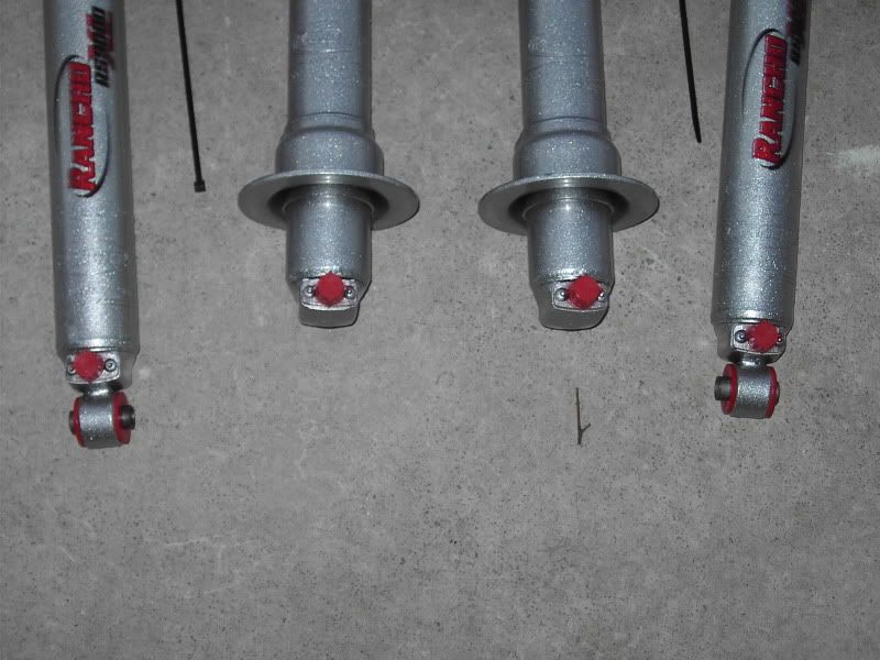

the fedex man has just delivered my rancho 9000's
shiney and silver
i should have them fitted soon
i used the liberty front strut and the durango rear shock combo
RS999764 front strut
and the
RS999248 rear
here are the details for those interested

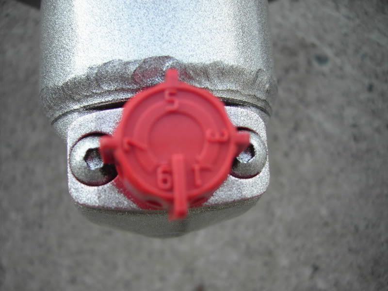

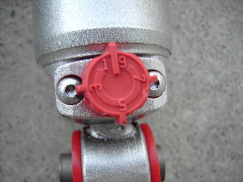

behold the silvery shinyness ( if thats a word)
bottom of strut
bottom of rear shock

Just wondering how do you get the clevis over that dial knob. Can you take it of?

If the struts are the same as the shocks the knob itself doesn't come off, but the entire adjustment plate that you can swap out for the remote control system does. Good to get some practice now, since if you like to play on the rocks it's only a matter of time before you break a know on a rear shock!

Thats the same combo I have for 10 months, with a Daystar lift, very good and very satisfied with it, the struts came with the knob off, and you have to install the struts and only after then you have to put the knob. I would like to get the OMEs and cut the daystar to make my own frankenlift., may be next year.

no the adjuster comes off for installing on the clevis, when everything is back together thats when you reinstall the adjuster, i have a 6mm prado front packer as a small clevis lift on the front , you shouldnt have any issues with the settings, you dont need to order the myride its just easier that getting under the truck to manually set them

photo 1 by denvergrows, on Flickr
And the only ones I can find to order look like this...
It says this is the one for the front but the picture isn't what I have. Is it just a generic picture or am I going to have to have them modified to work?
