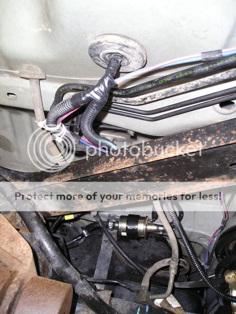

Posts: 3554
Location: Aurora, IL
How I did mine and it is still going. I used one of the Skid Plate threaded mounting holes:
Rubber Isolation reduces the thumping noise the Solenoid type pump creates. The GM 6.5L Turbo had a good isolation system, but the Liberty is challenged for space.

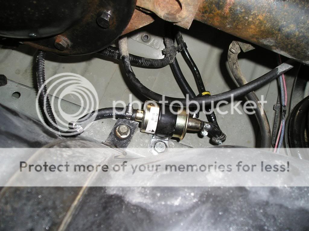

Posts: 553
Location: Chico, CA
Here's mine using the battery tie down bolt for a mount. I used isolation mounts and stainless fittings from mcmaster Carr.
