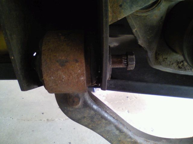

I took the Jeep in for an alignment, It was way out. The front tires are cut bad on the insides in just 4,000 miles
The Cam bolts stuck in lower control arm bushings on the front of the Jeep. So the alignment can not be adjusted.
I am going to try to press them out. I am worried about damaging the area around where the cam makes contact. Like the rest of the Jeep it does not seem very heavy duty.
Any ideas would be appreciated.
What are the best replacement bushings to buy? Or the best replacement lower Control arm?
I have heard that some aftermarket LCA's do not have the spot that makes the cam bolts work. Just flat surface.

Cut the bolts and drop the arms is the easiest way to do it. New bolts are only through the dealer and are or were 45-50 a bolt. The cam that adjusts your alignment is on the frame not the LCA. If everything is that rusted I'd just buy new LCAs and new bolts and swap them out.

I used a c-clamp style ball joint press to push the bolts out. It worked great. You let the hex head of the bolt pass through the hole in the end of the c-clamp and push on the threaded end of the bolt. (I installed a nut backwards to give more for the clamp to push on) I have included a picture of the bolt halfway removed. It will remove the eccentric washer that is pressed on by the bolt head. The bolt pictured is the passenger side rear bolt.
Thank you so much. I am glad I never got to the shed yet and started. That was the method I was going to try. But I thought the bolts were one piece, washer head bolts. I thought I was going to have to use one of the big hole for the washer head to pass through.
I thought I remembered seeing in one parts Fiche it being 2 pieces like your picture. But everywhere I have seen recently it only showed what looked to be a washer head bolt.
I even asked the dealerships I called this morning If it was 2 piece or a washer head bolt and they told me wrong.
I have a big press for my truck ball joints. If I can hold the thing up there to tighten it down. Might need to use a floor jack to hold it up.
My fail safe was to make a drill guide and drill the bolts out.
There will be lots of anti-seez or Kopr Kote involved in putting things back together

I have one bolt to finish removing. I would like to get a little heat on the head and then quench it with Sea Foam. Only hold up this morning is I don't have anybody to squirt simple green on the bushing while I heat the bolt.
I was able to get my big Snap-on press on 2 of the bolts and my little ball joint press on the rear right front LCA.
I was not able to get the press on the rear left LCA bolt. But I was able to get that one freed up with generous amounts of Sea Foam over a few day period. I got it out til it hit the front differential mount, Kopr Koted it and shoved it back in.

If you pull the rear bolt halfway out and completely remove the fornt bolt, the control arm will tilt (with the front down) and you can then remove the rear bolt by sliding it out the rest of the way.
