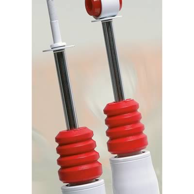

Hood, when i re-did my front Franki from stock CRD springs and Daystar spacers to the OME790's i also added a pair of Daystar EVS Bump Stops.
I have never seen those before, that is a great idea! are they something you ordered seperate? I already have extended bumpstops, but I don't think it would hurt to have those too.

clday25, those are slick...........................never seen those before, I reckon those would work.
