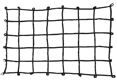

I copied this idea:
http://www.lostjeeps.com/forum/phpBB3/viewtopic.php?f=1&t=68997
but used cheaper net:
http://www.safaristraps.com/cargo-nets

Thanks, aregant! This gives me some ideas. Have you thought of a net right behind the front row?
I'm hoping that I'll be able o use this:
http://www.amazon.com/gp/product/B007CVSE30/ref=oh_details_o00_s00_i01?ie=UTF8&psc=1
I hope to cut it into sections so it fits.

I used the net with my all j cargo rack to keep the whole family safe on the big trips. If I do any solo trips I think a single net behind the seats would work great. I used nutzerts to atach the anchors so you could but the net about anywhere!
