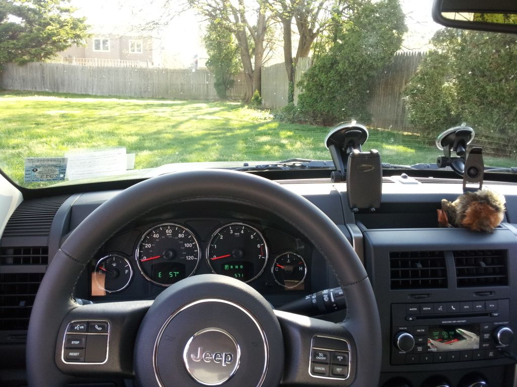

What I'm working with. Left window mount is for 7" Android Tablet, right is for GPS.(Yes that is a Chewie doll, he is my copilot)
Its important to have a good supply of wire connectors lying around for such an occasion

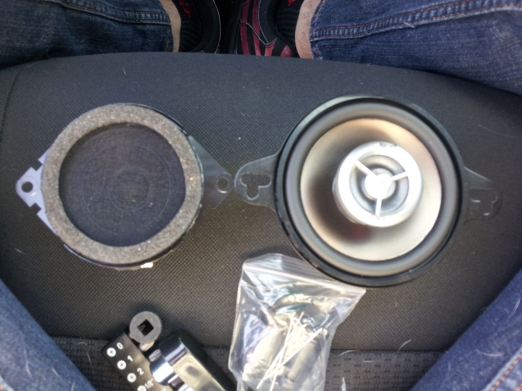

I chose the Polk Audio db351
The stock speakers are about 2" and are tiny as heck but I bet w/o them there would be no highs. They are def a joke next to the new Polks.
Most people have said that 3.5" do not fit in the dash and technically they don't. Some modifying is necessary.

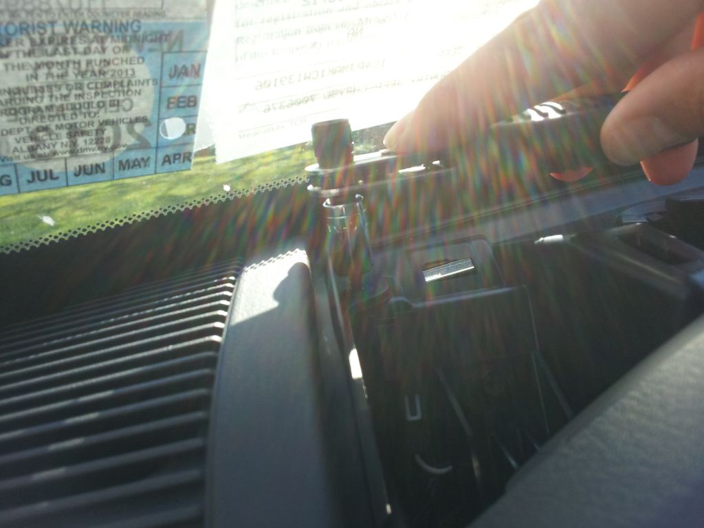

There is not a lot of room between the dash and window at the top so a small ratchet is probably a good idea.

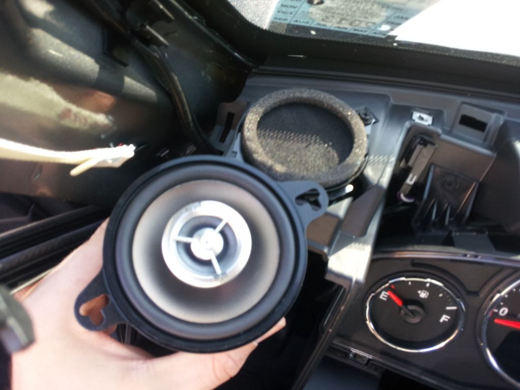

After the speakers were removed a little brainstorming was necessary.

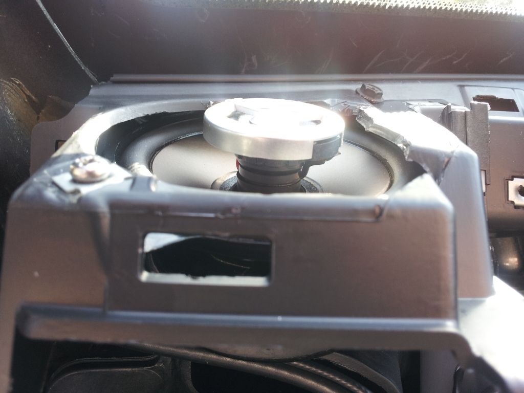

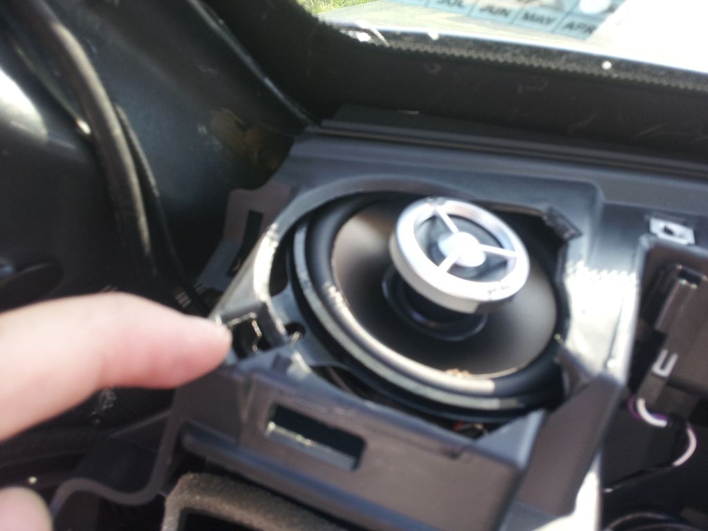

After seeing that the Polks were going to stick out too much I decided to try and cram them underneath

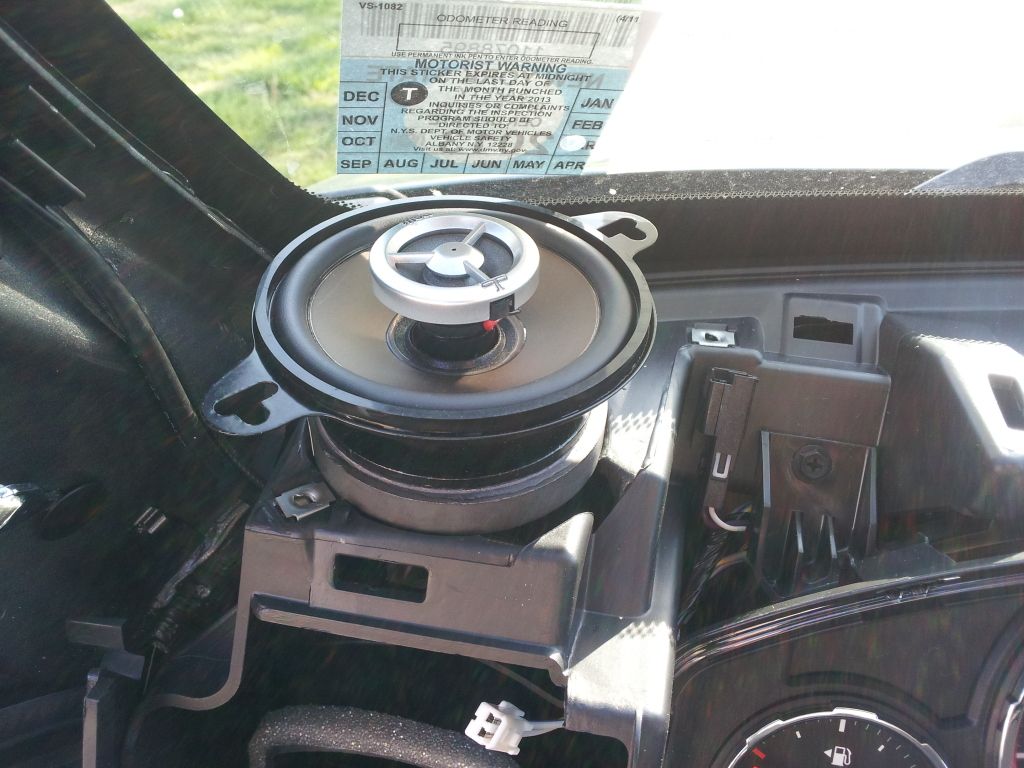

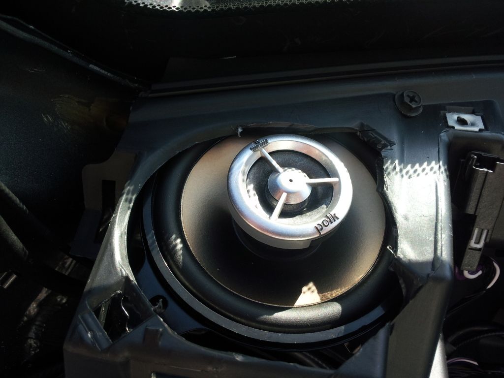

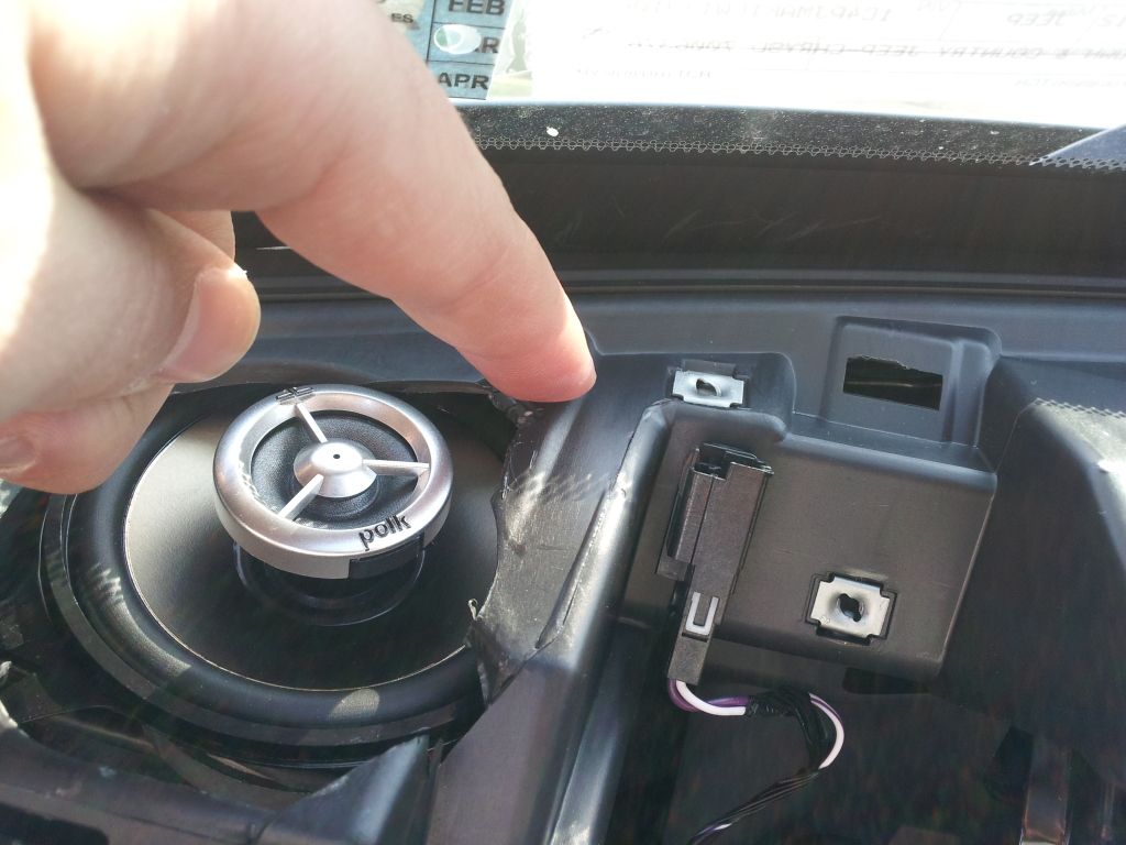

I had cut around the top to check for clearance and ensure there was enough. I used the stock screws in the back because the head is a little larger then the supplied screws. I pointing where I chose to put the new hole and screw
On the front I used the new screw and stock retainer with a new retainer below the speaker to keep it all tight.
The drivers side was pretty easy and not too terribly tight. Everything hooked up fine and sounds good there. On to the passenger side.

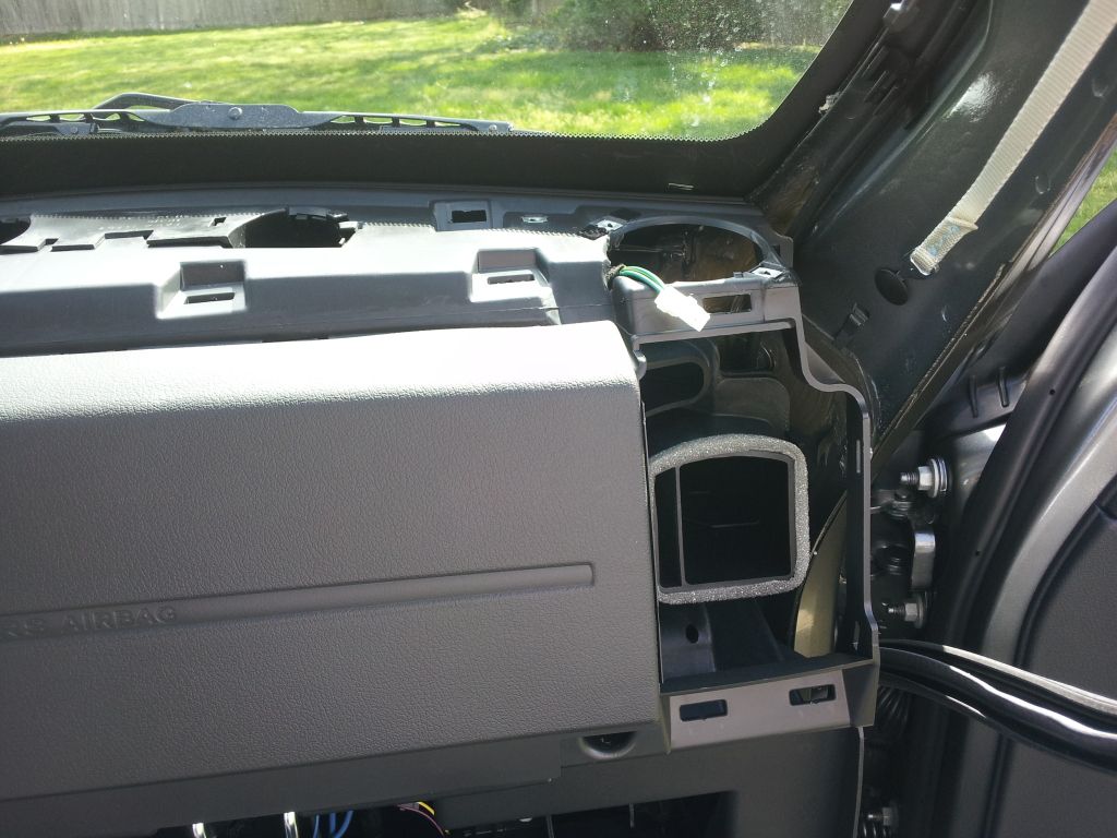

The glove box has a tab on each side that releases it to hang down freely. The top dash piece just pulls up.
Now the tricky part where I didnt get any pics, The air bag needs to be removed for clearance to the air vent area. There are two 13mm nuts on the underside above the glove box. On the top you need to remove the two bolts (13mm) attached to the body, then everything will just wiggle free. Everything else as far as installation remains the same, but there is a lot less clearance for moving around.

The only issues that should arise are clearance trying to get both sides of the airvent on but be patient and wiggle it back in.
With everything back in the volume at 15 sounds like it did at 20 before and it is much clearer.

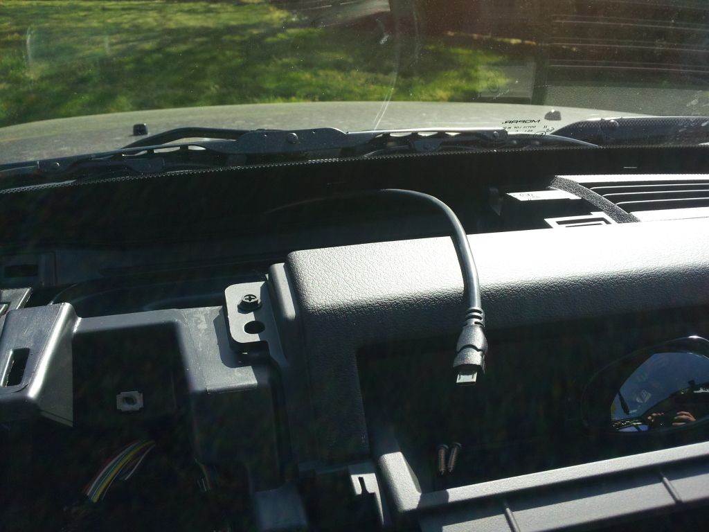

And a teaser of things to come.

getting an HD video head unit eh?

No that would be sick but its.USB power for all my.accessories. will post more soon

ah! i thought it was an HDMI cable for sure
