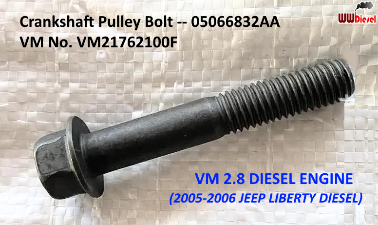

Hello everyone, it's been quite a while. I'm digging into the beast again, this time to replace a failed hydraulic lash adjuster. Having problems getting the crankshaft bolt out and want some help.
I know I discussed this subject a couple years ago, but I didn't find any discussion of "right-hand threads or left-hand threads" on the center bolt on the crankshaft, in the center of the harmonic balancer.
Here's the question: Is the big bolt on the crankshaft right-hand or left-hand thread? Anybody have knowledge of this?
I should be able to lodge a breaker bar on the bolt and against the frame, then crank the starter to break the bolt loose. However, if it's left-hand thread then I will break something.

PostPosted: Sat Apr 04, 2026 1:11 pm
Posts: 7400
Based on the images I found, it certainly looks to have normal "Right Hand" threads.
PostPosted: Sat Apr 04, 2026 2:40 pm
Posts: 721
Hi WWDiesel, it's been a long time. Hope all is well with you and yours. ...and happy Easter or Passover, which ever applies.
Thanks for your research and input. I didn't think of finding a picture of a new bolt. It does appear to be right-hand thread.
Dean.

PostPosted: Sat Apr 04, 2026 9:23 pm
Posts: 7400
Dean.
Hi Dean,
Yes, we had a nice Good Friday, celebrated Easter on Friday, went out with our children and grandchild and ate a nice meal.
Today, I stayed home and did a brake job on a Toyota for a customer.
As to the bolt, sometimes, I think outside of the box.
But yea, it sure does look like right hand threads to me!
