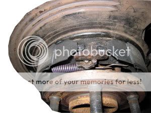

Here's one for you break experts - I want to set the parke brake on my CRD without removng the rim. Which way do i need to turn the adjusting screw without stuffing it up properly :roll:

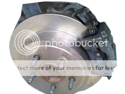

It's nice to be able to pull back on the reigns and have this mule actually stop again.
New brakes are a think of beauty . . .

Down is tighter up is looser
