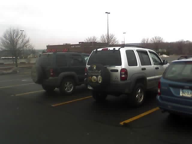

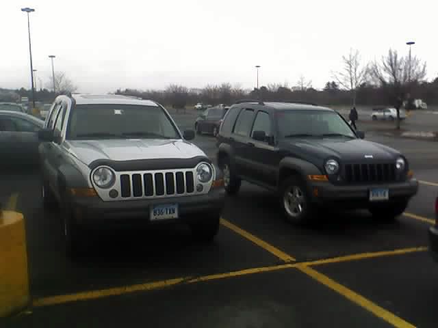

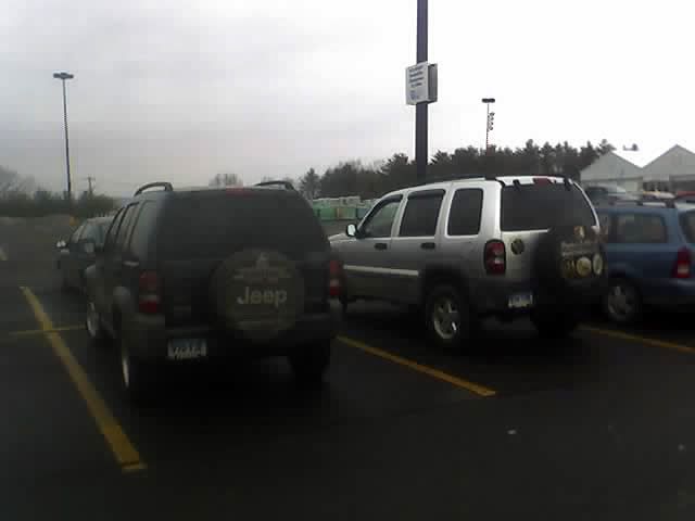

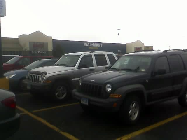

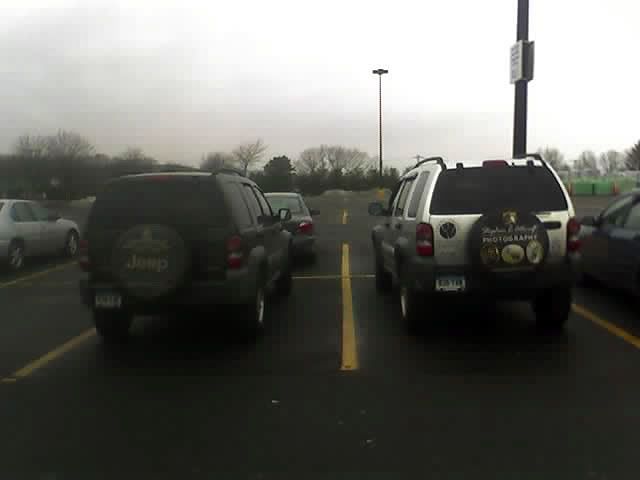

Ok here we go...
I was out running some errands today, I saw a CRD in the lot at Wal-Mart.. I did not have any camera gear with me.
However I parked mine next to the other and snapped these with my cellphone!!
They Suck.. LOL.. Of course I am used to my EOS-1ds!!!!!
Anyway mine is the Silver One..................... In case ya can not see the lift!!!
