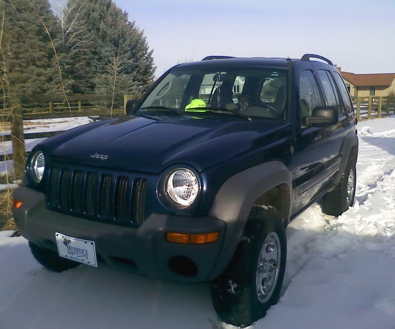

i think you would be fine im running 32s with a 21/2in lift everything else stock i get about 20 mpg on hight way going 70 here is a picImage

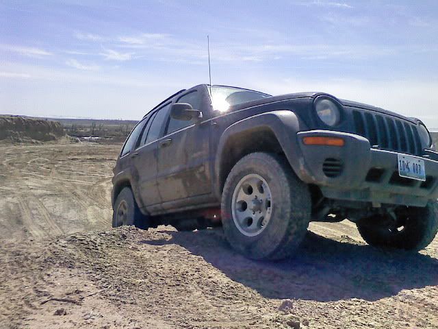

Imageheres another picture that might show you how the245/75 r16s are just fine lol :JEEPIN:
