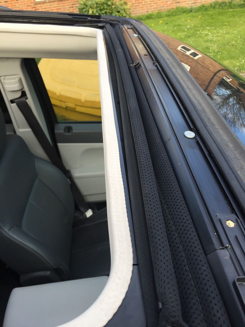

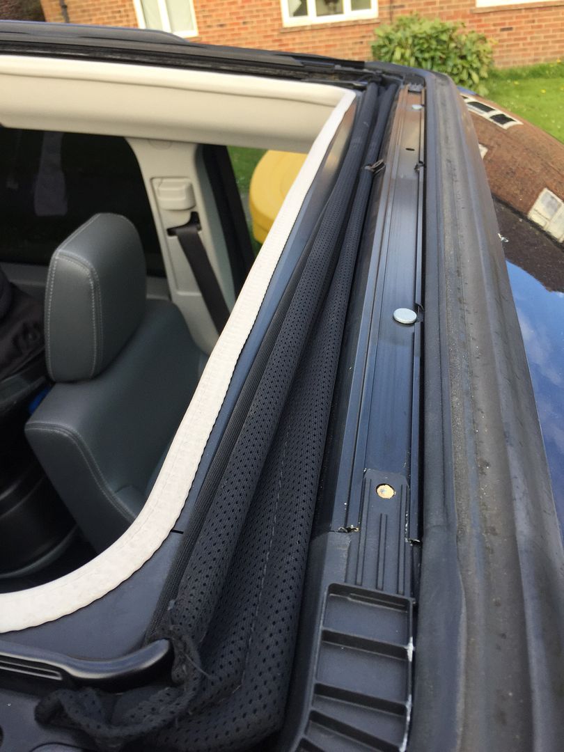

just purchased a 2009 liberty/Cherokee 2.8 limited.
I absolutely love the car ever since I saw it advertised. its done 69000 miles and hasn't a scratch on her
I have noticed on the skyslider that the mesh doesn't lift/spring up when the slider if open.
has anyone any idea why and how to fix it.
thank you and Hello from a new KK owner :D

So it is the wind deflector that is not raising. Sounds like the springs came loose. The SM does not talk about the springs specifically, but they are shown in one of the drawings.
Here is how to remove the deflector assembly.
At each corner there are 3 screws. 2 outside the deflector(toward the side), and one under the mesh in the corner. In Pic 3 you posted above, with it lifted, you can access the inside one with an offset screwdriver. There is also a center support screw you will need to remove.
Once the screws are out you can lift the front of the deflector assembly up and remove the deflector assembly from the rail. Note the placement of the deflector assembly tabs in relation to the rail (one on top, one below the rail)so you can get it back in correctly.
Once the deflector assembly is up you should be able to see the springs.
I do not have a slider so I can not be 100% on this... But the above is derived from the SM.

Took the wind deflector off yesterday, both springs either side weren't fitted, on trying to reconnect I noticed that the housing on one side of the spring but for both springs had broken, so the spring wouldn't hold, hoping that with a little bit of superclue/mitre mate it should fix the holder and the springs should work. I also fitted the weather strip which has made a huge difference and may also fit it into the roof lining internally to see if that helps at all.
