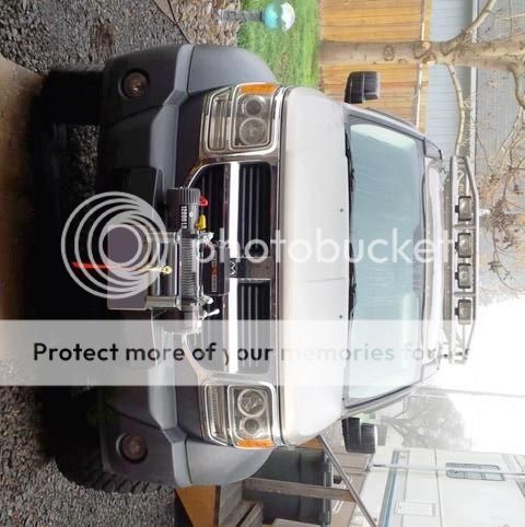

Got my winch plate completed and installed. Not a KK but at least it is a KK brother...
that looks awesome!

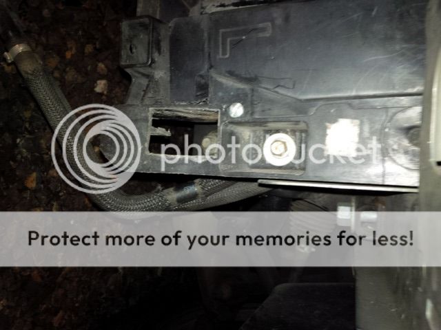

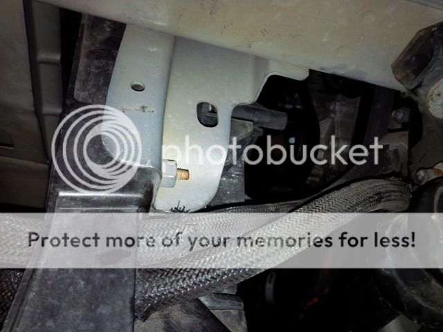

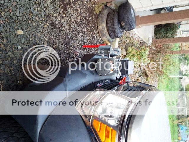

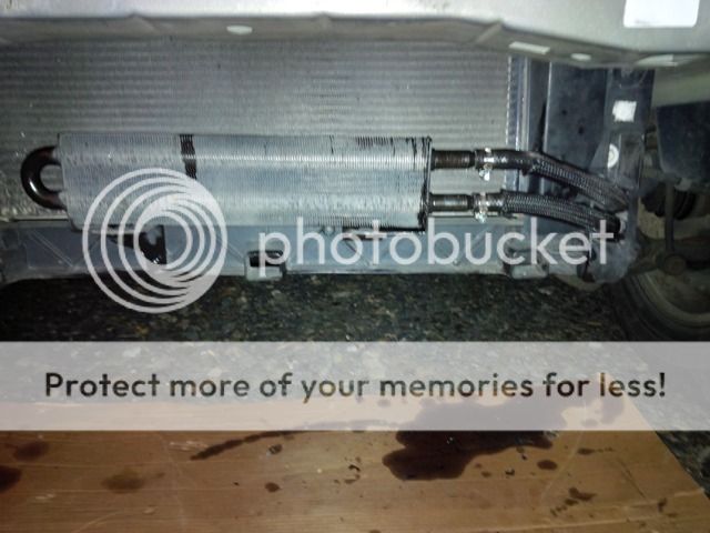

dcbelcher26 wrote:
that looks awesome!
Thank you. It was my own design (with a some input from ATH)
It is made from only 7 pieces of steel. The majority of it is one piece of 1/4" steel cut and bent to my specs.
Then there are 2 plate supports under the winch, a back, and 3 pieces of 3/16" to skin the front.
To accommodate the side plates I had to reroute the P/S cooler lines. I also had to shorten them each by 1.5" because they were too long.
New hole to route them through.
Spilt a little P/S fluid during the move but no leaks now.
A side view. It only sticks out a bit more then the OEM skin.

Scar0 wrote:
dcbelcher26 wrote:
that looks awesome!
Awesome build, I'm amazed at how well it all went back together. It looks like its meant to be there! If and when I do a winch mount I might be contacting you haha
Freakin sweet :BANANA: :pepper:

dcbelcher26 wrote:
Thanks, and thank you again for your assistance with my project.
Did a little high-lift jack test.
Both front wheels off the ground. The plate did not move. I think I'm good to go.
