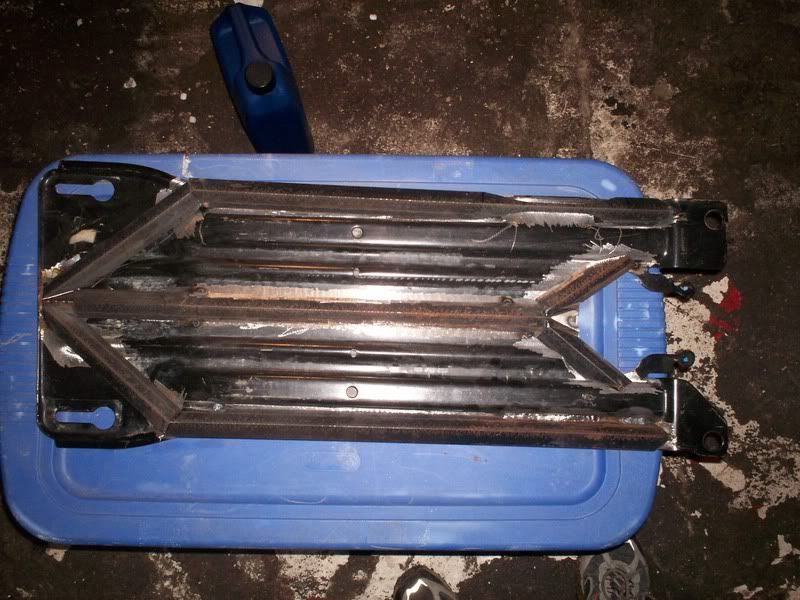

I've got most things tacked into place, just need to do a bit more grinding, and need more time as usual. I have been pretty tied up with a colt to take care of on top of everything else. Maybe I will try to stay a bit after work today and at least get the last few pieces trimmed up and everything tacked into place so I can show how it will look. Does anyone know if you can jack up a liberty by the stock tranny skid plate? I figured that would be a good test after its done.

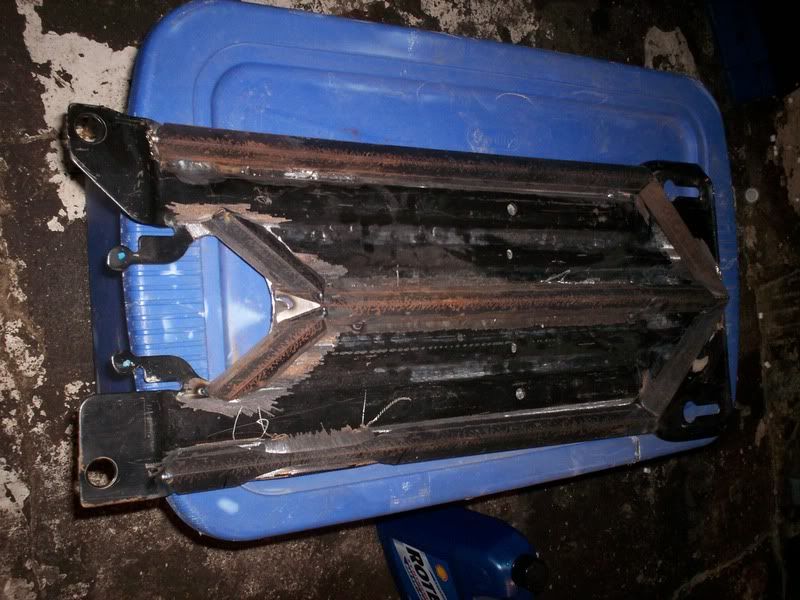

Everything is tacked down, need to do a little grinding (didnt V out a few weld areas) sand blast it then weld it up and paint it. Thinking about deep green or just black rustoleum hammered look
Went from 20 Lbs to about 28. Cost about 15 bucks in materials including weld wire. It probably would have took me 2hrs if I could have worked on it straight through, but with only 15 min here and there it takes a lot longer. I may beef up the front mounting points a bit, but (after welding) it is done for now. If I bend this I will just fab one up from scratch.

Looks like it should help out some if you come right down on it, good job

I lost a little less than 1/4" clearance with the angle. I used 1/4" X 1" angle. It is actually straddling the center rib and sitting beside the outer "box" type channels. I thought it was a fair compromise.
I dont know the whole story behind the pics of the bent plates at the beginning of the thread. They arent mine or tj's as far as I know, I just asked to see some bent ones and they delivered. I imagine you could bend one if you slipped off of a ledge and landed on a rock. Im sure the KJ can create a lot of force with an 8-10" drop. I really hope there arent too many people that are going off of "jumps" with their KJ :lol:
