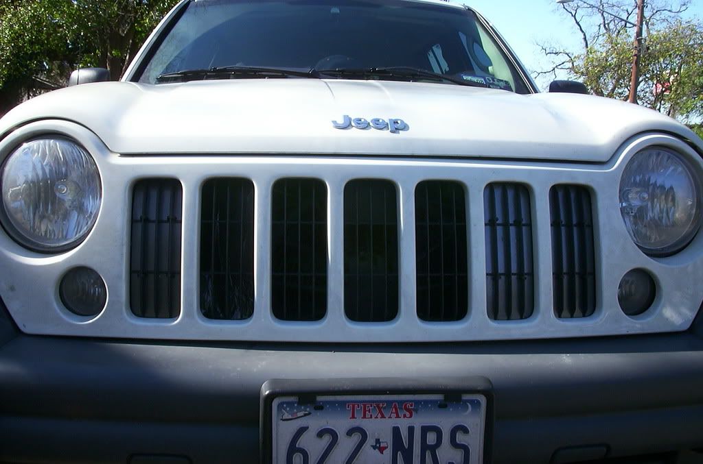

Here is my cheap fix. Found a very stiff kind of plexi-board near my dumpster. Cut out the shapes to fit behind each slot. Painted silver grey. Drilled holes for tiewraps to pass thru. In Texas I only needed to block 4 slots. Two on the driver side and two in the passenger side (one is an air scoop). Remove grill (no tools required) and install blockers.
They work great...brings CRD up to temp quickly...holds temp in the radiator during the day for easier warmup. CHEAP!
