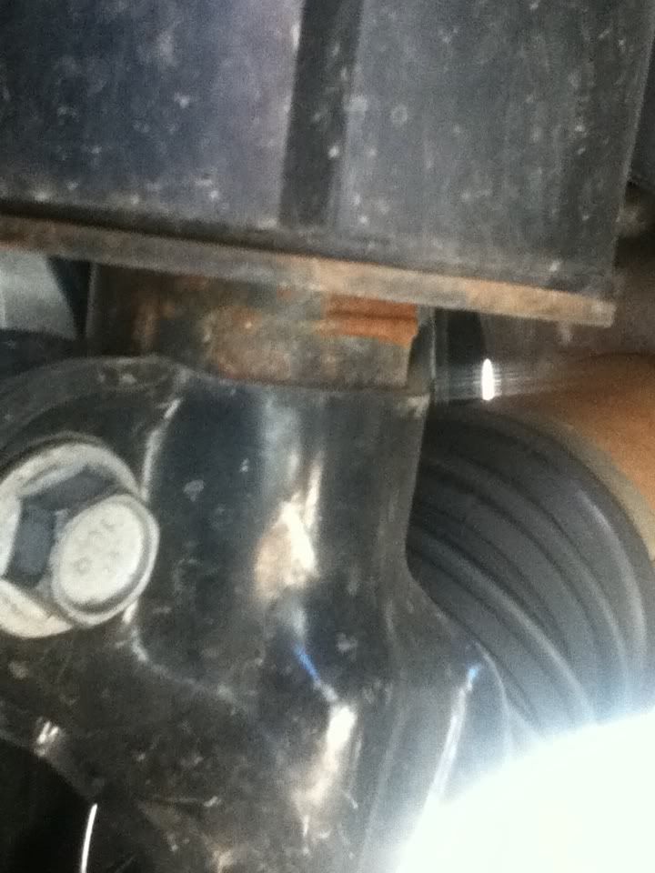

If you just want another 1/2" for the front, do a clevis lift. I can post a picture of what it looks like with a factory shock tomorrow. Rear you could add two more isolators on the top end. They are available at http://jeepinbyal.com/prod-Rear_coil_sp ... r-705.aspx or maybe the dealership can order them.

Btw where are the pics?

There is a 3/8" gap between the horizontal ridge and the top of the clevis fork.

did you just tighten the upper clevis bolt without engaging the shock assembly all the way?
is adding the 2" conduit nuts just an alternative, or am I confused as to what I am seeing in the picture?
Yep, pretty much. A prybar will come in handy.
The conduit nuts only work if have aftermarket shocks, because there is a vertical alignment ridge on the shock that they won't slide over. The clevis never slipped upwards on me or anything, i think the main reason for the nuts is so you don't have to measure out 3/8". Having four arms would have been helpful to do this without the nuts. :-)r
