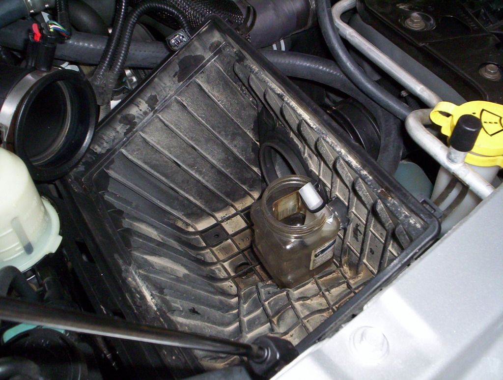

I did it this way at first too, I modded again and used a large pill bottle with some cotton in it, I'll post pictures in a few days. My air filter lasted 7000mi. with the first mod. :JEEPIN:

Just thought I'd add my version of the mod. I ran the hose around to the front so I didn't even have to pull the airbox. I decided to mount the vent sideways so that the oil would drain, and I used an old plactic container to catch the oil. I figure with any luck I'll just pull the container and drain it at every oil change.
I had to drill the hole in the airbox big enough to barely slip the hose through. That way I was able to hook it to the vent and then pull it back so the hose was tight in the hole.

There are probably 100 ways to accomplish this, but you can be the test pilot with that one and let us know! :D
I can tell you I've put about 4k miles on mine now with my set up and the air filter looks fine. The breather element is working as intended because I just checked yesterday and I've got about a half inch of oil in the bottom of the catch can. I can't imagine any oil vapor getting through the air filter and damaging the maf sensor.

I've been into modded Hondas for about 14 years now and we normally use catch cans with turbos, works well, alot just vent it using alittle vent but MTO love to see that as its about a 300$ ticket.
I do like the venting to the air box, but it looks like some oil puddles in that picture.
A catch can will hold the build up and you can drain it once a year, still vented but just the fumes are vented.
