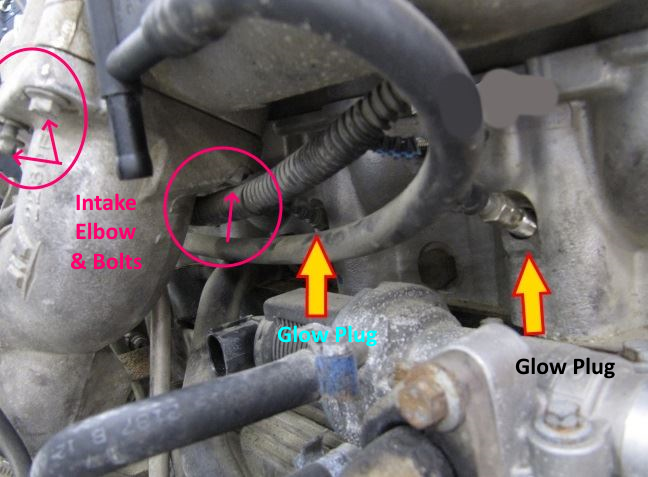

You talking about the ones that hold the FCV to the intake manifold?
There are 4 of them and best to get to the 2 rear ones from below with a long extension. see picture.
Takes a 10mm socket best I remember.
or
Are you pulling the intake/valve cover?
Your picture really does not show.... :?

the fcv to the intake manifold.

sorry about the picture... and the 5/16 bolts are what I'm talking about. getting the back side was a pain.
or
so i got 2 of 4 glow plugs. whoever last replaced the glow plugs overtighted everything, even the plugs... #1 was hard to fully thread without a bit of force... concerning but it is fully threaded now and didn't look like it pulled any threads as i took it back out to see why it was so hard to get in there... I was attempting #3 and couldn't get it to budge. got the intake inlet pulled out enough to get to it. the bracket on the bottom of the inlet that attaches to a hose is so tight and in such an awkward position i can't get it to move at all... i'll try again tomorrow. i'm worried about how the threads look at this point. it was a dealership that did it also. he must have used an impact on almost everything (the alternator bracket was pretty much finger tight though) what a Richard. trying not to cuss but i really don't think the guy that did it knew what he was doing or was having a bad day. feel like calling that dealership and telling them that tech can fix his... screw ups... meh, i don't want that donkey touching it again... i'm pretty annoyed right now.
just in case anyone asks: i'm not doing this for fun. i have a bad #2 glow plug and the ones i purchased are a different brand than bosch... so i would feel better to replace all of them at once to not run into troubles later on. the plugs in there now are almost 10 years old so i just want to do them all now and save a headache later, especially with winter coming up soon.
the elbow bolts are 5/16". metric sizes didn't work... 8mm was too big and 7 mm didn't quite fit either...

Glow plug tip - PB Blaster for days and days ahead of time if possible.
Pretty normal dealer wrench experience, where these are concerned.
Changing the glow plugs is cheap compared to risking any of the ceramic stock ones in place. They work well up until the ceramic tip breaks off in the cylinder. If you live where you have sub-freezing temps in the winter, you will get better performance with a modified GDE tune and 7v plugs, or 5V plugs in either brand. (they work with either 5v or 7v programming)
WWDiesel is correct, if your hardware holding the FCV to the intake is anything other than 10MM, it's been changed, (probably stripped) and good to make a note of in case of future need to pull apart again.

all of the smaller bolts so far are 5/16". at some point I'll try changing all the intake stuff over and deleting the egr. but tomorrow I need to just focus on getting the rest of the glow plugs replaced, getting the oil changed and getting it back together for Monday.
replacing the glow plugs from Bosch to ozkam brand European made plugs. they look identical to the Bosch ones and were way cheaper than oem. I don't have much money right now so couldn't afford to get Bosch or etronic or whatever they're called. like I said these appear to be very high quality so if they work I'll let you guys know. they were about 25% of the price of the other brands and have stellar reviews in Europe.
that sooty oil does not come off your hands very well. I've washed my hands like 7 times and they're still stained lol

so, I did not win. I did not have time to replace the last two glow plugs. now I'm getting a code for #3. I'm sure it's because the new ones have a different resistance than the old Bosch ones. it didn't come up that day, but did pop up today after starting it. dammit.
so, I guess I'll be pulling the elbow back off Saturday to try to get the #3 plug. I think I can get #4 without removing the fuel filter.
will soaking it in pb blaster for a couple hours help? I'm thinking of getting it to operating temp then trying to remove it.
also, anyone have a hard time getting the socket to seat on #3? there seems to be a ridge on the intake manifold on the left side of the plug that obstructs the socket from going all the way down onto it. that's why I gave up and put it back together. I needed it running to get to work today.
